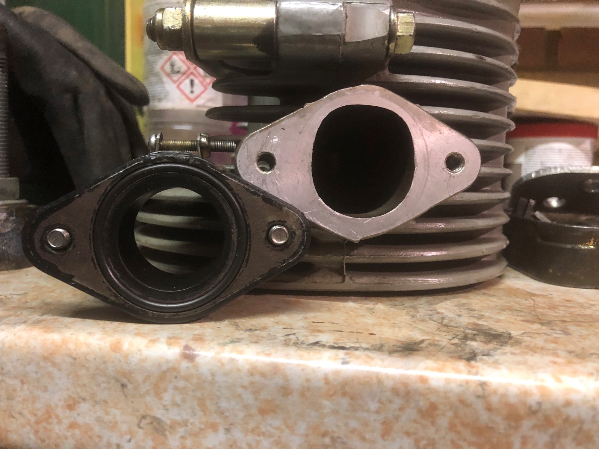

Just looking at the inlet port while I have the head off and must admit does look strange, or is it me?
The UCAL CV carb has a 29mm bore (well 28.8), the manifold comes up at 30mm but the port in the head is 35mm high and 32.6mm wide and as you can see is not round, does that look right?
I guess it is not restricting anything and must be part of the lean burn design but just looks like it is asking for opening to suit a round 35/36mm manifold/carb!
It has not been ported as you can clearly see the casting marks along the inlet track.

That is normal on those heads, which are good for 100 mph plus, as they come. That said, it is easy to make the entrance more round and there is room for a little improvement in the ports, should you wish.

Thankyou, I was just curious about the shape, the AVL designers must have had a cunning plan!
#97093
That always puzzled me too. Why a big oval port with a fairly mediocre 29mm carb on it? You CAN get carbs with oval venturi, I think Dell'Orto make some.
As my learned friend points out, these heads have a lot of potential which the standard exhaust, carb and cams do their very best to hide, with a lot of success unfortunately. And that's with the exhaust port usually being very badly finished, a pound to a penny says the exhaust on yours is woefully undersized for a 500 single , with the finish as rough as a badger's *rs*, as it were.
Just to give you an idea of the inlet port size, here's the tufnol spacer from an Amal 1½GP carb on an unmodified head.
Just needs a little bit of work...
and those clever Italians make a carb manifold that lets you bolt a VM38Mikuni (or 388Mk2 Amal if you can find one) straight on.
Dell'Orto is an option, but - for fans of extreme silliness - so is this, with a bit more work.
