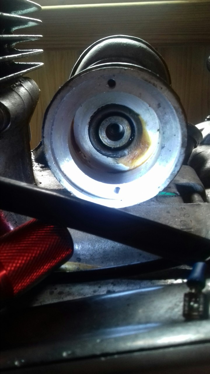

Okay, i've read som,ewhere that 'some dribble 'is norma l(is it??) but..
Ehm, is it possible to change it from the outside/whithout disassembling the whole unit?
This is a pic i just took.
Can it be orginal from factoy opr has someone tried to 'fix it' India-style?

I've not done this particular job (my Bullet doesn't have a distributor) but I reckon you could drill a couple of small diameter holes in the seal, screw in self tapping screws and use those to pull the seal out with "Mole"grips, or similar.
#97044
A worn seal usually come with a worn bearing. I had this on my Lightning. I took the easy route and bought a new distributor from our Hosts. Then I stripped out the old unit. The bearings were completely shot! No wonder the timing was so erratic. I now have a re-furbed distributor in the spares box.
Changing the distributor isn't that hard. You will need a hammer though.
