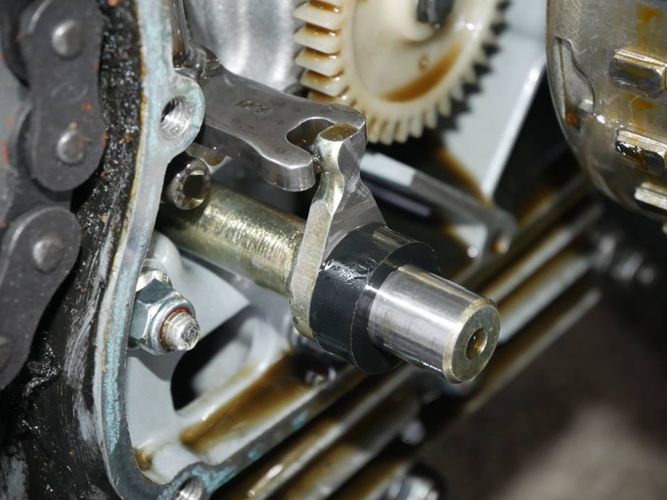

I have had this problem on both my Bullets - a 2015 and a 2018 Classic. I have found that keeping my foot on the gear change lever until after I let the clutch out helps a lot to resolve this. None of the other changes I tried made any difference.
By Chris H.
#96811
Remove the gear shifter and cover and fit a washer (e.g. O ring) to take up the slack/play to fully engage the selector fork.
This mod stopped my bike from going into a false neutral rather than second gear.
[img]D:\Pictures\Motorcycles[/img]
Selector Issue.jpg (106.54 KiB) Viewed 3014 times
