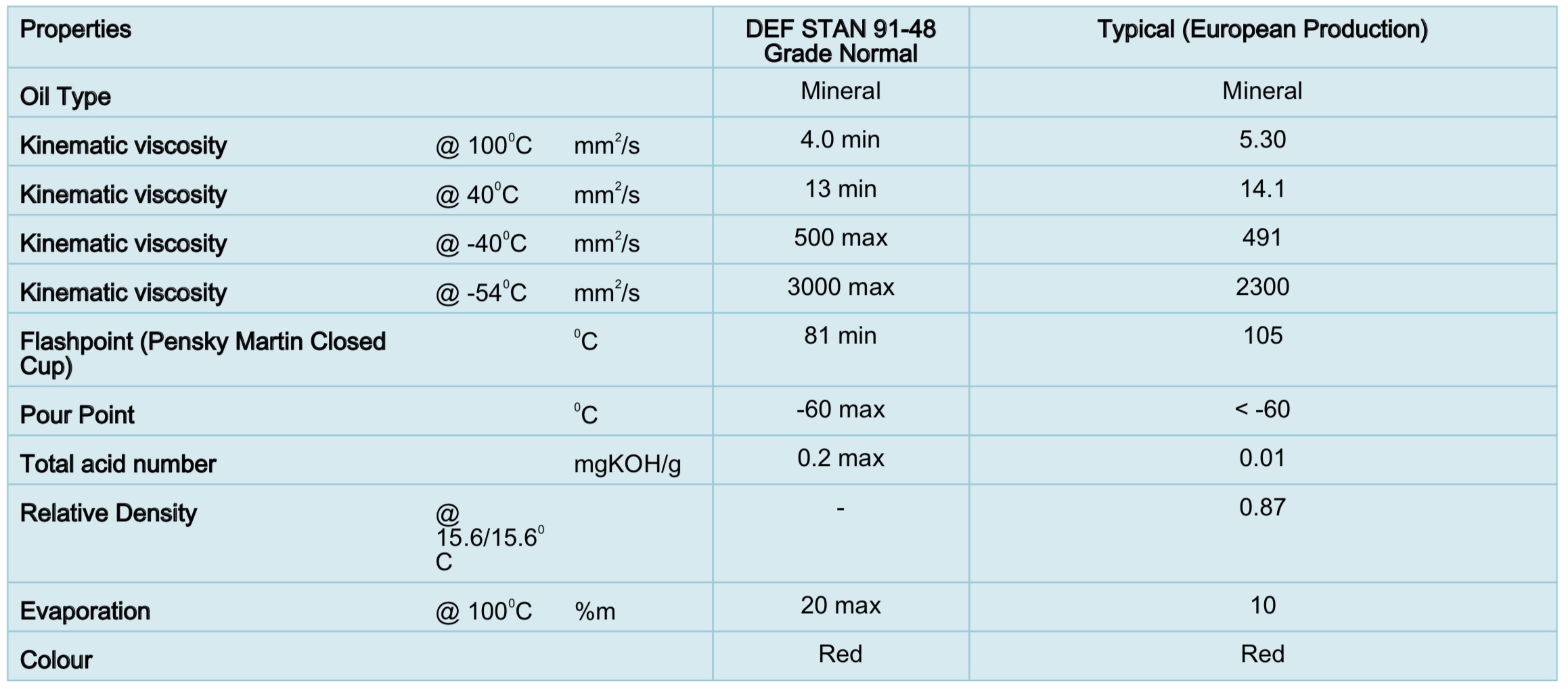

I'm going to run with the Aeroshell-4. Read their tech spec and quite interesting what the viscosity is at different temperatures.
Looks like leaking shouldn't be an issue and it will be fine re temp.

I don’t normally look at stats in this depth, but the viscosity figures at different temp decided it for me.

ATF is typically around 35 cSt at 40 C and 7.0 - 7.5 cSt at 100 C so Aeroshell 4 is about half as light at 40 C. I assume that the operating temp won't be much higher then this. The Aeroshell will work fine as it is a hydraulic oil but you may find the forks a little more springy.
