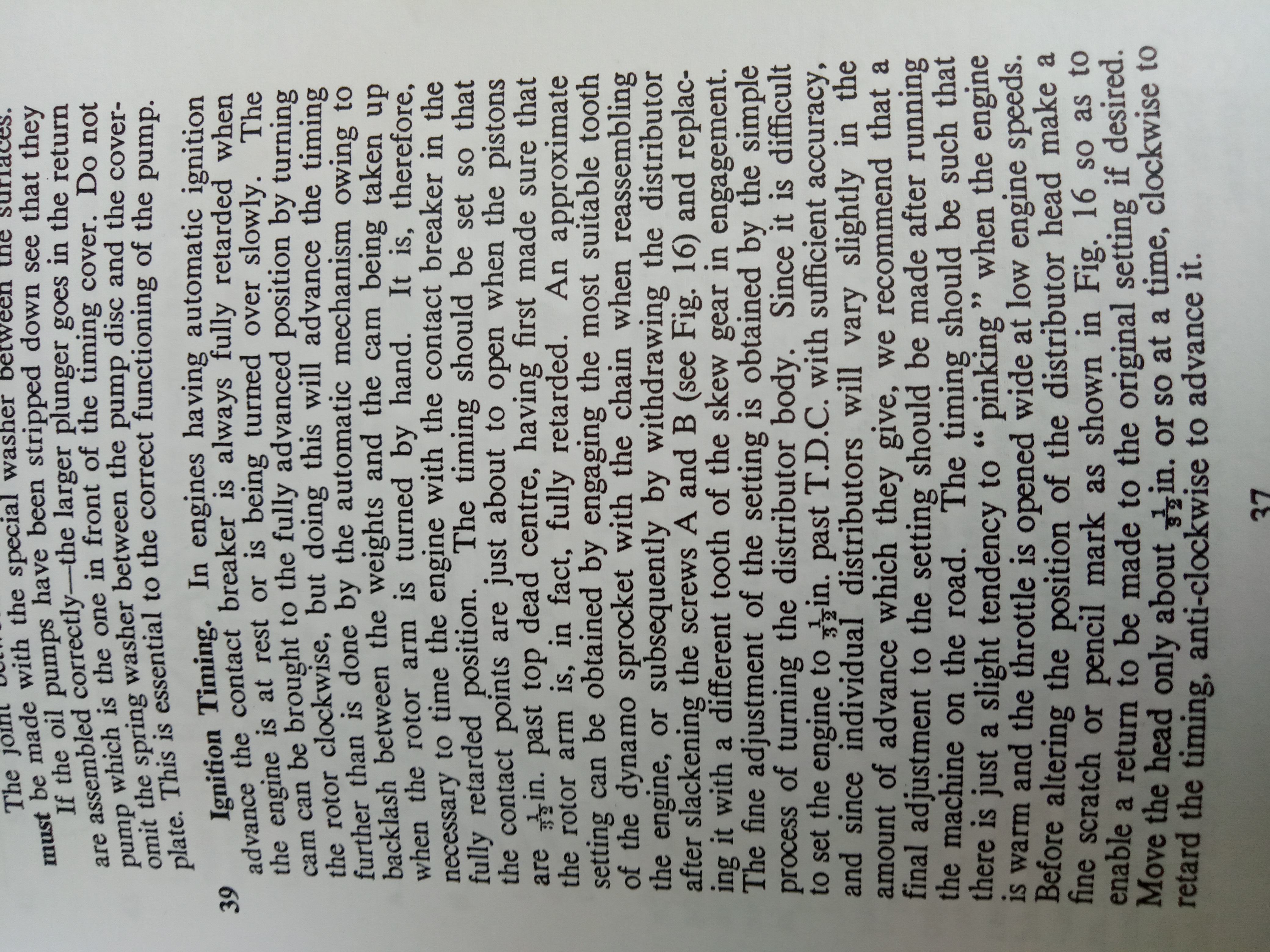

Hi guys
I've recently had the bike rebored out to +. 040" Which has cured my previous oil burning problem.
I've upped the CR to 8.5:1 from the original 6.5:1.. Fitted forged pistons..
I didn't disturb the timing which was set at standard ¹/32“ ATDC...(or thereabouts)
Bike seems a little harder to start than it was.. Should I alter the timing to suit the new CR to assist starting? ..
REgards
Tom

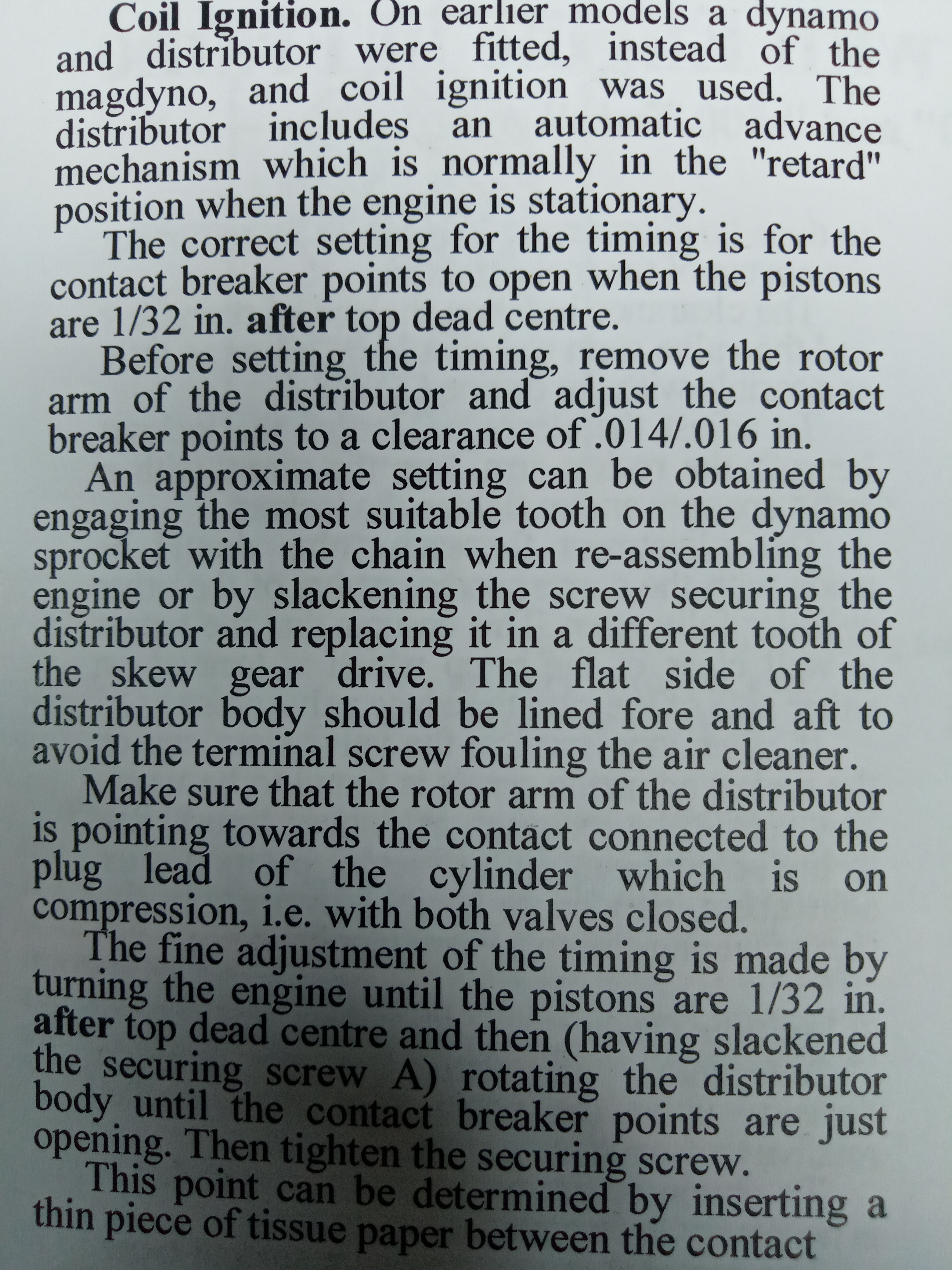

By Tomshayes1
#96665
RASP.. The timing is set correctly for the 53 Meteor fitted with LUCAS DX2 Distributor.. That is 1/32 After TDC.. As per the manual.. The only thing that is now not standard for 53 Meteor is the increased CR...
The distributor has been completely refurbished by Distributor Doctor..
Magneto engines are set ⅜-7/16 BTDC
By Tomshayes1
#96669
Hi Paul
The settings come from RE Maintenance Manual and Instruction book..
Bike was starting and running fine on this setting when 6.5:1..
I will try advancing up a bit.

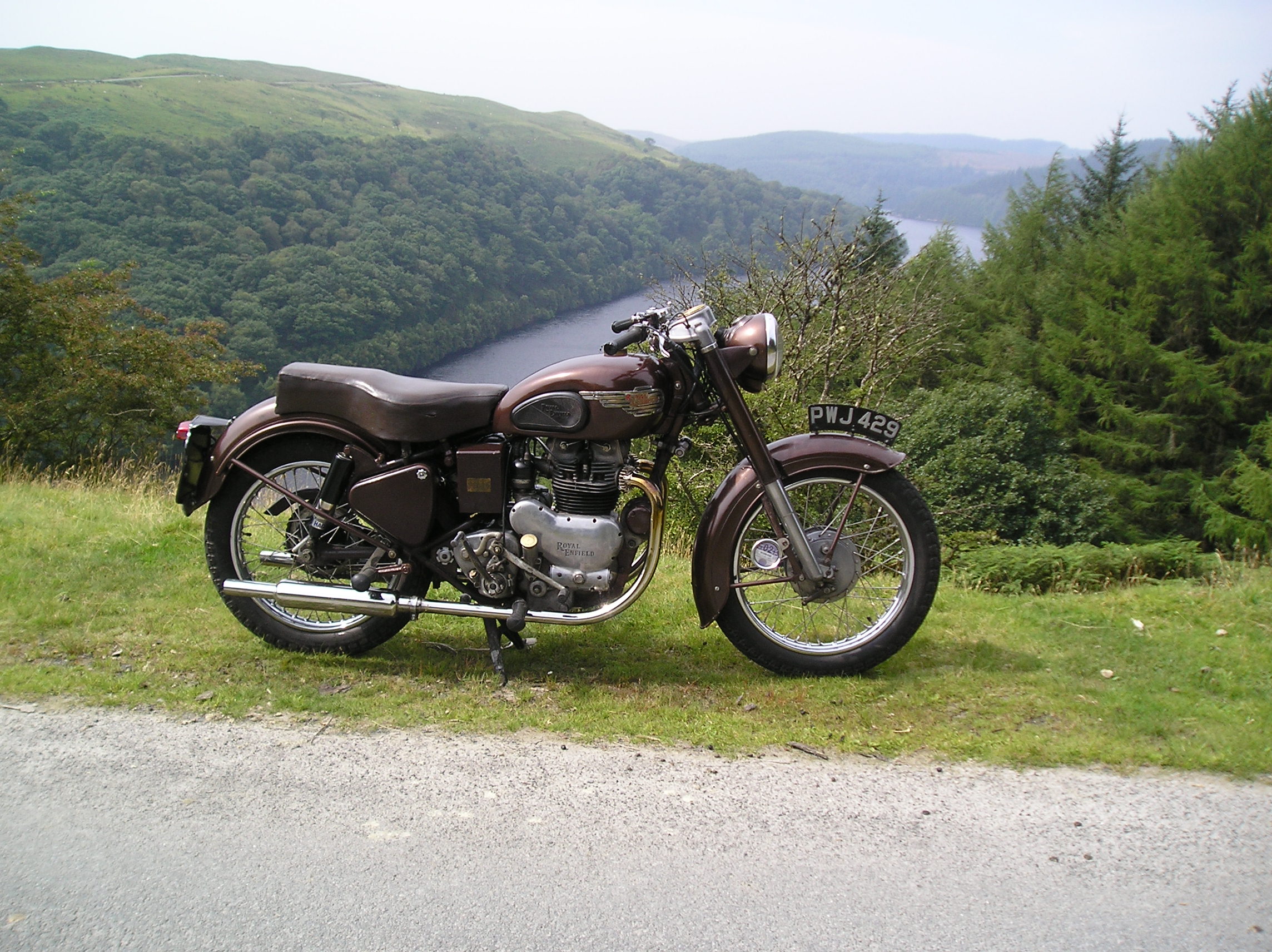

By Bullet Whisperer
#96675
Hi Tom, it must be a misprint. I totally rebuilt one just the same a few years ago and it ran very well afterwards, honest!
R.E. 700 twin P+T 058.jpg (825.21 KiB) Viewed 3239 times
By Tomshayes1
#96704
Hi Paul..
So what did you set static timing at?.....
The same info is in both manuals...
I advanced timing up once running and warmed up until tick over picked up and adjusted carb to give a nice tick over.... Started first kick this morning (very slight kickback)
Tom
By Bullet Whisperer
#96707
Hi Tom, I would have timed it as per the 350 Bullet singles - it is basically a pair of those, after all. 1/32" After TDC aroused my suspicions straight away, 1/32" Before TDC would be much more like it for a retarded setting, so you might have ended up 1/16" retarded overall, following those specs. Don't believe everything you read, as they say! Regards, Paul.
