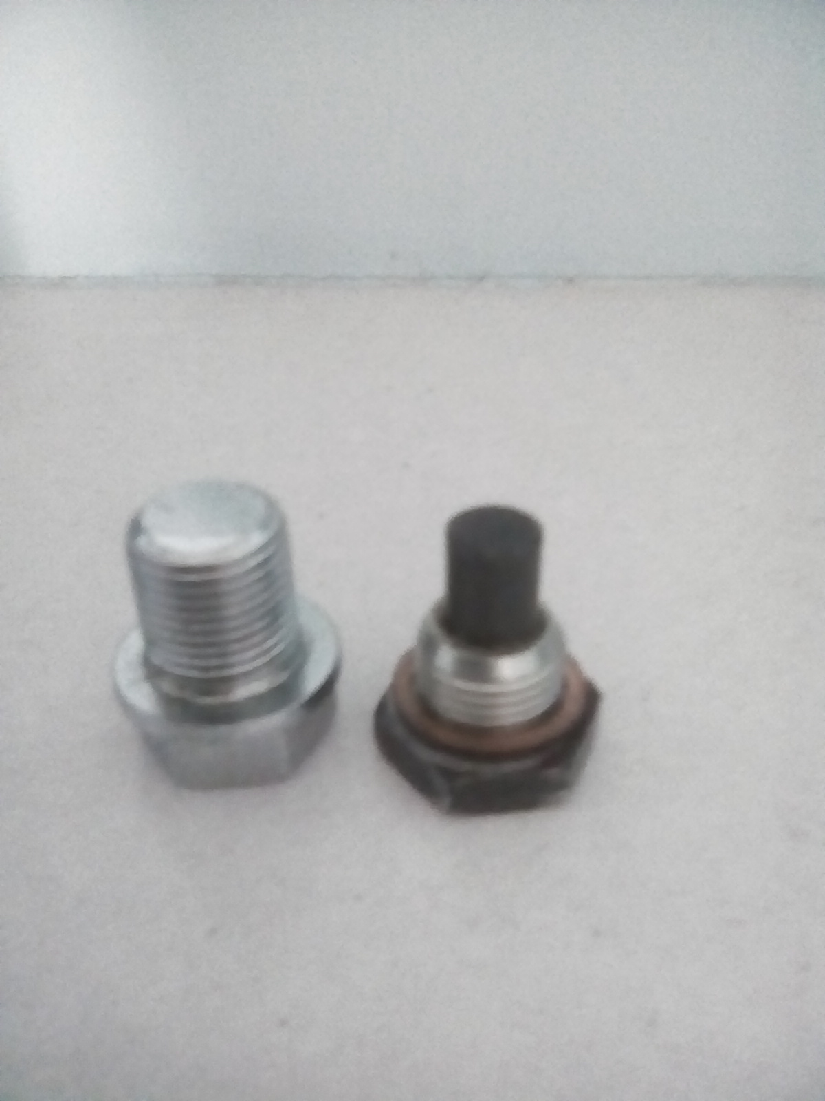

Update. I solved the problem by running a 14mm x1.25 tap up the hole.There is a lot more meat up their as the standard sump plug only has about 4 threads.(not enough in my opinion).I ordered a longer threaded magnetic plug 14mmx1.25 and jobs a good un.
Sump plug.

#96479
Hi Jamesy. Can I ask where you found the drain plug with the extra threads and internal magnet..that seems a far better part than the original and the extra threads should stop it stripping with future oil changes.

If you google and search 14 x1.25 mm magnetic sump plug you will see various well known seller web sites who sell them.The one I fitted was advertised for use on other motorcycle manufacturers.
