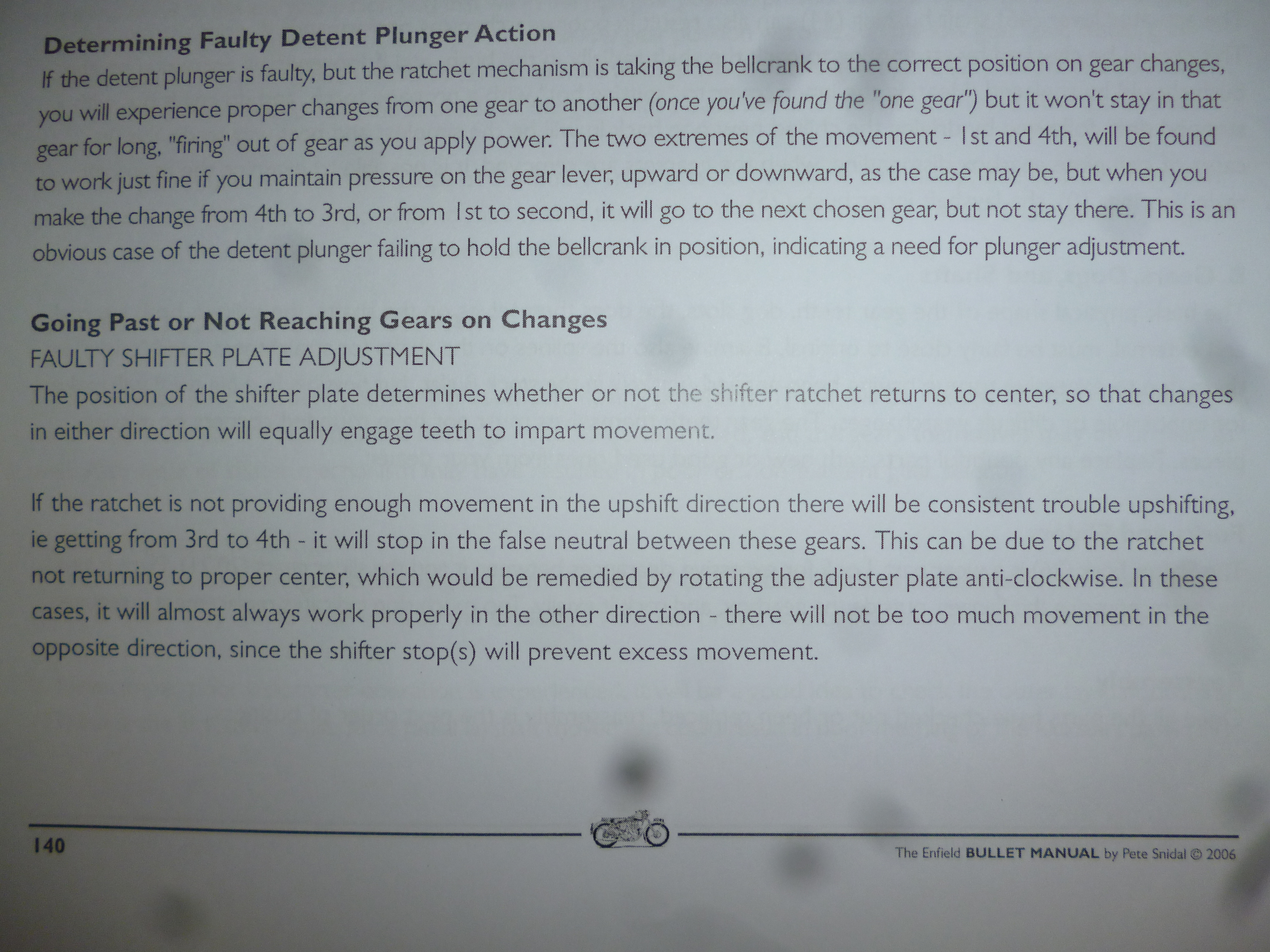

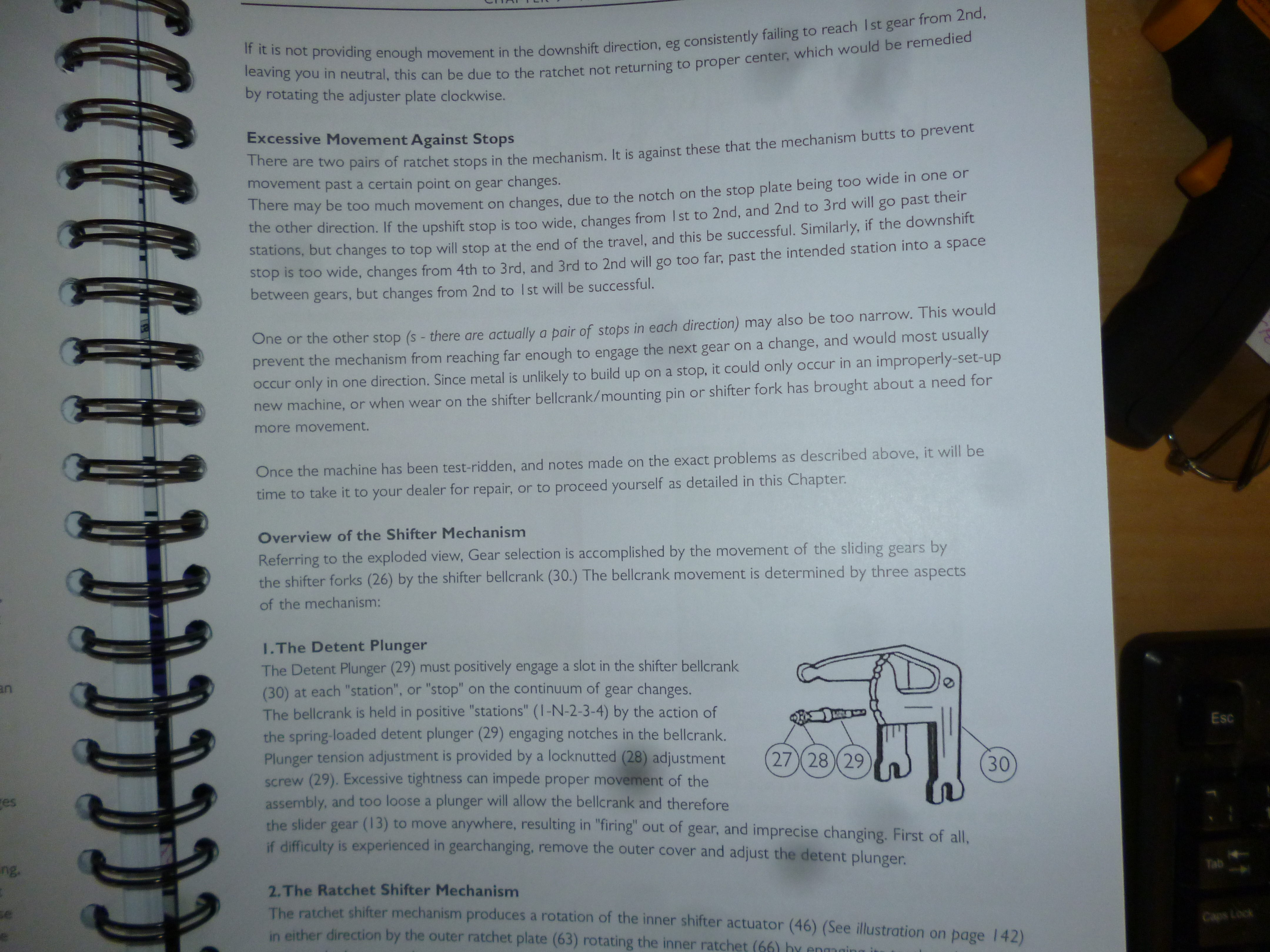

I also wonder if these comments from the Pete Snidal Manual will help?
I find this book extremely useful.
Good luck, Chris
