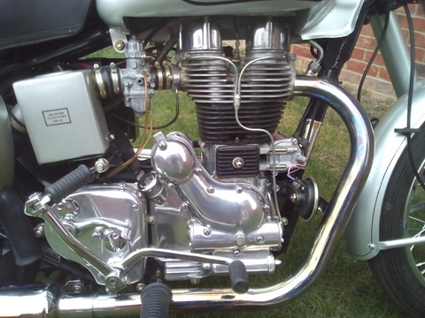

By Kally
#95922
Hello Adrian, its a 2003 model so the kit should fit, will give a try, it should keep most of the oil in the engine lol :D
