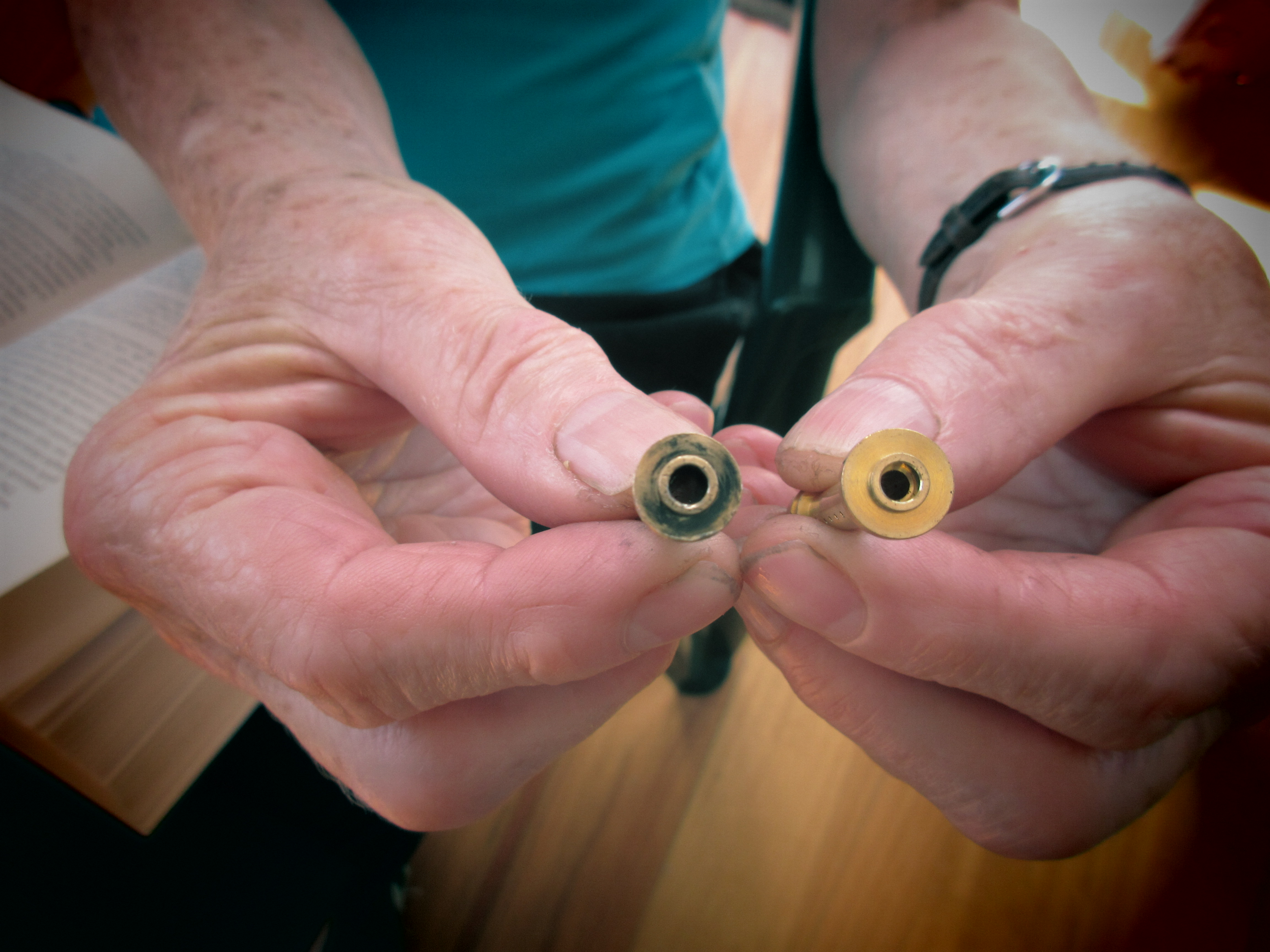

By Clement
#96471
It took me a while to get on top of this; my money was on the electrics (ignition coil) but it turned out to be the carb after all: a worn needle jet; surprising as the carb was supposedly new and had only done 8,000 km. See attached pic - worn jet at left and new one at right. Note difference in circumference.
Clement
