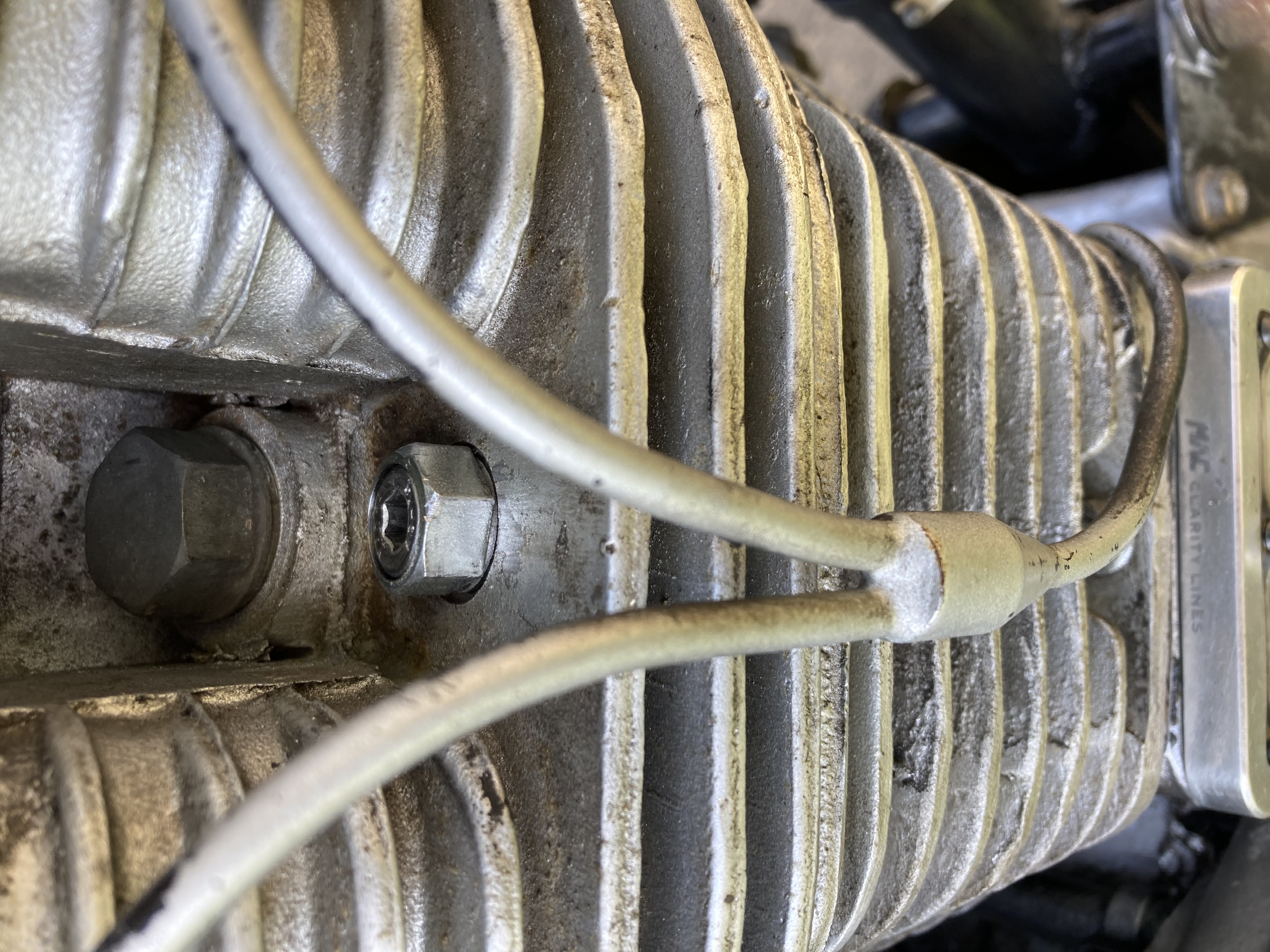

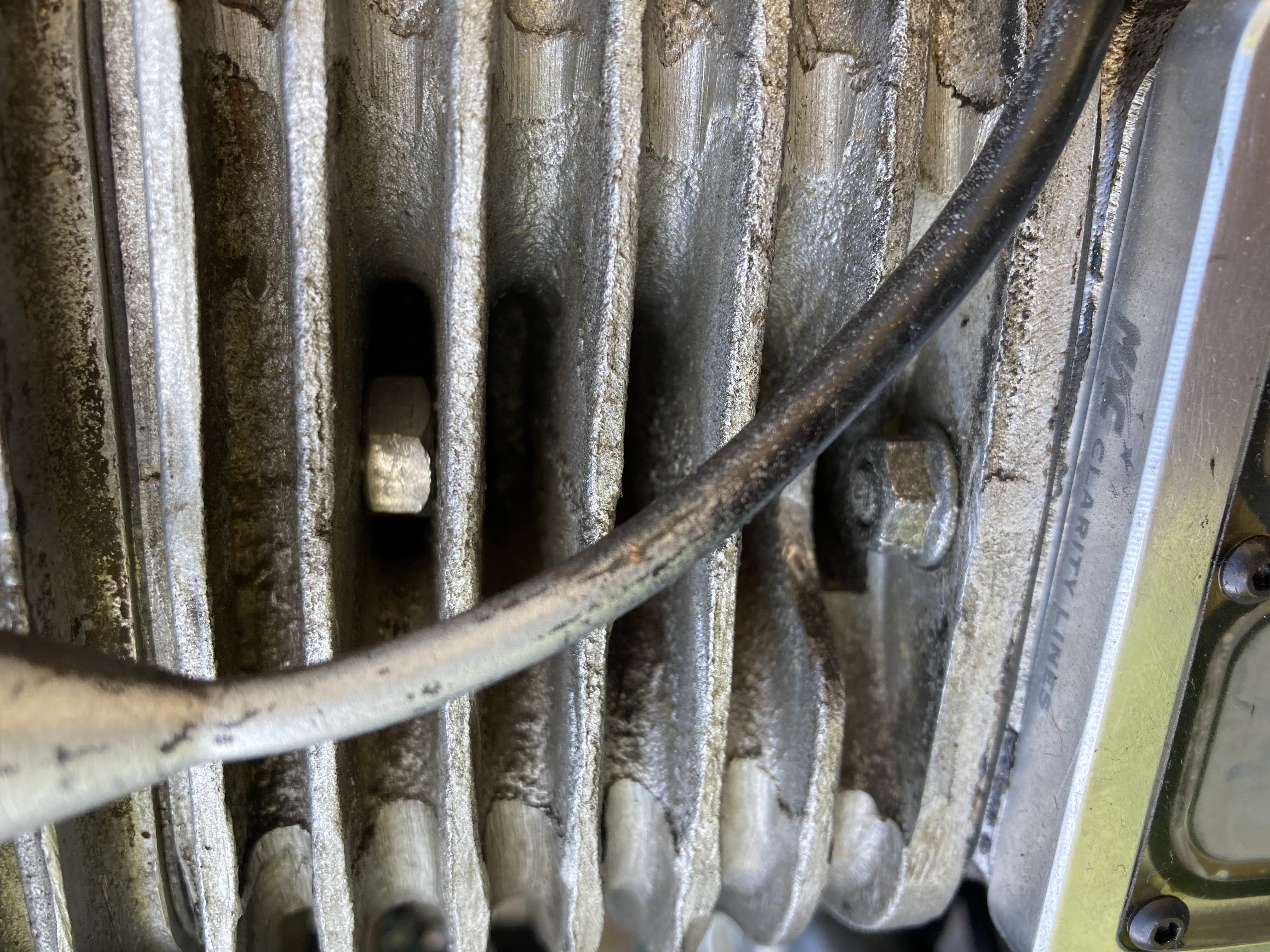

Perfectionists, look away now. The right hand cylinder head fixing bolt in the barrel has turned since I got him. The PO had helicoiled but it had pulled out.
A few months back I removed that helicoil and I used a longer one. I’m sure you know that the right hand bolt just goes through the fins and the hole protudes at the bottom.
My helicoil didn’t take, so had a hole approx 10mm. With the exception of taking the barrel to an engineers, having the hole filled and re-tapped, I fitted a longer 8mm bolt though and fitted a nut at the bottom. I only had Allen head bolts of the required length, so the sad part of me drilled out a hex nut to fit over the top. Just for effect. Yes I. Know, Barney Bodgit, but hey....
