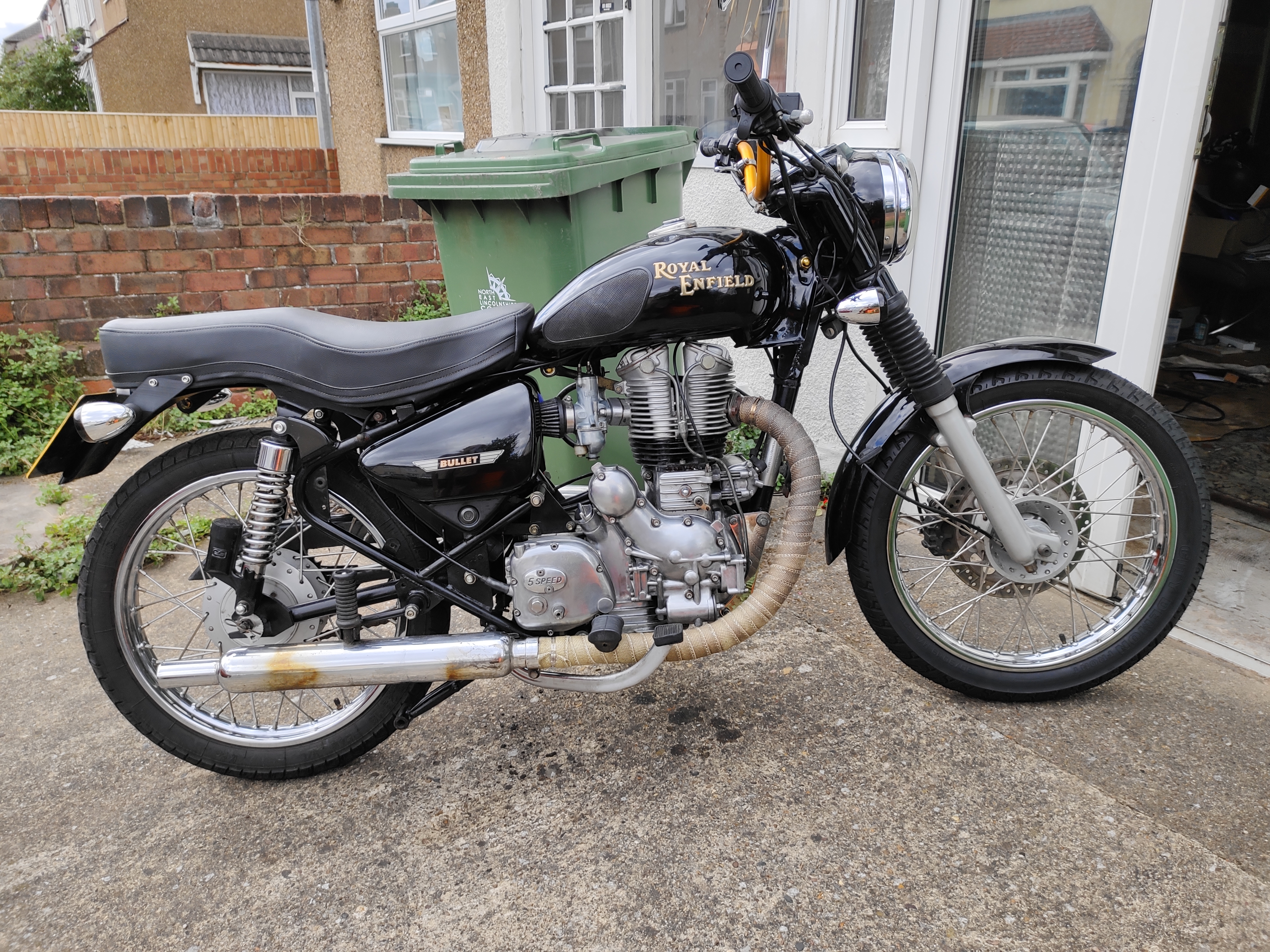

So, yes - I am engineering. Silencer is underway. Gear lever is underway. Awaiting the titanium for the handlebar clamp. I've already contacted a firm for the mudguard stay (come fork brace).

#92382
That bloody lagging on the exhaust pipe weighs more than the difference between steel and alloy mudguard stays and will help your exhaust valve run hotter than needs be. Engineering? Junk the wrap for starters.
