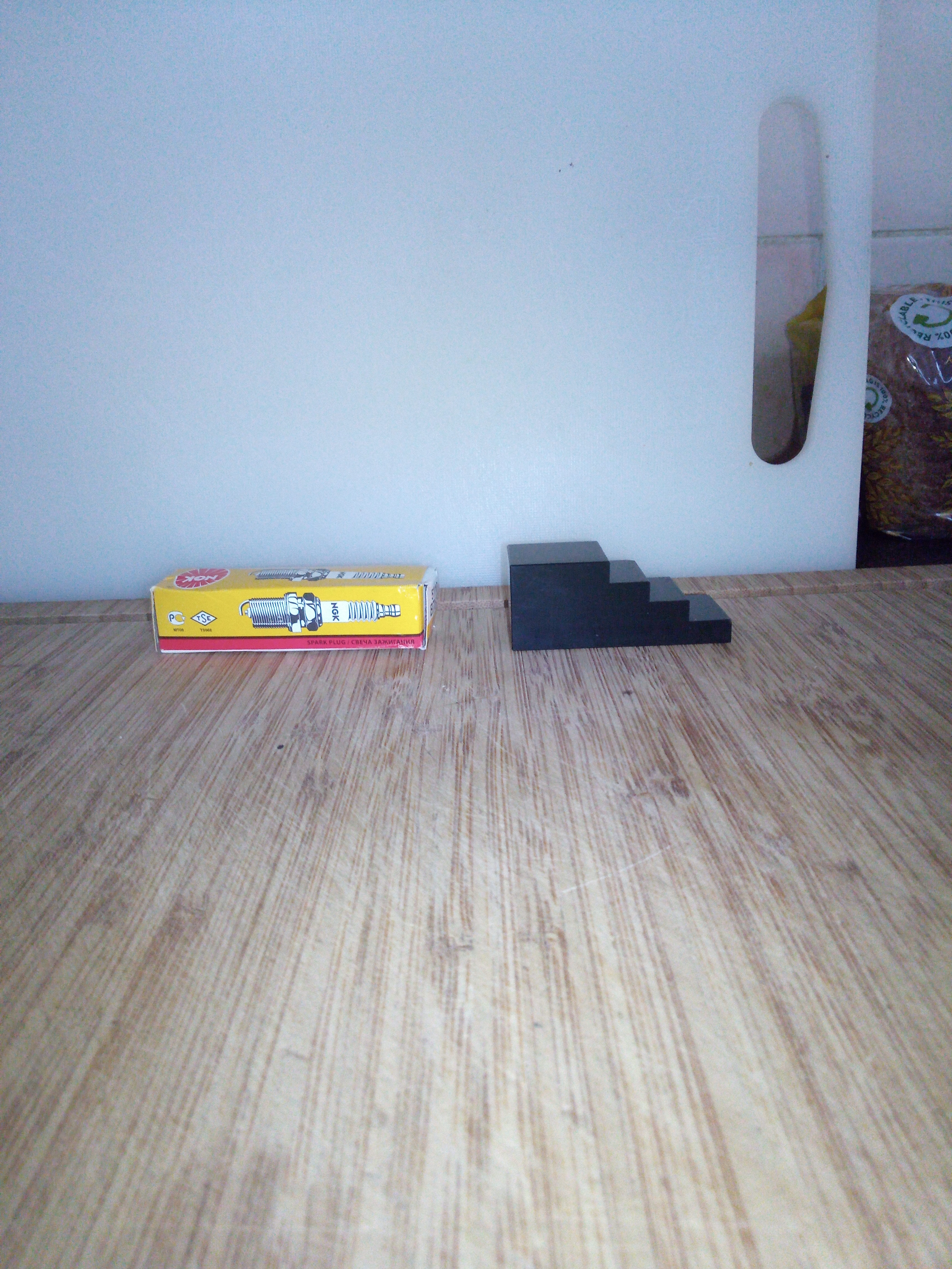

#101785
Just found Harley tool here's a pic to give you a idea of size
Listed as Harley Davidson primary locking tool on e#ay
#101786
