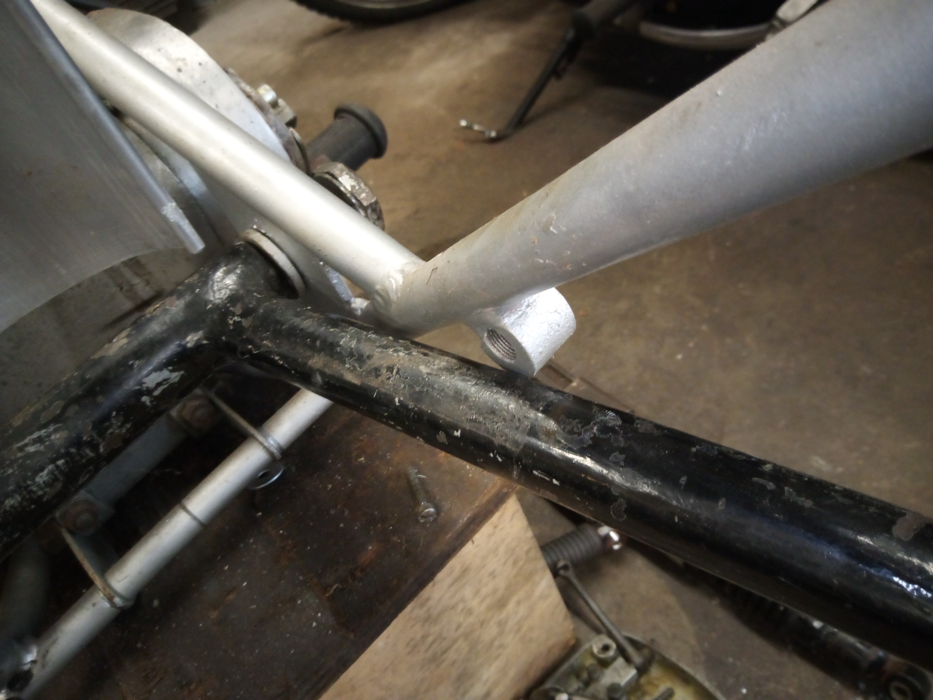

just wanted to clarify my previous post, just in case someone tried this based on my info. the swingarm will fit but the passenger footrest lugs will need trimming /removing. great post SW!
