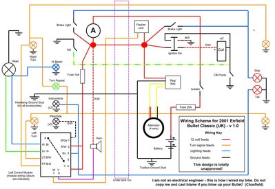

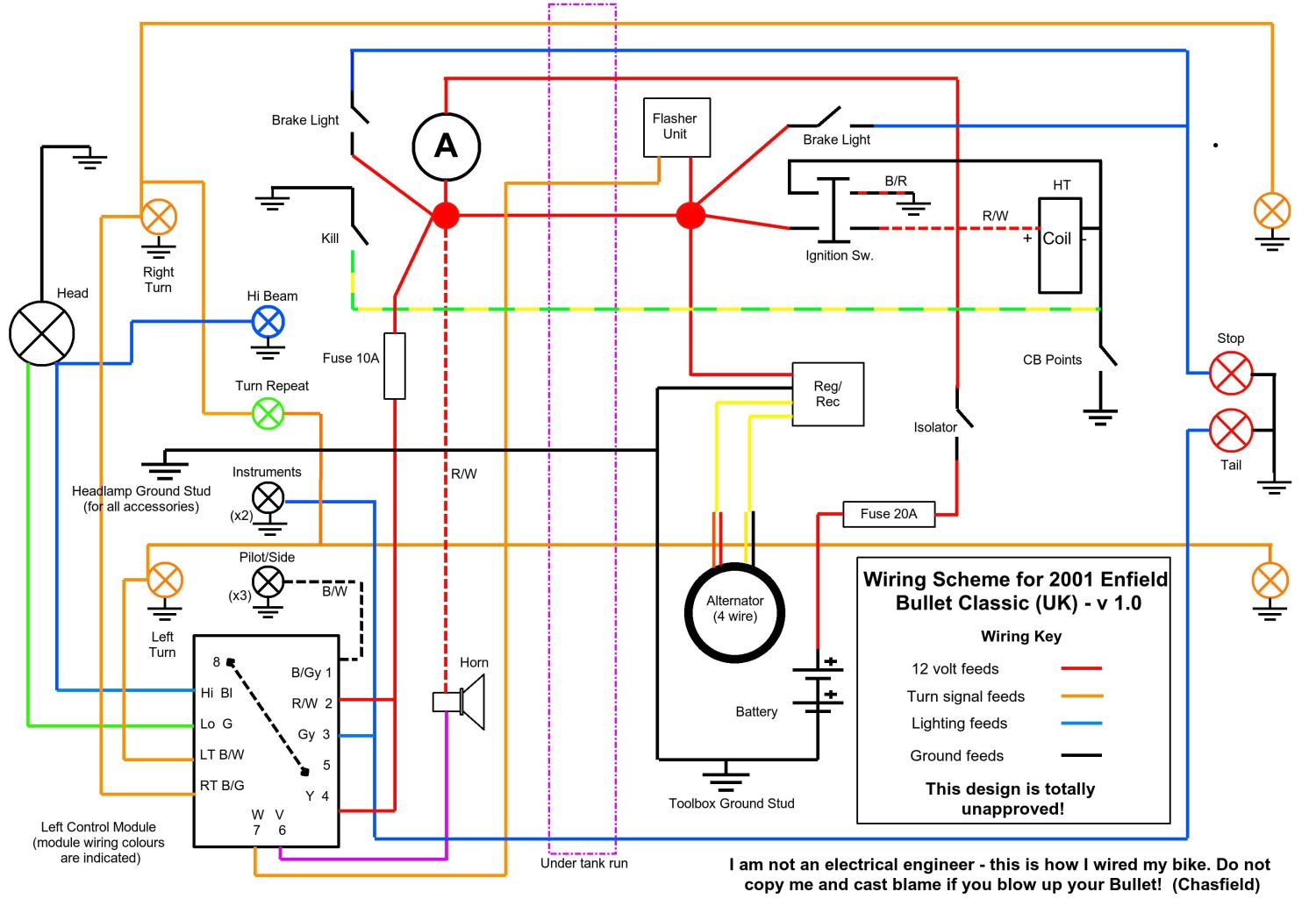

A common upgrade, as explained in the Pete Snidal Bullet manual.
I found this diagram on the US RE forum, it might help! The gentleman who put this together has the amber(orange) wire joined to the red and the yellow wire joined to the black, the same as you are suggesting.
If for any reason that doesn't work, just try a new two-wire Lucas stator, which should fit right on. The Indian alternators are basically Lucas copies.

Yeah, I didn't come across those colour combos in any of my research.
For what its worth... on my Indian import Bullet 500, I followed a version of the wiring above (I've got a battery-less boyer system) and although I haven't fired it yet, I turned it over with the plug on the head and got a nice fat spark. So for that model, and any that have the same style alternator, that set up does work.
