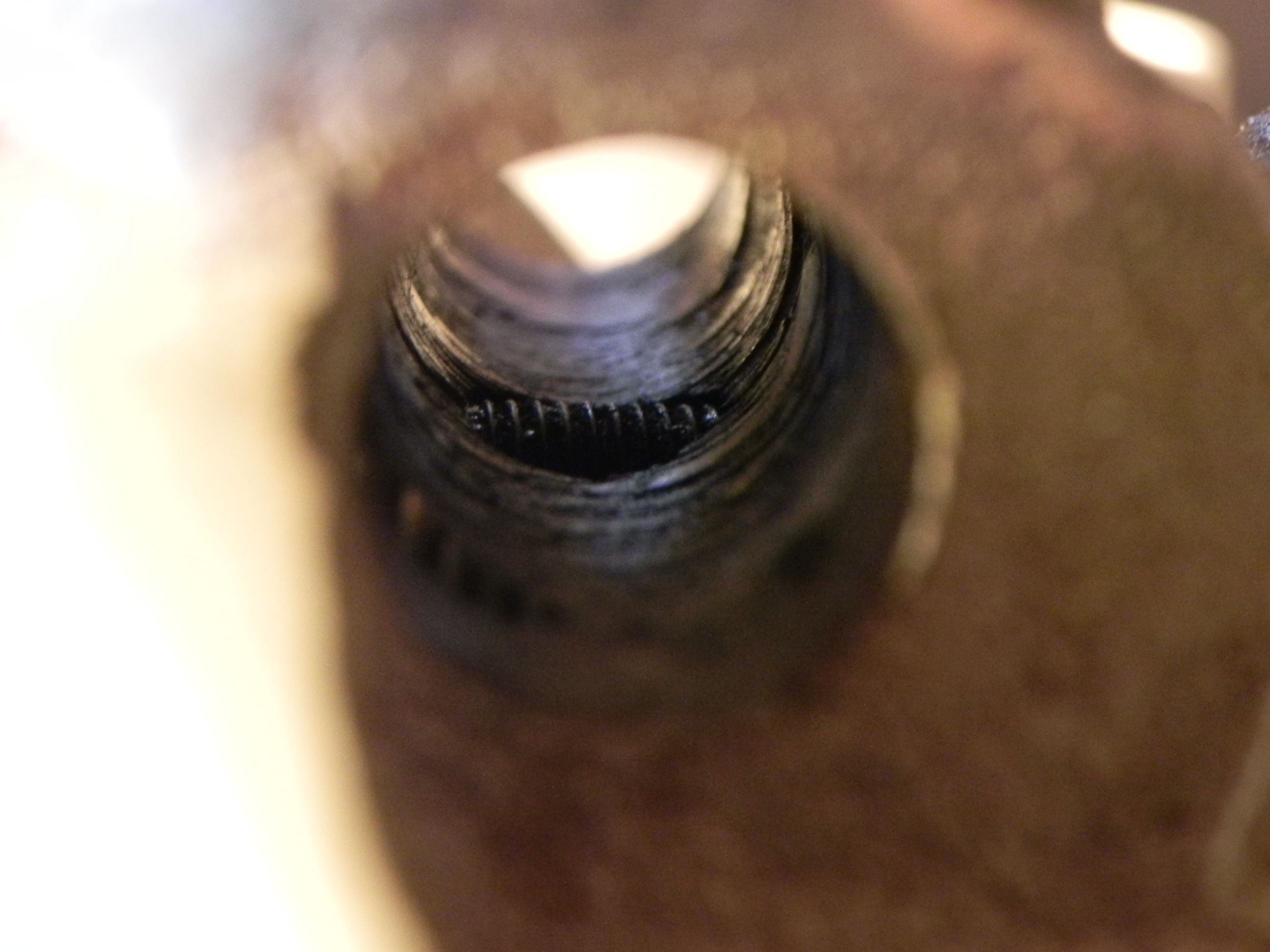

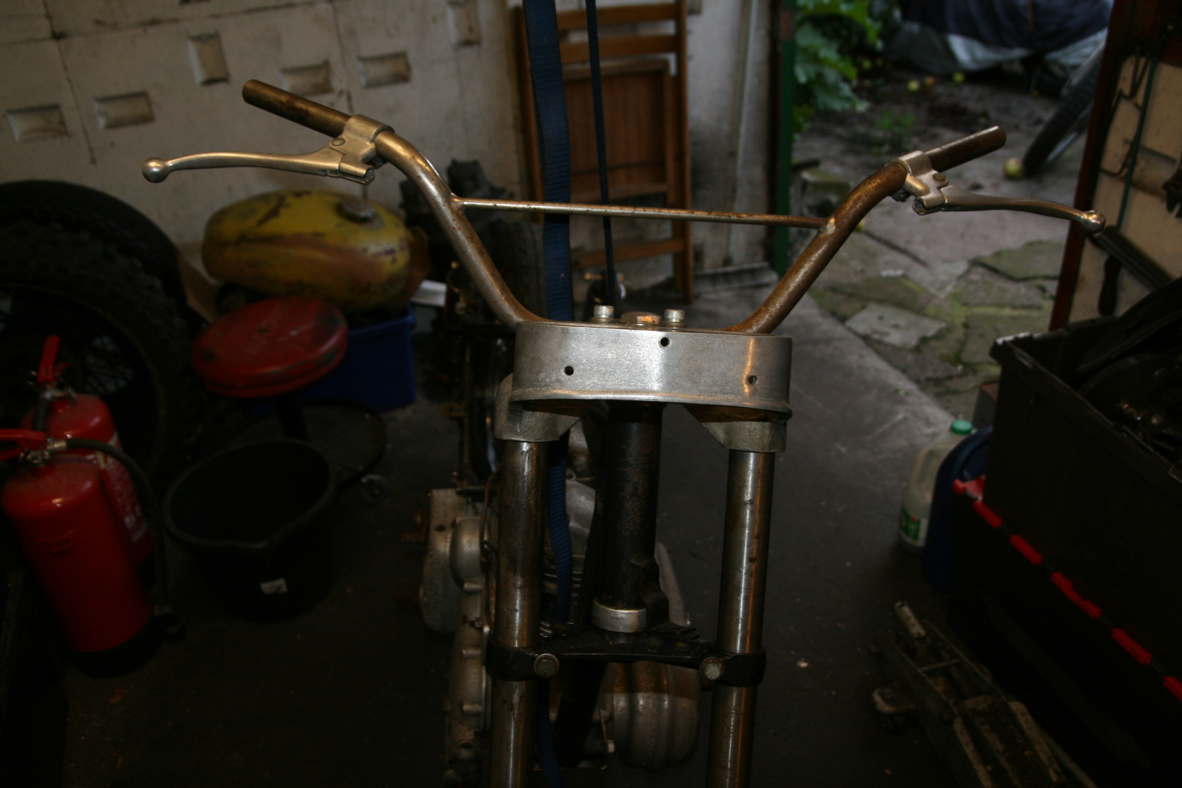

Hi Im trying to fit this top yoke (Indian) to my 1979 Bullet frame, but the steering stem ( 1979) does not protrude through the top yoke far enough to thread the top nut on. If I fit the pinch bolt as is it will tighten against the stem thread, which is not good. a bottom yoke with a longer steering stem would solve the problem. do they exist ???? I can partially solve the problem by using Mr H's long top nut and machining a deeper counterbore in the yoke, but this doesnt solve the pinch bolt / thread issue. thanks in advance

thanks for the info BW- I should have posted a better photo. the thread you see in the picture is actually the thread at the top of the steering stem. i was concerned that the pinch bolt would damage this thread. cheers

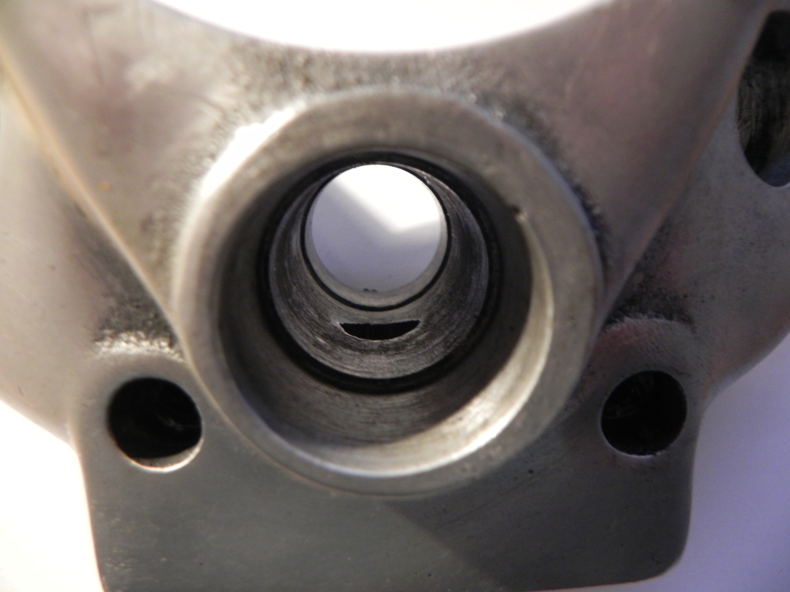

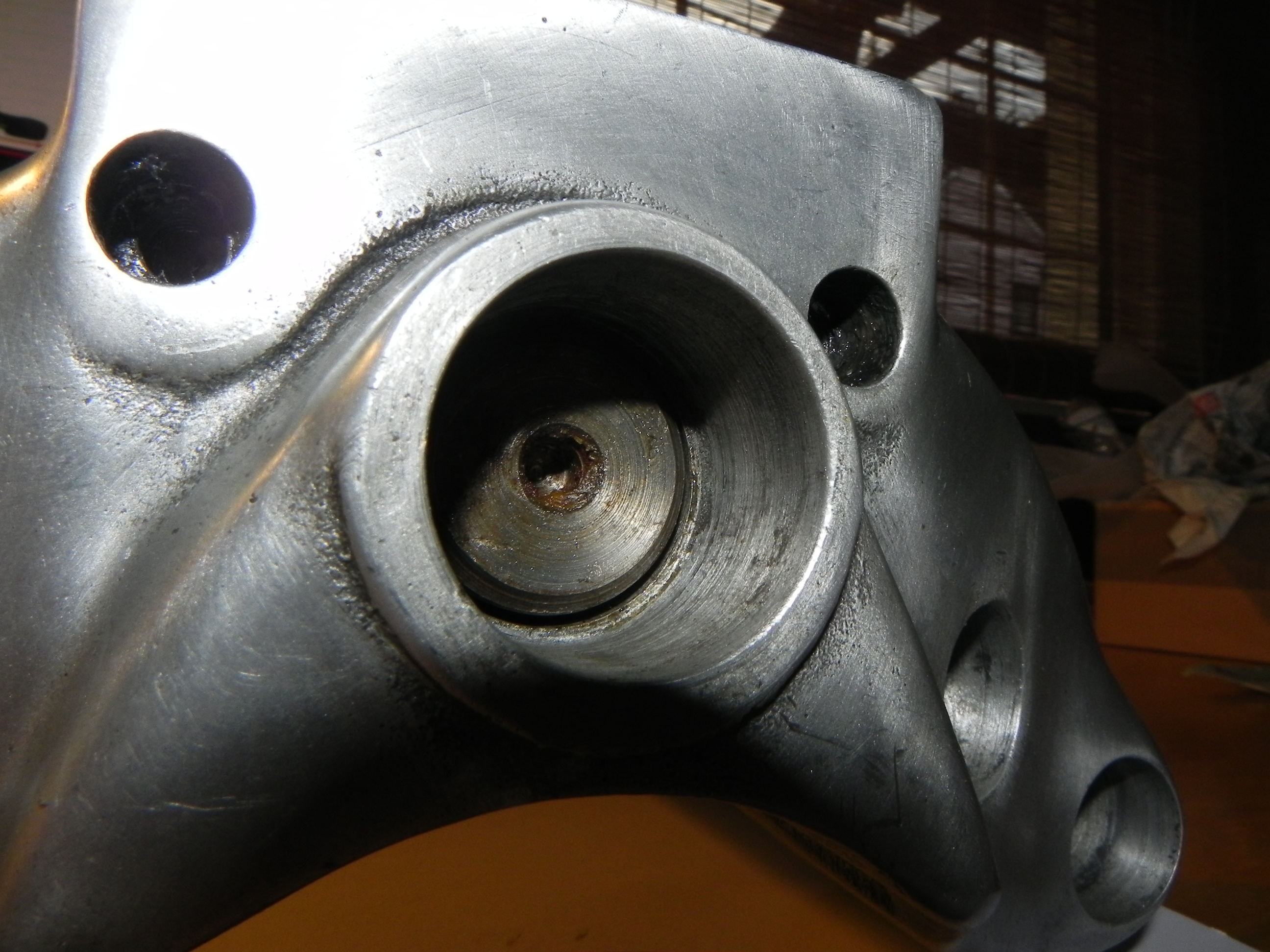

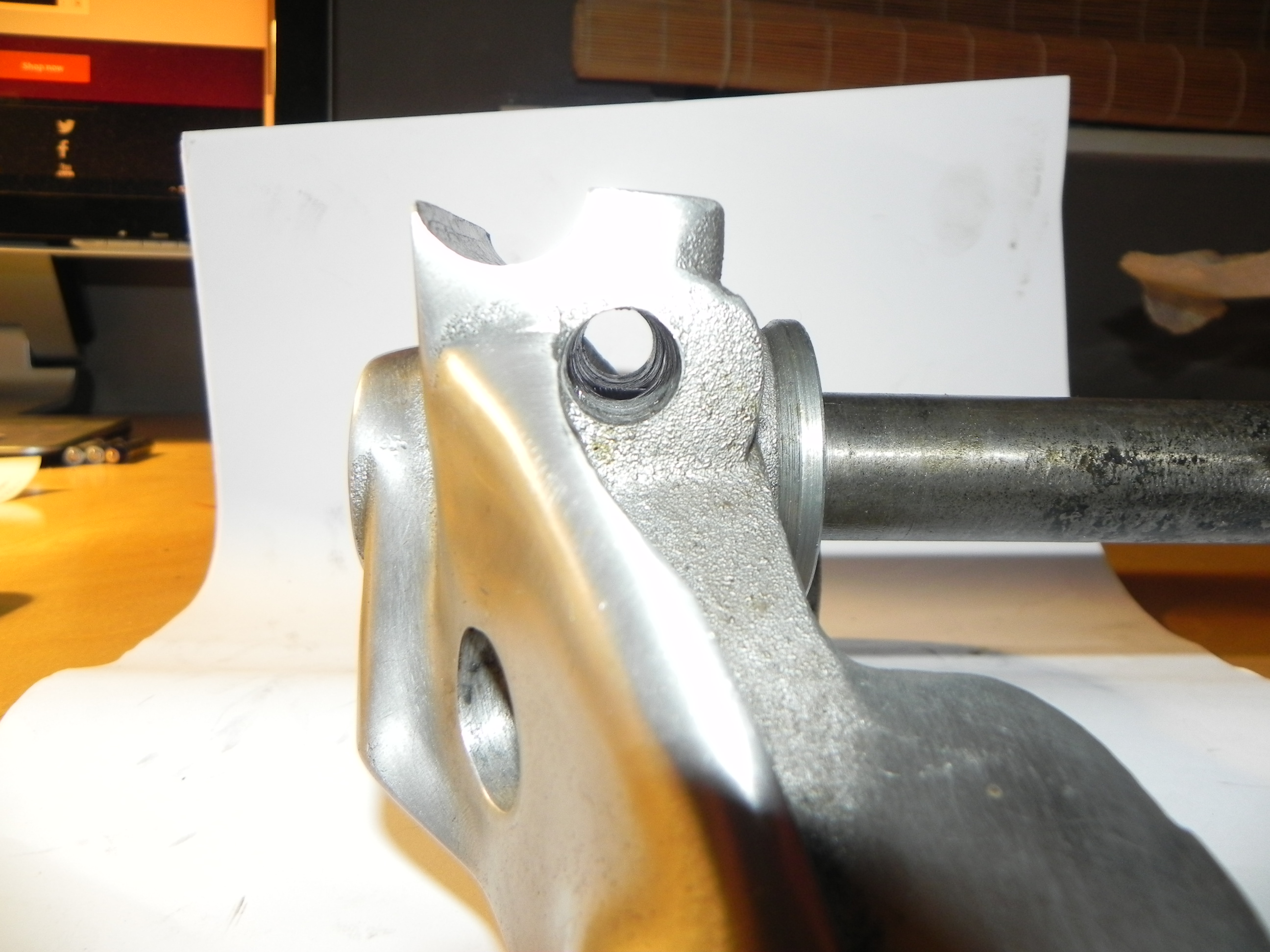

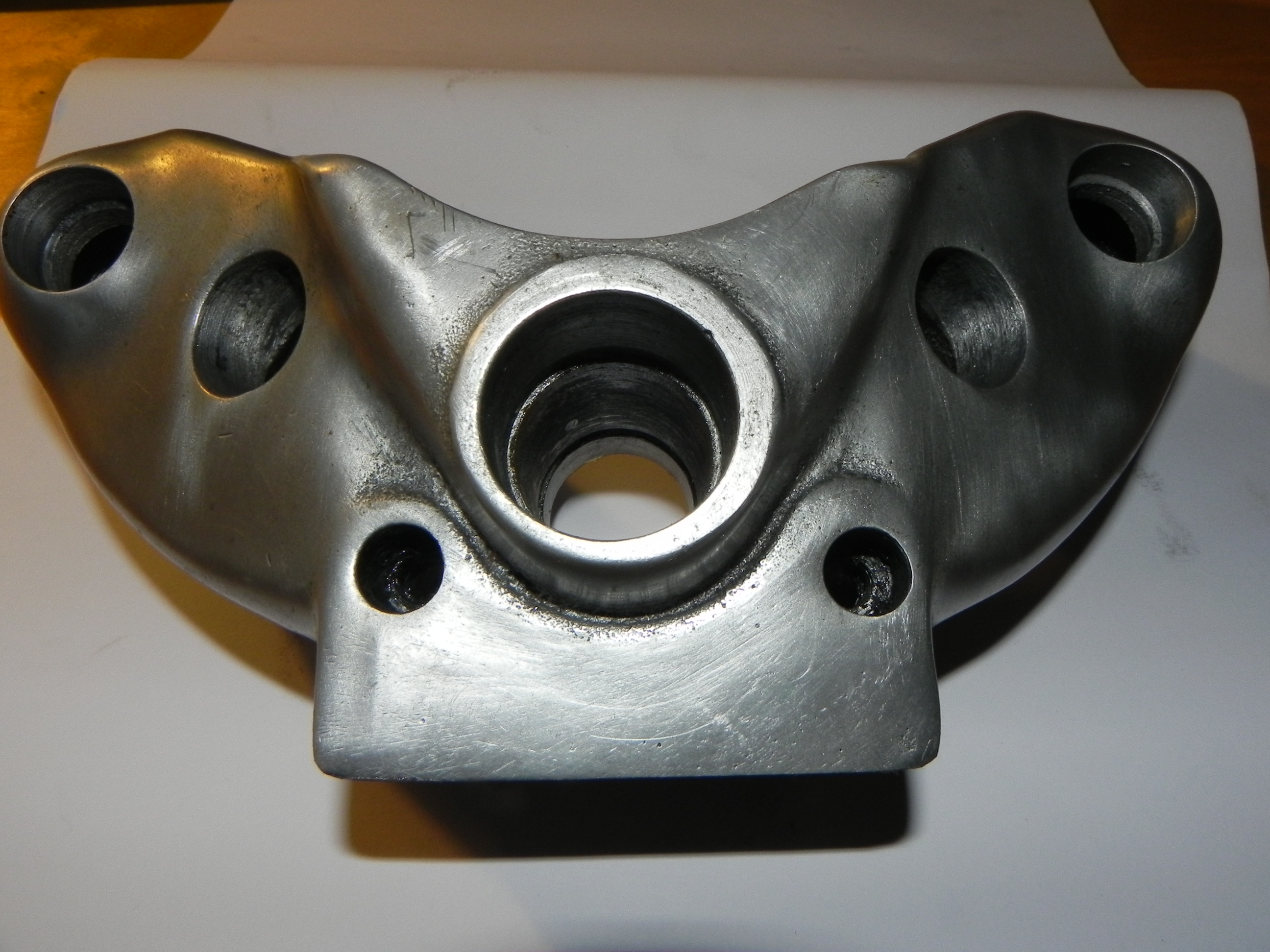

I have just found that the pinch bolt hole has been machined in the wrong place, so it passes through the stem too high up- hence interference with the thread.
I have tried part no 43600 and this will work if the counterbore is made deeper- which is easy enough to do.
even then the thread will only engage on the stem by approx 14mm, as the depth of the counter bore is limited by the pinch bolt hole.

Hi, what type of yoke did you originally have? The reason I as is that the yoke in photo 1 does not look any thicker than the standard casquette . How do they compare in depth? Vince
By mart
#93666
Hi Vince- the bike came to me with this yoke but I no longer have it so cant compare. The trials yoke came from eBay India. I also have a '94 bottom yoke and that is also too short. thanks

You can probably get away with 14mm of thread if the fork stanchions are securely screwed into the top yoke and the bottom yoke and steering stem pinch bolts are securely fastened. That might not be do-able on that particular alloy yoke with the steering stem pinch bolt hole in the wrong place!
