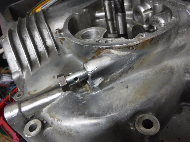

I sent my old Electra-X's crankcases to someone who'd used a torque wrench to tighten up the banjo bolt at the bottom of his Electra-X crankcases. OK, set wrench to the figure in the book (presumably) wind it on and CRACK! He then gave me the damaged crankcases to play with. Once the JB Weld emergency repair was cleaned off, this is what it revealed. At least the cylinder studs use a metric coarse thread, this one is M10 x 1.00, I think.
