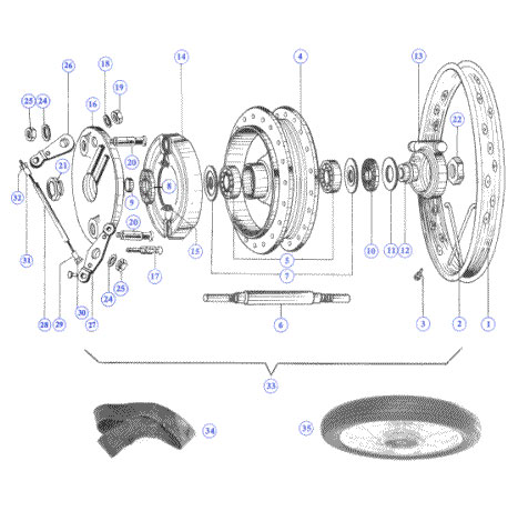

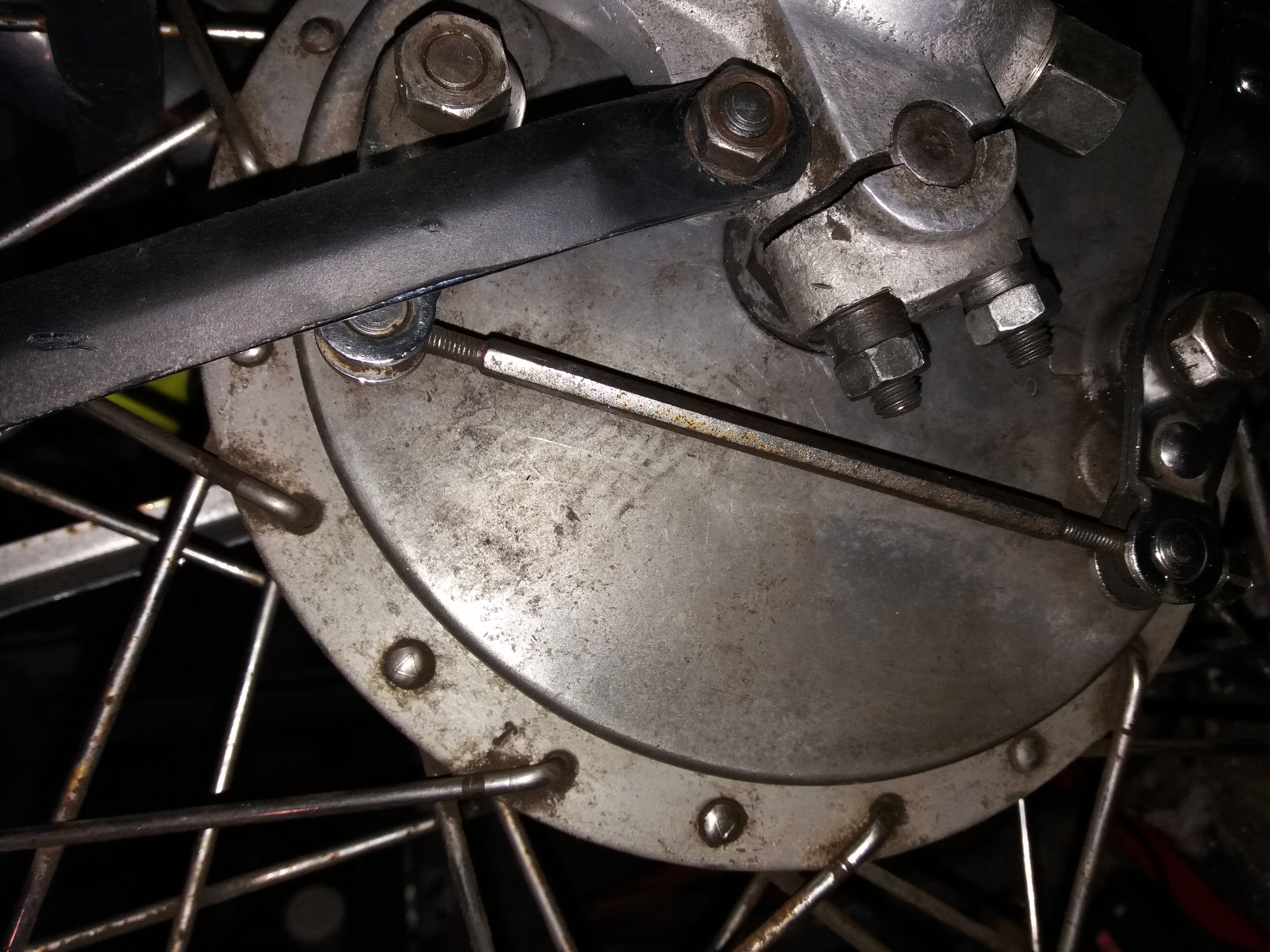

Can you put up a picture of the brake plate with the linkage fitted
It should look something like this
Not the best pic but the only one i have
