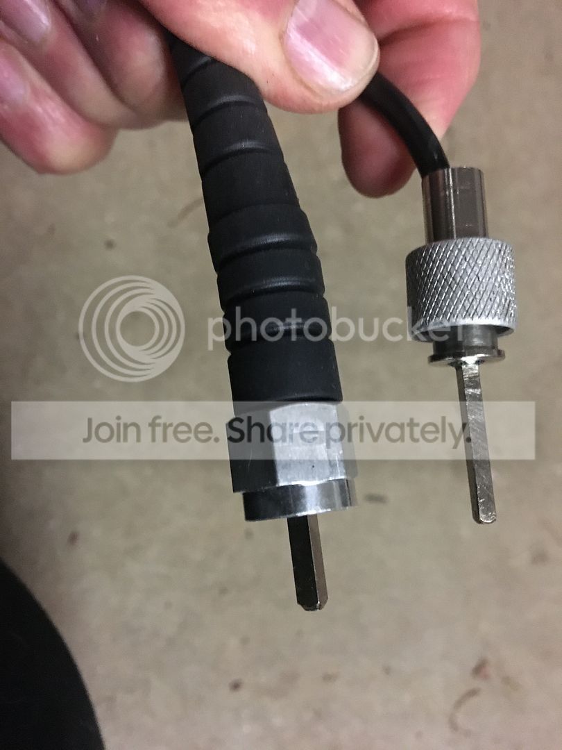

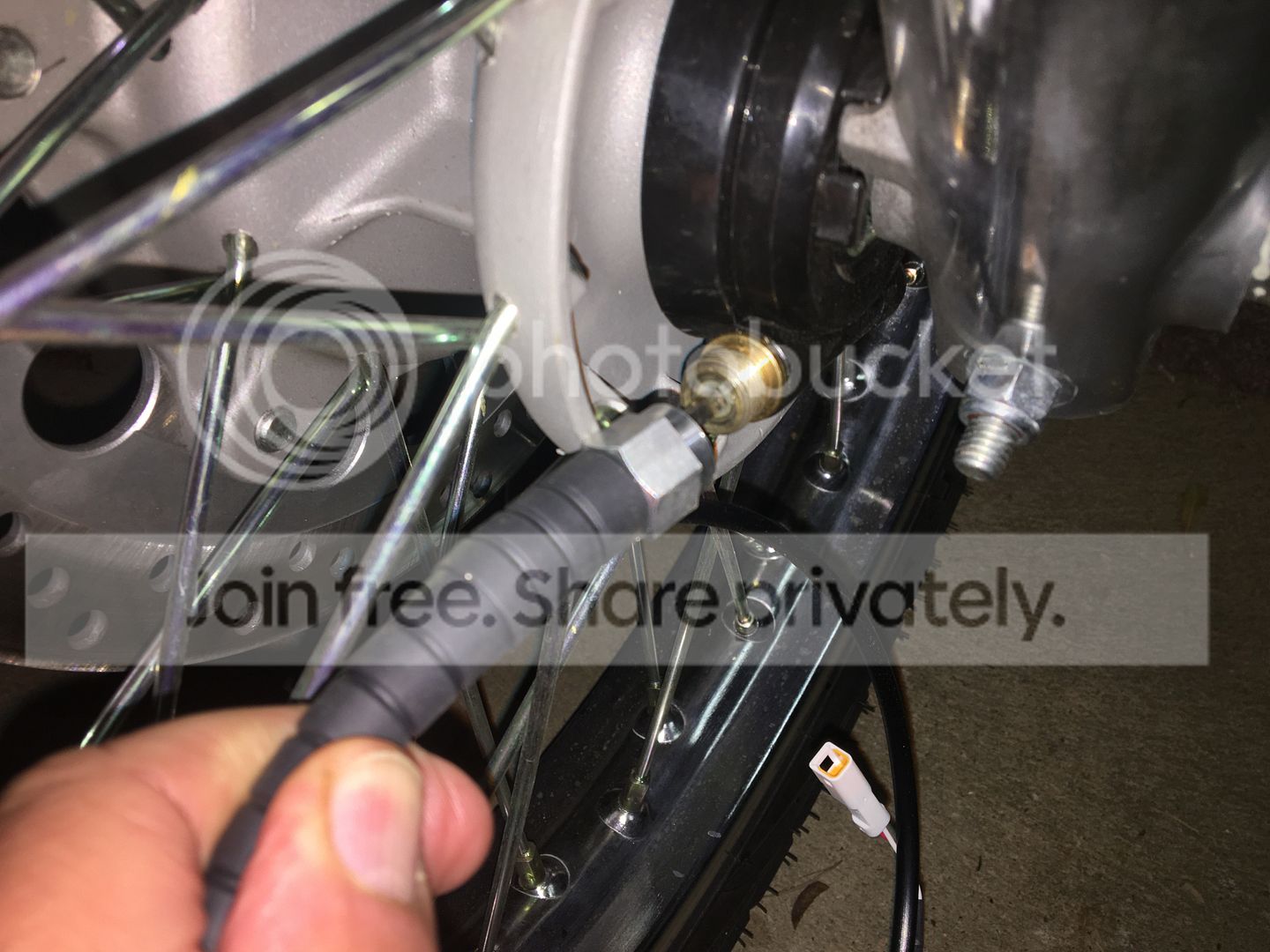

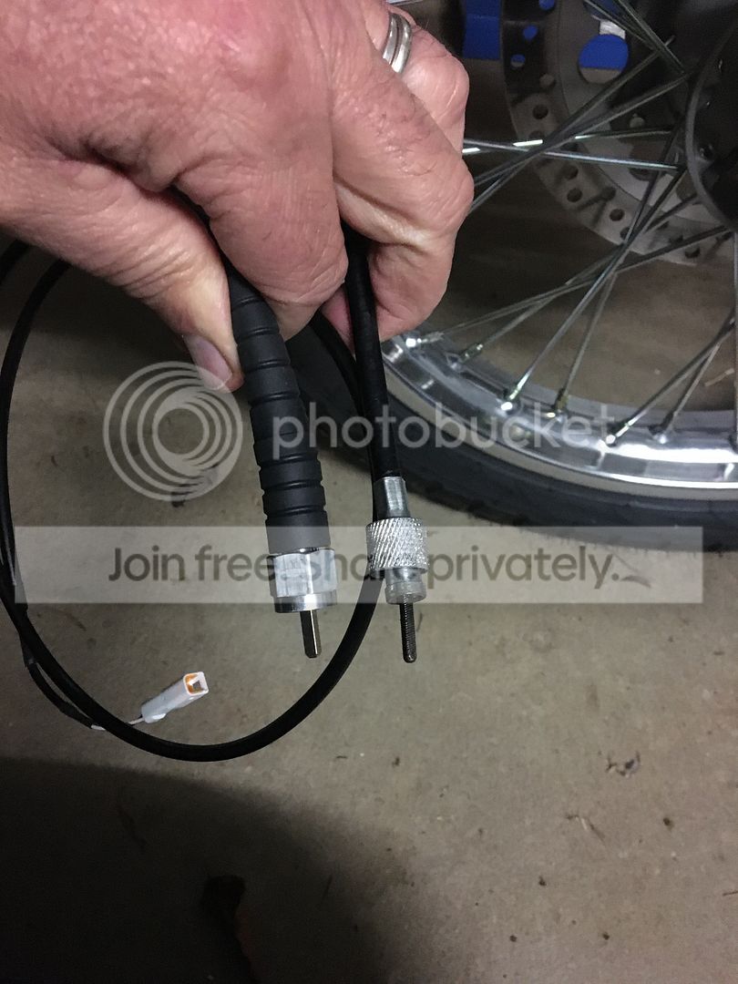

If I can get photo bucket to do what I want it to, you'll see that the two cables supplied by Acewell have different ends.
The smaller of the two is a close match to the one in use on my machine, and with the right collet, is a good fit.
I'd like to get the one with the strain relief working, but it won't fit in the speedo gearbox on my 2020 bike.
I hope this clarifies my question.
thanks in advance...

Hmmm, I can clearly see why it wont fit your speedo drive, it is a fair bit bigger.
I think that's one for acewell to rectify.
The big fat one is the one that has the hall sensor and rotating magnet in it.
What's the smaller second cable for, not the hex one.?🏴󠁧󠁢󠁳󠁣󠁴󠁿👍

They’re both Hall effect senders. I had hoped that there’d been a change somewhere, but I didn’t expect that the sturdy one with the well engineered strain relief to be the problem. The smaller one fits my speedo gearbox, and appears to be the same size as the mechanical cable originally fitted to the bike.
Thanks for the info. I’ll take It up with ACEWELL.
