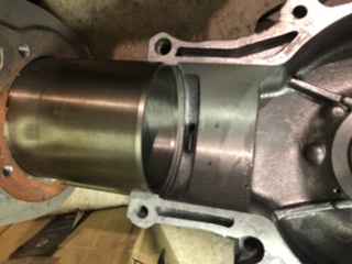

By Allanfox
#91727
Well, drilling done (carefully!!) and you can see how it makes sense to breath out crankcase pressure at the new point, plenty of room for pressure to get out around the outside of the liner , nearly there!

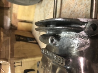

By Allanfox
#91728
Crankcase half

Allan,
you might want to check the outside diameter (I use the word loosely) of your successfully drilled stub, from experience 12mm hose might be a better fit than 10mm on that side. As they're just cast they won't be perfectly round, but you want the best fit possible, with a nice stainless clip to finish it off.
