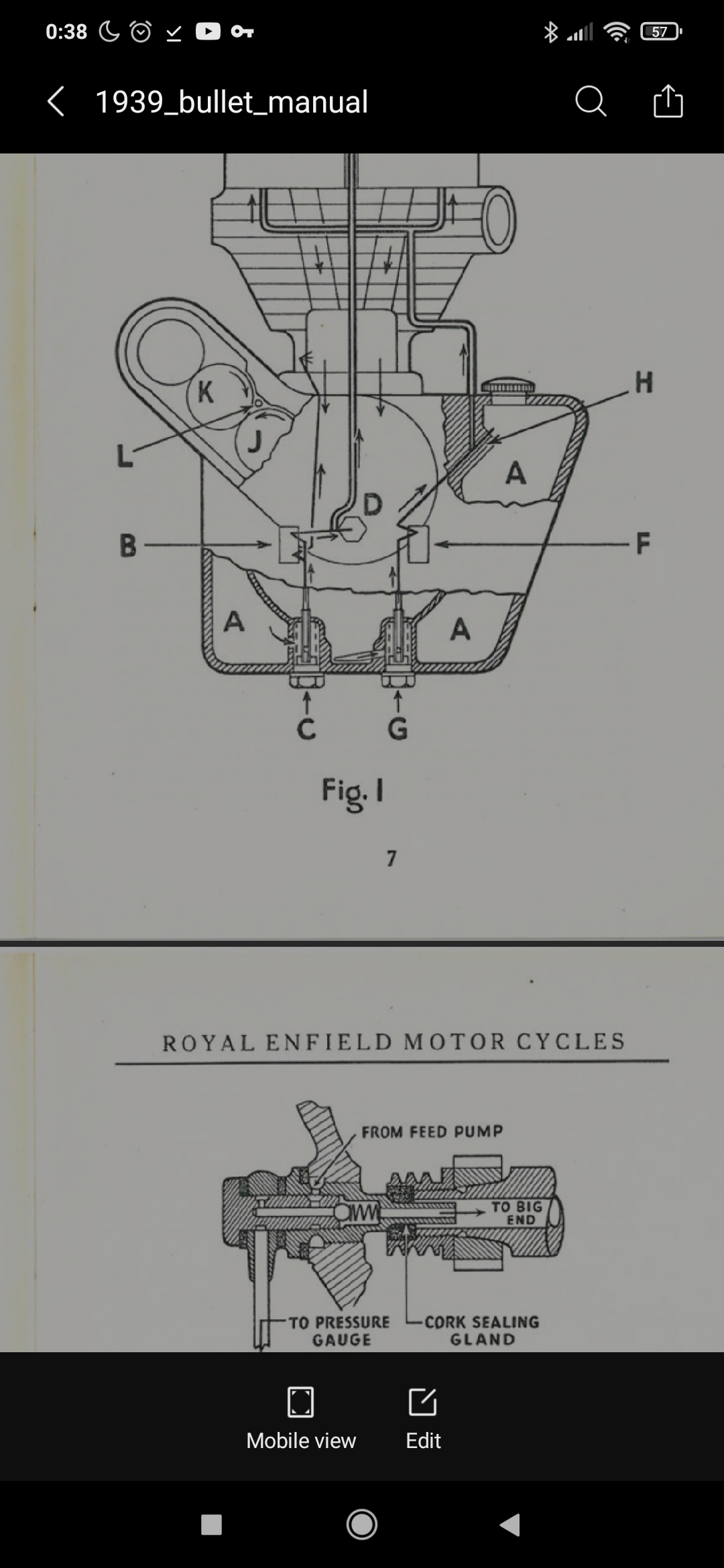

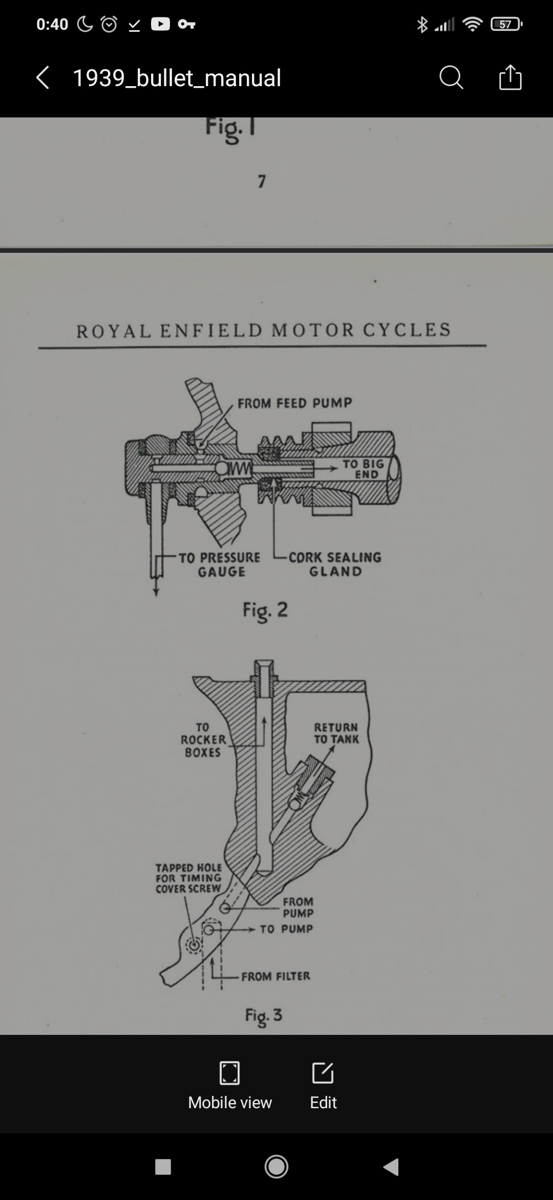

I could find in a Enfield manual from 1939 the exact part, but no part number in a book, maybe somebody knows thx clemens

Ah, now these drawings make things much clearer. It is worth noting that our hosts do have some unlisted stock in their warehouse, the part you need is is probably unobtanium, but you might be lucky.
As a temporary measure you could plug the threaded hole used by the banjo bolt with a plain threaded set screw, you just need to identify the diameter if the banjo bolt in fractions of an inch (e.g. 5/16 or 3/8) and then count the number of threads per inch to see if it is BSP(P), BSF or BSC thread. From your previous photo it looks to be somewhere in the region of 5/16" diameter. A specialist bolt supplier in the UK, or maybe our hosts might have a bolt the right size on the shelf which can be machined to serve as a replacement banjo bolt.

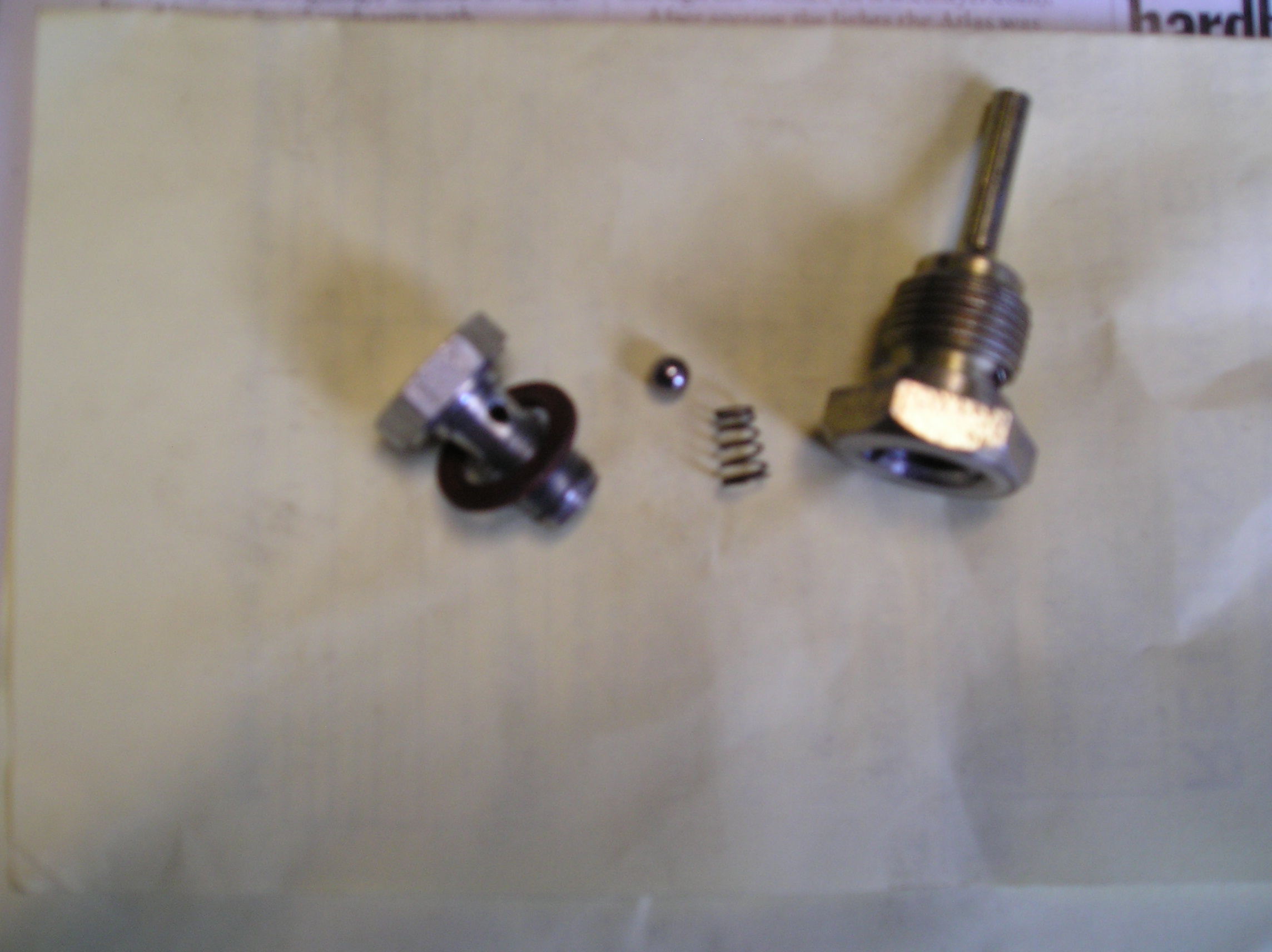

Hi Adrian,
thanks again, just let 2 ballons fly, one is the message to ths host amd second similar to your post to replica a new one outof sthg similar.
Btw. Do youkknow what exactly the ball with the spring,iis it needed to hold the oil in place and does the later ones of this plugs have this also inzids?

That does look like a non-return valve on the oil feed to the crankshaft, but it would also stop excess oil draining out into the crankcase when the engine is stopped with the crank at bottom dead centre, the so-called wet sumping which results in thick clouds of oily white smoke when the engine starts up. The smoke usually clears once the scavenge oil pump clears the excess oil from the crankcase. Redditch built Bullets also have a non-return valve on the scavenge side for the oil feed pipe to the rockers. This is not to be confused with the pressure release valve fitted to the crankshafts on some Bullets.
As far as I know the ball and spring in not a standard fitting on the Bullet, but the oil feed plug on my Big Head Bullet was modified by Bullet Whisperer to include them to prevent wet-sumping.

That does look a lot like my 'invention'. The ball and spring would probably create more pressure than a roller big end, and I would think they would be responsible for any pressure recorded by a gauge - a largely similar [in function but not appearance] layout can be found on Ariel singles from a similar era.
