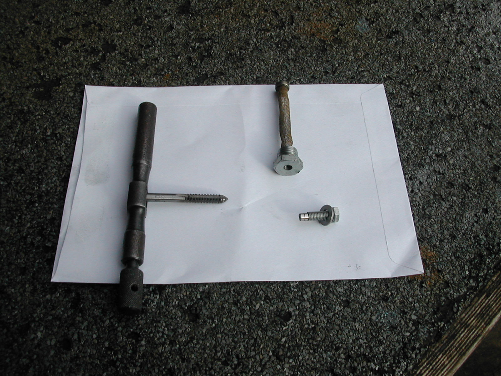

Working from back to front,
Plug 1 = oil tank drain;
Plug 2 = gauze strainer plug for the feed-side oil pump;
Plug 3 = gauze strainer plug for the scavenge side oil pump.
The latter will bear the brunt of any big and or main bearing failure, sadly the gauze is still coarse enough to let damaging tiny particles through and score-up the inside of the scavenge oil pump body, which is actually part of the timing cover.
You can drill and tap this for a ¼" BSF set screw with a couple of 5mm neodymium magnets on top to help trap any unwanted ferrous particles.
