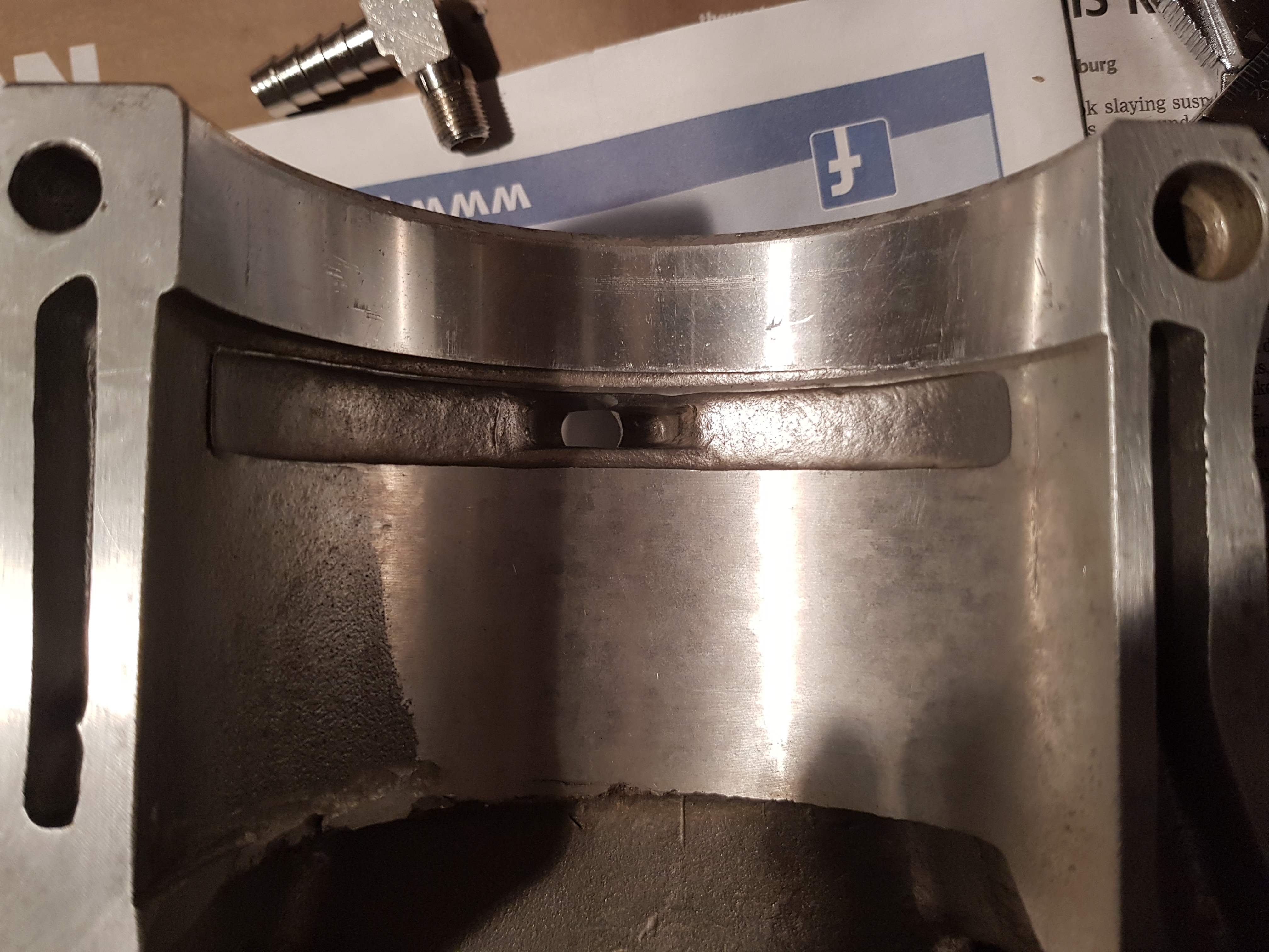

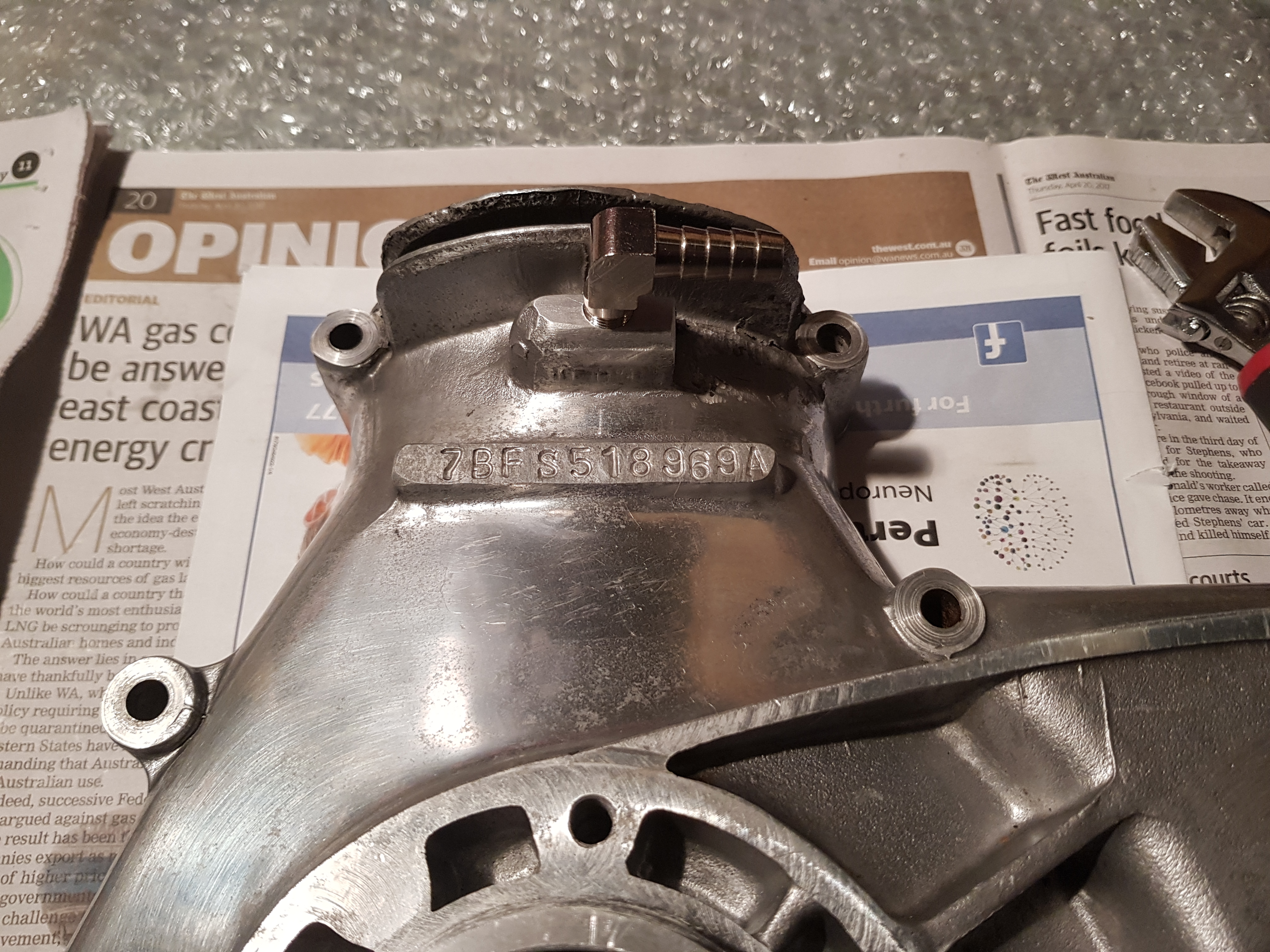

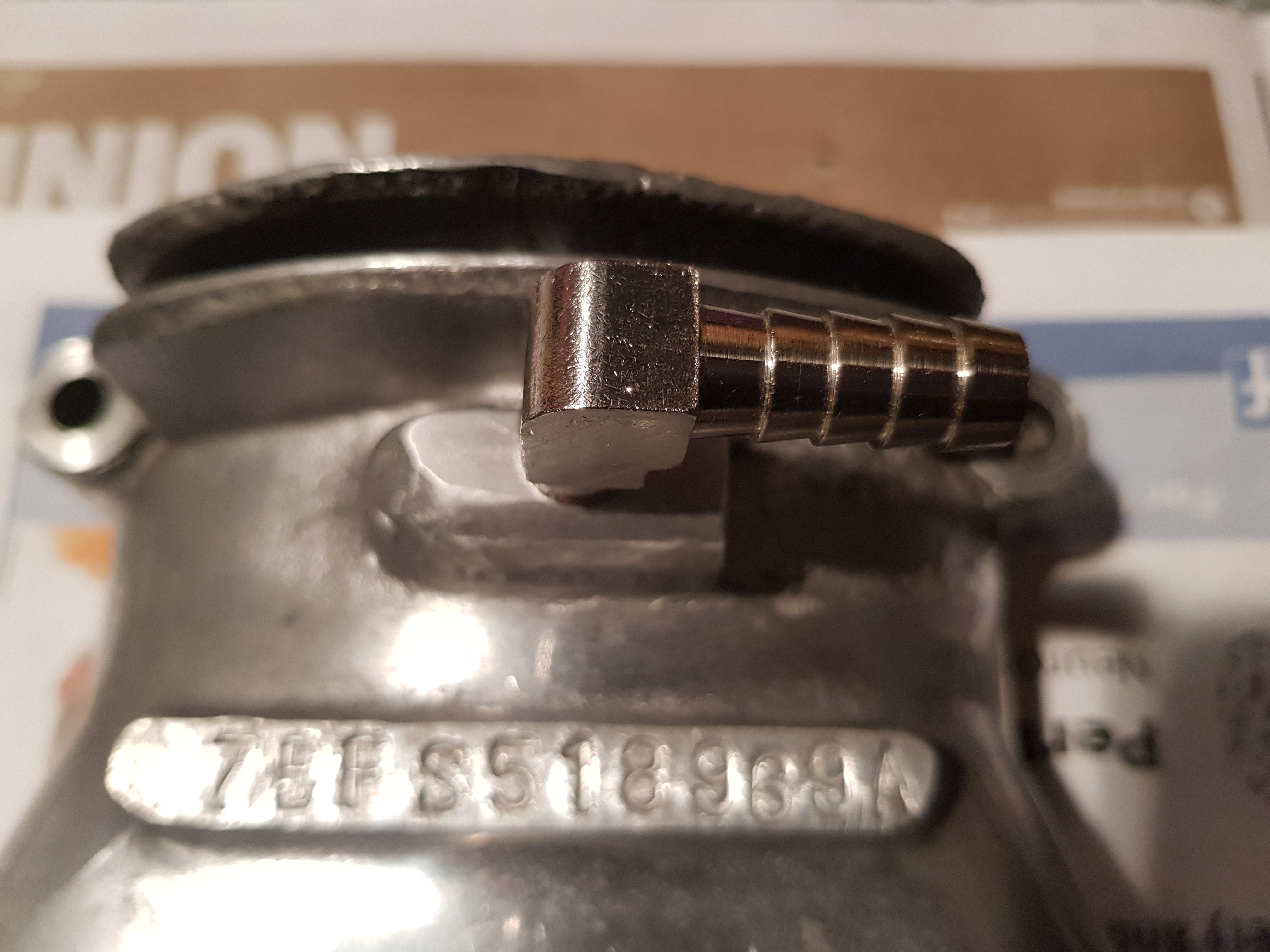

The "stub" on this 2006 iron barrel bullet was only partially cast, so I cleaned it up, then drilled and tapped for an external fitting.
Both this (additional) barrel breather and original oil tank breather vent into a custom oil/air separator. (a similar though better version of the factory catch can)

By Allanfox
#91846
Thanks Adrian, 10mm hose fits ok, like you suggest it is anything but round (looks like a blob of weld!) but should be ok, have done some careful filing, worse scenario is an oil weep but sure I could seal it up if need be.
