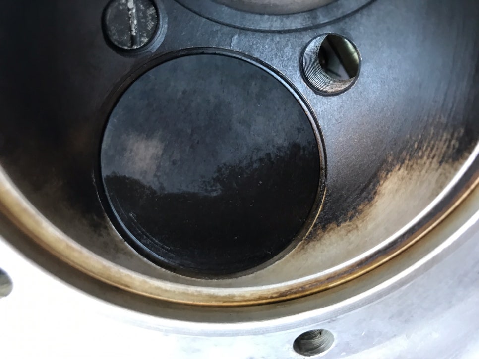

Last week, I installed 8.5:1 Piston 535 barrel kit, brand new cylinder head and aluminium push rod from Hitchcocks.
oh and one more thing, I changed drive sprocket 17t to 20t
I adjusted pushrod and solved all other engine noisy but still I can`t found the cause of sounds like Piston touching Valve.
actually I checked valve and piston but there was no sign of crash between piston and valve.

By Lee June woo
#84052
Andy.
Your suggestion was very efficient.
Today I adjust ignition timing dish.
ex-owner broke the helix so I realize that today. however I fixed it.
before adjust position of dish.
Recoil
Insert the helicoil
That moment dish turned clockwise However I rotate the dish counterclockwise more than first picture.
After adjust, I ride for test and checked there is no more noise when I pull the throttle without power loss or idle fail.
