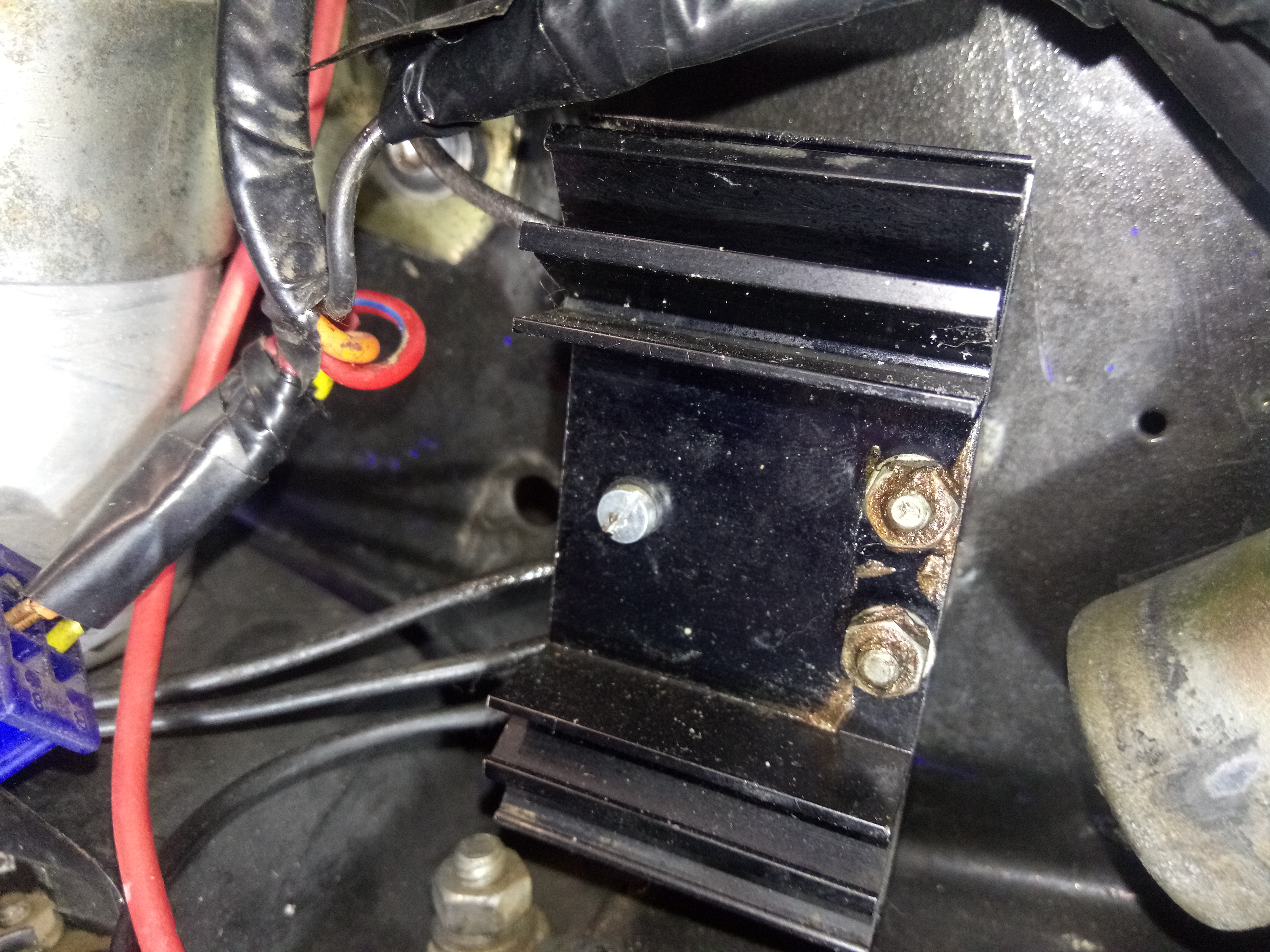

I have not ridden my bullet for 4 years. It's in trials trim and this weekend I was going to replace the points/condensor/plug and check the timing.
The bike starts and ticks over but was a bit tempremental on it's way to the MOT (did not want to start, uneven running).
Going to check the points I saw there was no power at the points - but the bike still started & ran !
Power goes to the coil & there is power to both sides of the coil.
However the wire I expected to go from coil to distributor goes to the module in the pic and from the module a wire goes to the distributor. (coil & module located in toolbox)
The 3 wires going into the module are,
Coil + to module
Coil - to module
Module to Earth
The wire coming out of the module (top left) goes to the distributor.
Does anyone know what this module is, what does it do & do I need it ??

It would be interesting to see what is underneath that heat sink. Could it be a solid state device to switch the coil current and so reduce the current the points have to carry?

As I thought, a simple device to lighten the load on the points. I see they are still available. I would certainly leave it if it is OK. After all it would be simple to bi-pass if it should fail on the road.
