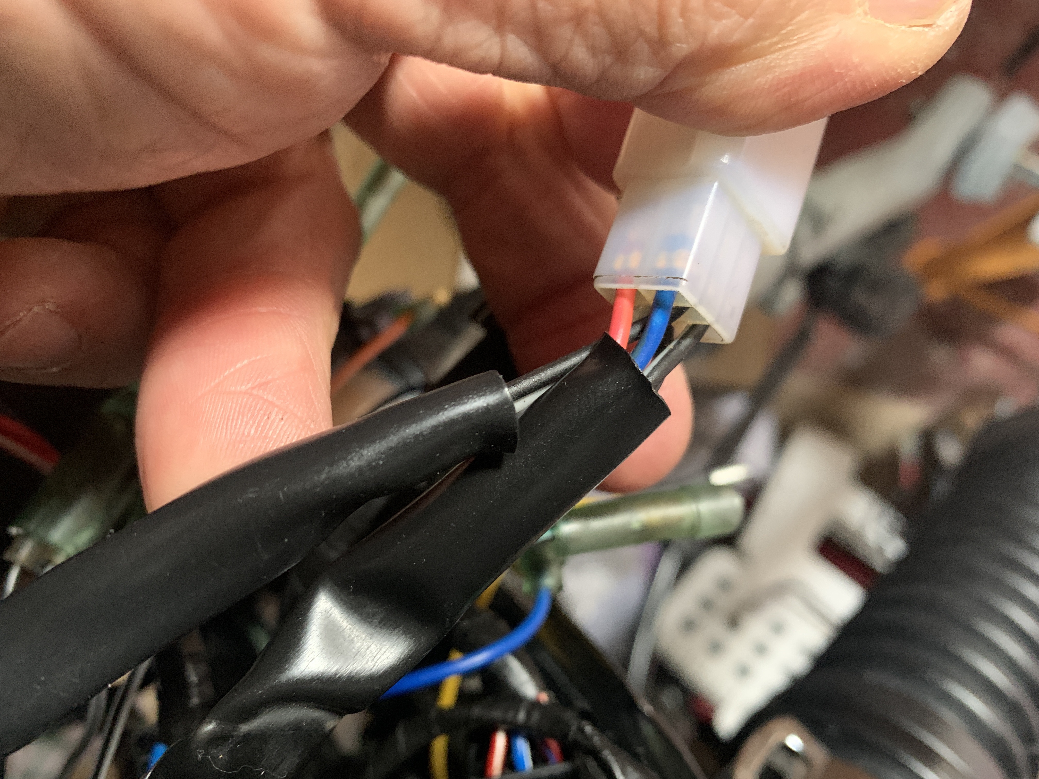

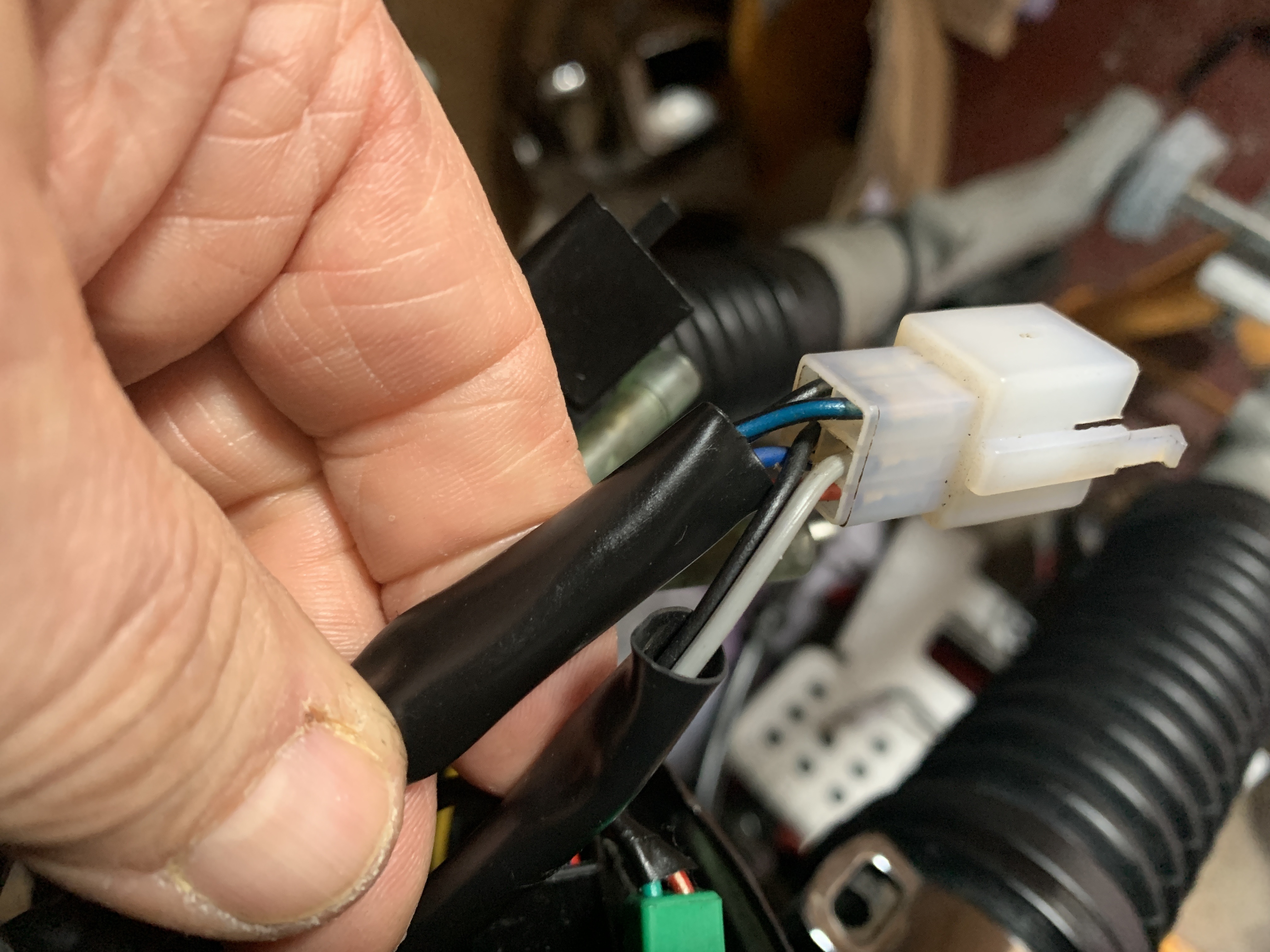

I'm confused, I've changed from having a Rev counter and speedo to a nacelle arrangement.
The wiring is confusing me from the Nacelle (speedo) I have the following
Red wire-??
Blue wire-Main Beam ?
Black wire- Earth
Black/White tracer- LH Indicator
Black/ Blue tracer- RH Indicator
Grey- Dial light
Much of the wiring diagram from the Electra X manual doesn't show the wiring colours
Also the ignition switch has
Blue /white tracer-Feed out to Ammeter ?
Black - Earth
Red- Feed
Blue - ? not sure it's used
The plug that connects to the ignition switch is a 4 pin connector with a Red wire and a Red/yellow tracer one connects to the red and the red/yell connects to the blue/white tracer wire is that correct the black and blue aren't connected.
