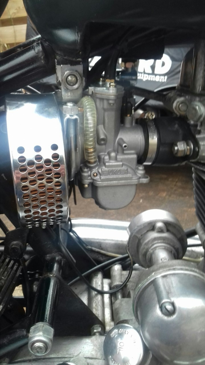

Thanks both for reply, I took an other look and the advance system does release, comes back if the cam does not push the contact breaker up. (if it does, it stays in any position).
The cam has back/forth play, i was thinking about adding a thicker ring or shim to prevend the cam sliding too much over the spindle.
I flowed the head, mounted an open air filter (pic) M20 exhaust (absorbtion) and 30mm carb, i was hoping for a little extra power..
Musta dmit that carb is still not adjusted right and - i guess- is very rich at the moment.

What sort of contact breaker drive/distributor housing is fitted to your Bullet? You might do better with the type fitted to late export 500 Bullets which has the shaft running in proper bearings, the one shown in your photo seems to be the older type.

If many German Bulleteers are using the OKO successfully and yours is still running rich, I can't imagine all those Germans wanting to stop and clean their spark plugs every 50km, so you must still be doing something differently from them - pilot air screw adjustment, perhaps? Needle position?
Forgive what I hope is a silly question, but are you running with the cold-start plunger wide open, or at least not fully closed? Check the lever or plunger cable is properly adjusted, and that the thing shuts off properly once you have the engine running.

The choke comes back good (no cable choke), with a smaller idle jet (40 ipo 48) setting is 2 full turns out, needle is now in 1 to-lowest position.
Open air filter (see pic) M20 muffler, and flowed the head..
