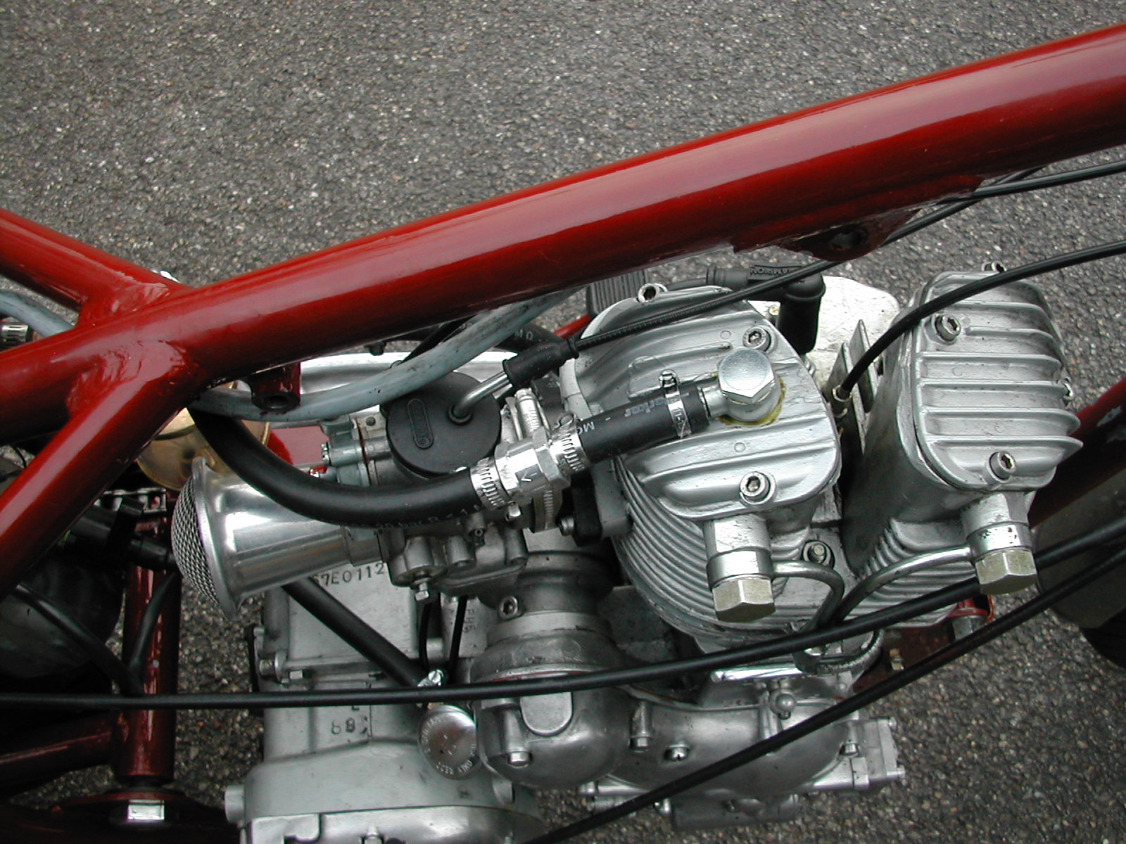

I'm not sure if venting the rocker box(es) make a huge difference in normal use, probably a better idea if the bike is going to get thrashed a lot. I did vent the inlet rocker cover on my AVL hybrid engine but not on my Not A Fury.

@ Adrian I have just ordered the same one way valve as the present lot of duck bills don't seem to seal too well, I bought 3 from our host's and none seem to seal when sucked on !
How did the valve work out?

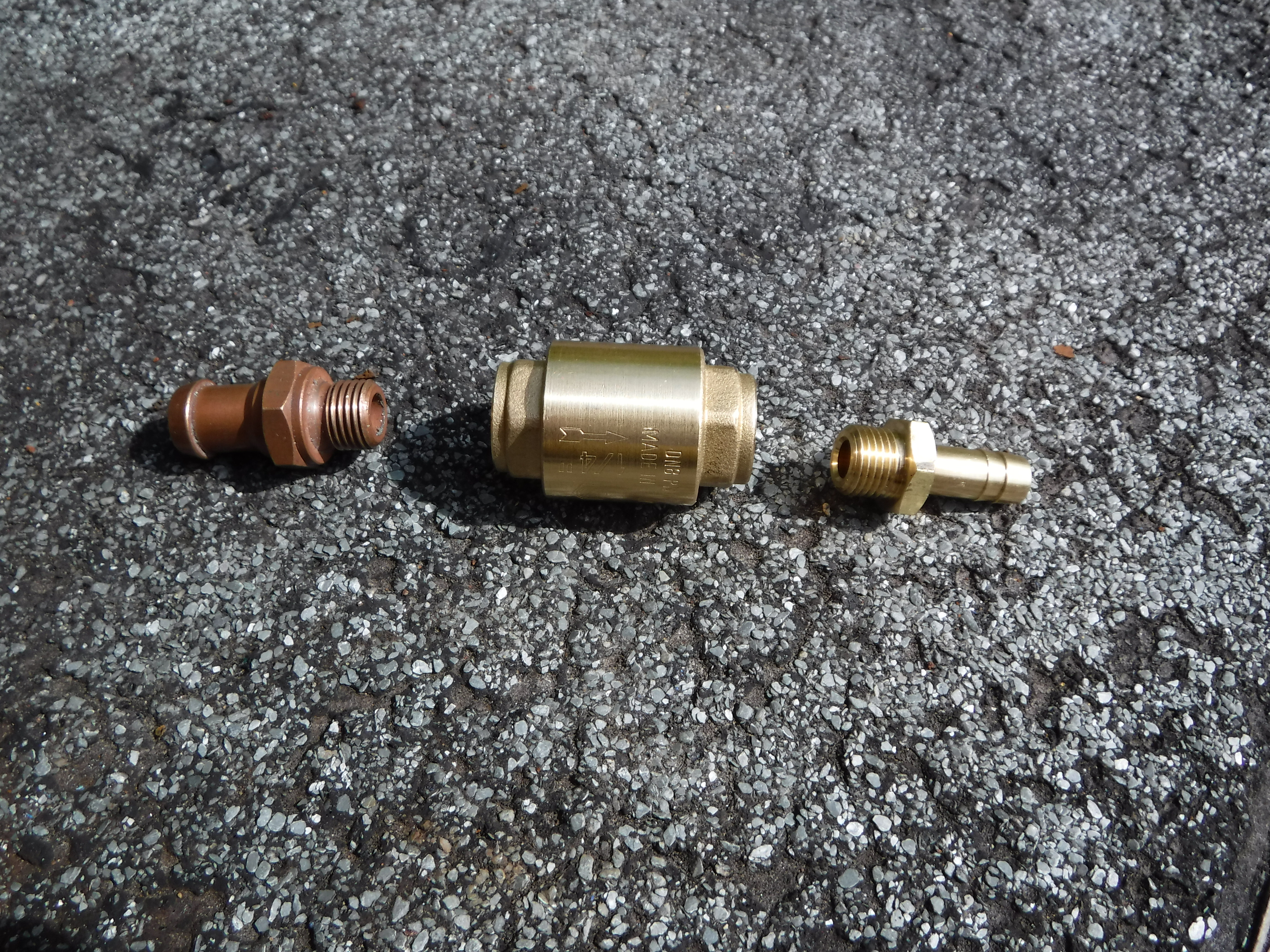

@ Dai,
There are loads of different non-return valves out there, ideally you want one that operates easily, i.e. without needing lots of pressure to operate the spring, so avoid the VERY cheap ones. If you have room my favourites are the ¼" BSP brass type which take a hose tail for the size of breather tubing size of your preference. See piccy below.

#89933
Thanks Adrian going to look into it further
To anyone thinking of using the right angle adapter in my photo take out the valve core and small brass plate at other end

Or dive into the wacky world of ¼" BSP pipe fittings!
