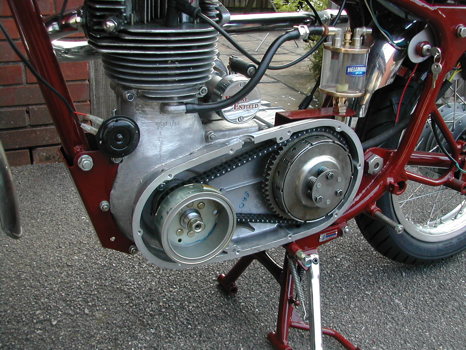

All of my Redditch-framed stuff has Indian side stands, one of my bikes is in a Super Meteor frame, but as far as I can tell the Bullet frames of that period are the same as the twins, except for an extra top-tube lug on the later twins for the head-steady.
Here is an old picture from the build showing the Samrat sidestand mount with a slightly longer 3/8" through stud as well as the longer Indian hex footrest bar, not sure whether this would clear your l/h exhaust pipe or not. Indian centre stand also shown.
