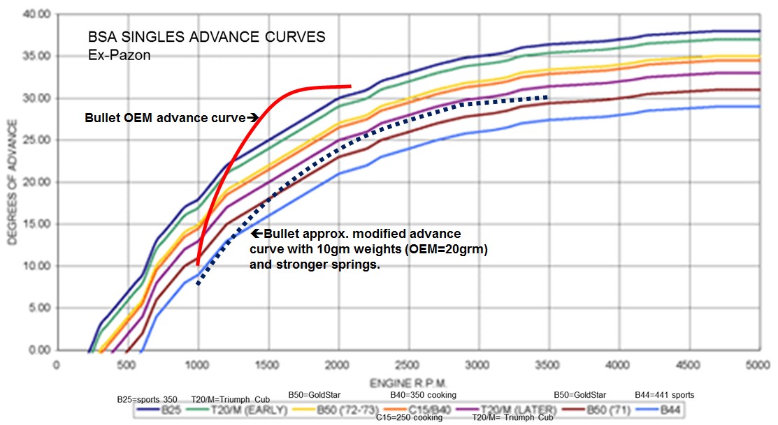

Adrian – yes, the B50 has much the same advance as the Bullet BUT the curve suggests (I got the image off the Pazon website but I suspect it wasn’t theirs) it doesn’t advance the way an OEM Bullet does – hence the need to slow down and control the rate of advance and therefore the interest in electronic ignition. I’ve approximately located the Indian Bullet OEM and my modified advance curves to the image – see attached.
