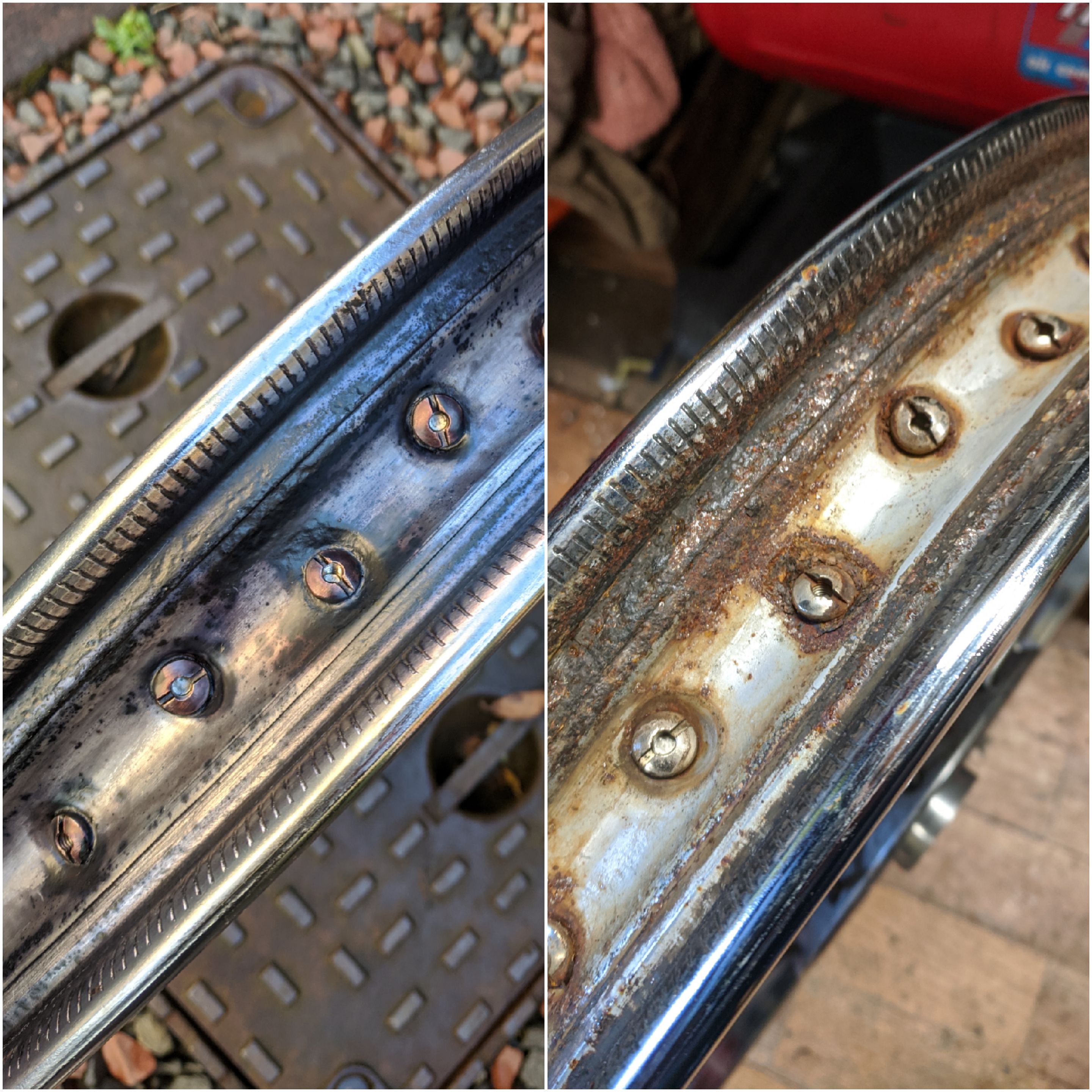

Wow that tyre was tight, even the tyre centre had to work hard on the machine to get the tyre off. With a new tube in the tyre bead would fit flush with the rim until there was 60 psi in the tube and then it popped on.
I was surprised the amount of rust particles and stains on the old inner tube, the bike is only 3.5 years old.

This wheel wheel is less than 3 years old, first time the tyre has been removed.

Most of mine went that way too. I wonder if they are using loads of soapy water rather than just tyre soap to fit them. I find it takes a lot of pressure to get the beads to pop onto enfield rims too -especially considering they are tubed fitment- which might explain why they'd do such a thing.
They clean up reasonably well with a rotray wire brush, then a coat of rust killer and some zinc oxide to stop it happening again. POR15 resin paint, like they use to seal rusty fuel tanks also does a very good job inside rims.

I use a rust treatment called Hydrate 80 to treat the rust.
I think the major problem is poor chrome plate process.
There appears to be no base prep of copper or nickel, just chrome straight onto the steel.
#98025
I don't think there's any chrome at all below the crimp in the rim. Looks like some sort of cold galvanize produst?
