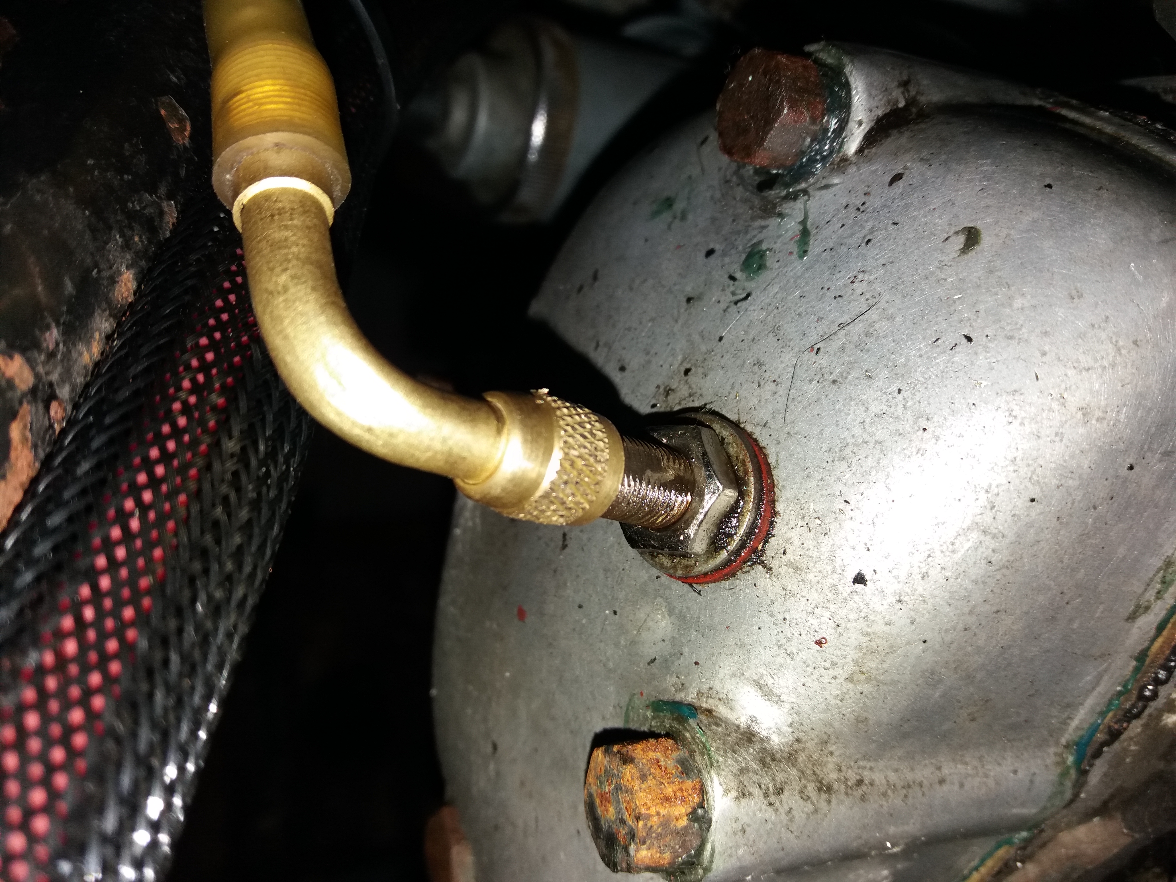

By Daiwiskers
#89895
Paul fitted a breather to the inlet rocker box on asbo 30 he used a valve stem then I added the 90° adapter
But it's a G2 motor please excuse the blue grease

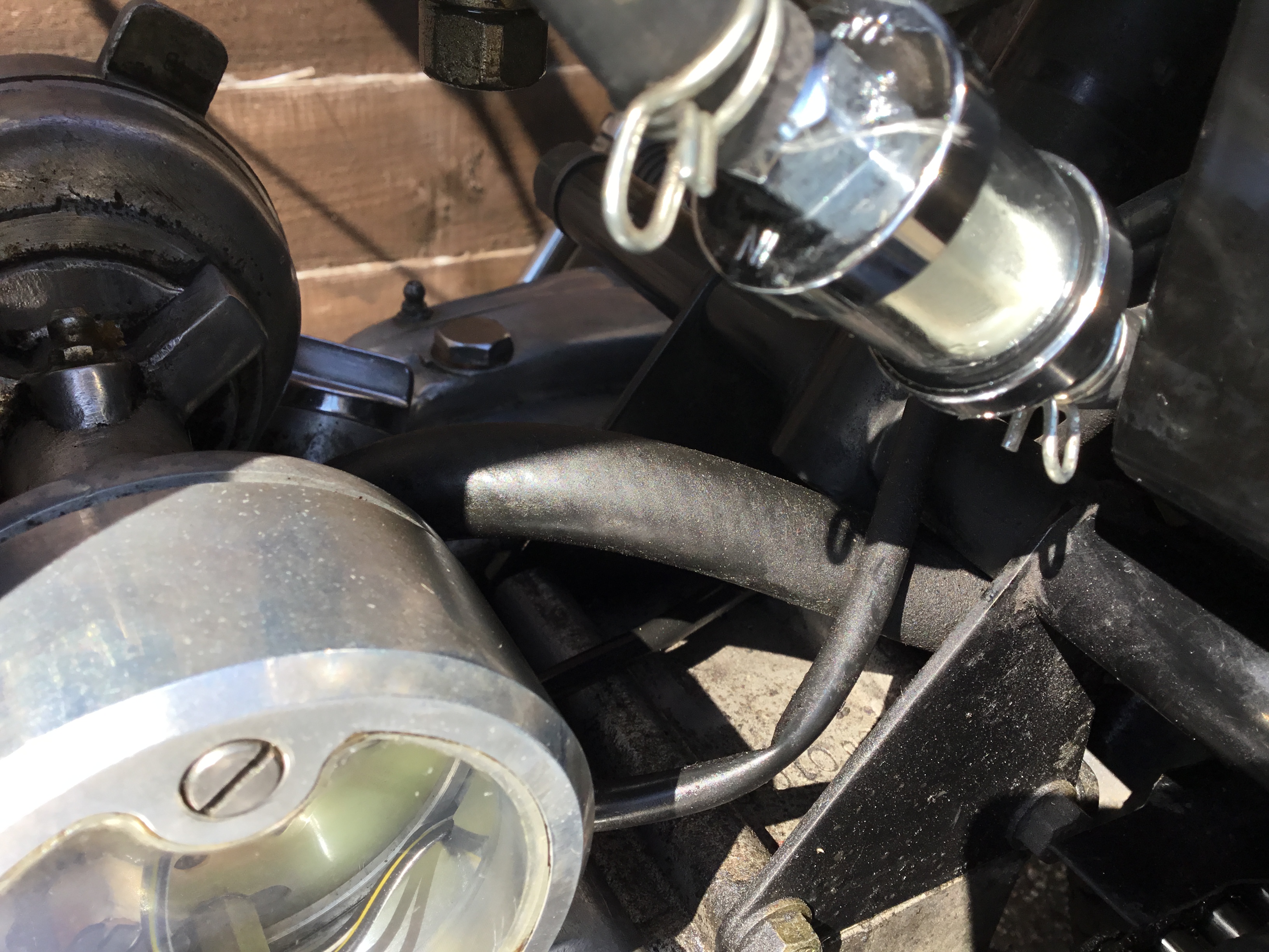

Well I’m glad this thread goes on.... so I can get full understanding how this venting, oil feed system works :)
I was new to RE last year when I got Gupta, my 2002 350; register as 2006.
I posted a picture and Adrian gladly replied and explained; I’ll stick the piccy below as a reminder.
So, for my understanding please; well at least for my bike.
Reading your posts, the pipe to the timing chest was just from the catch can. I do not have a catch can and this pipe is blocked off.
I then have a breather to the back of the bike. Just to clarify, is this big pipe from the crankcase or oil tank? As I believe there is a hole between crankcase and oil tank, I wasn’t sure.

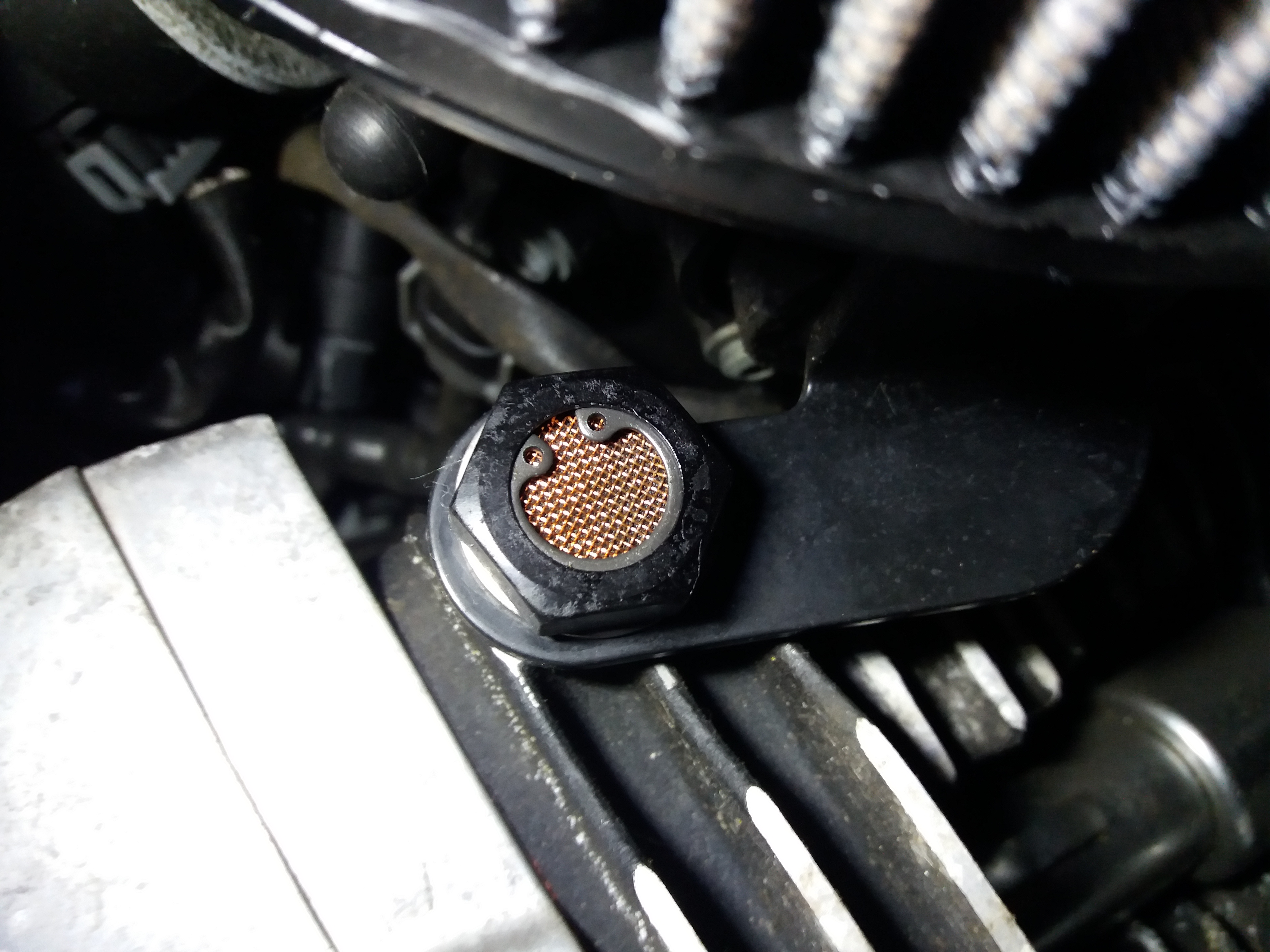

Get those breathers out in the open your motor is ment to suck clean fresh air in and breath out exhaust and oil fumes
Well that's my take on it both my Harley and asbo30 are running open breathers, the Harley has a fine copper screen in each rocker box, asbo 30 has the crank case breather running to a duck bill just above the rear chain, and the rocker box breather running to the rear of the bike
