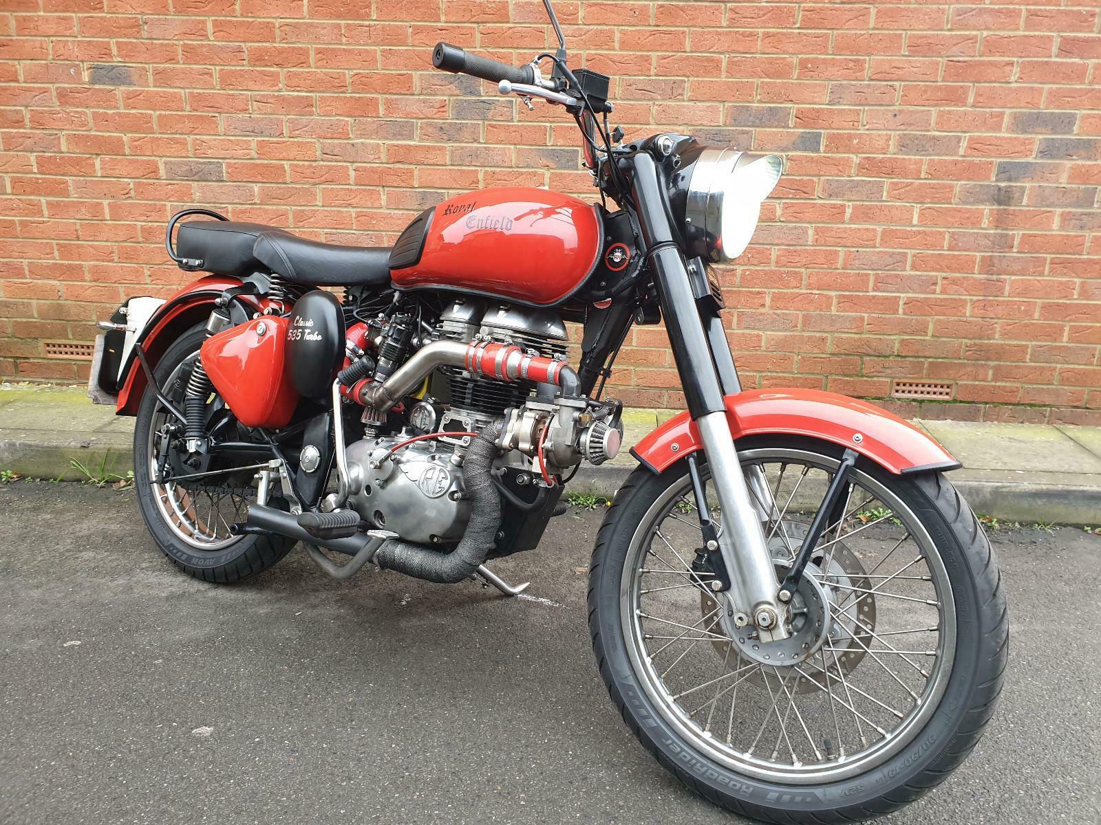

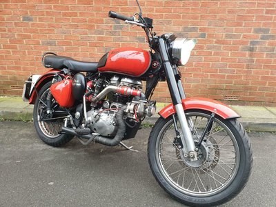

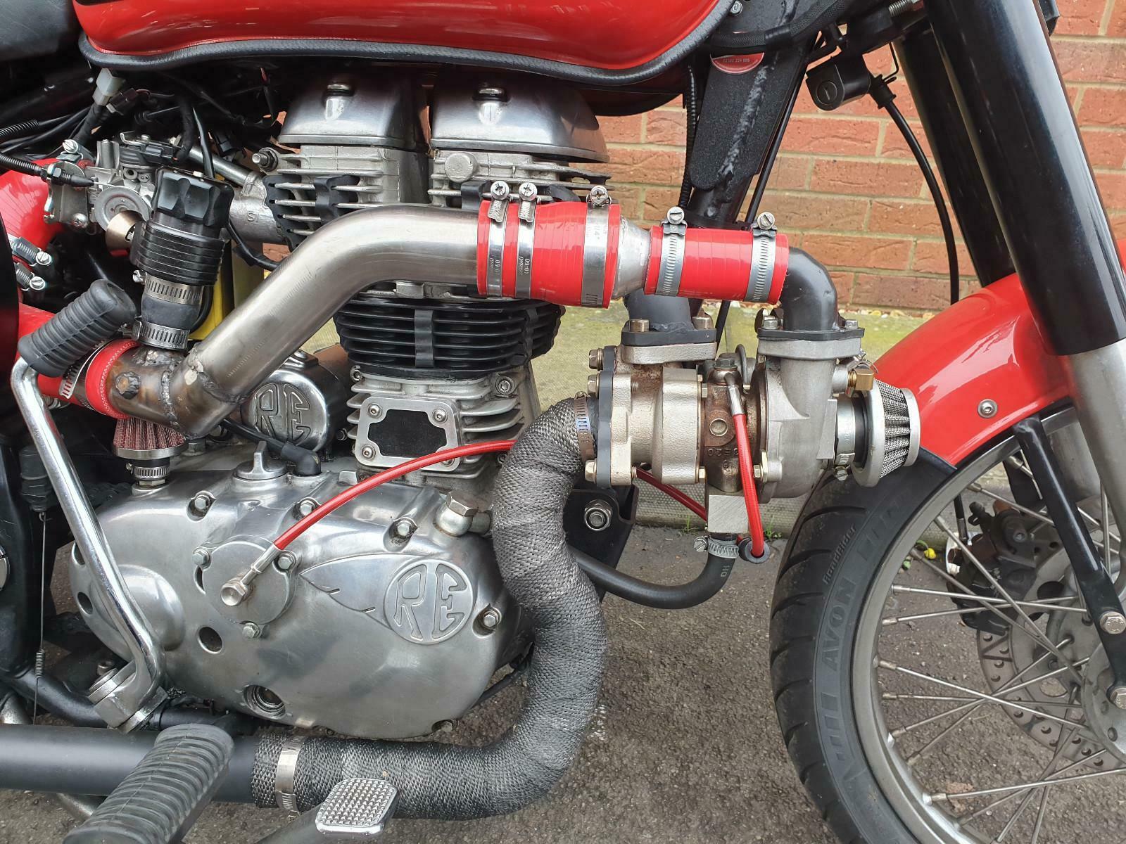

saw this for sale on that well known auction website.

Well it is certainly unique, but having looked on the link to the website it looks to put out roughly the same amount of power as a 612.
Not knocking it, just saying.

It looks like the steering will be restricted, at least as soon as the forks are compressed.

Sticking a turbo on is surely only part of the job. Won't it make the engine even more likely to go bang?
