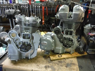

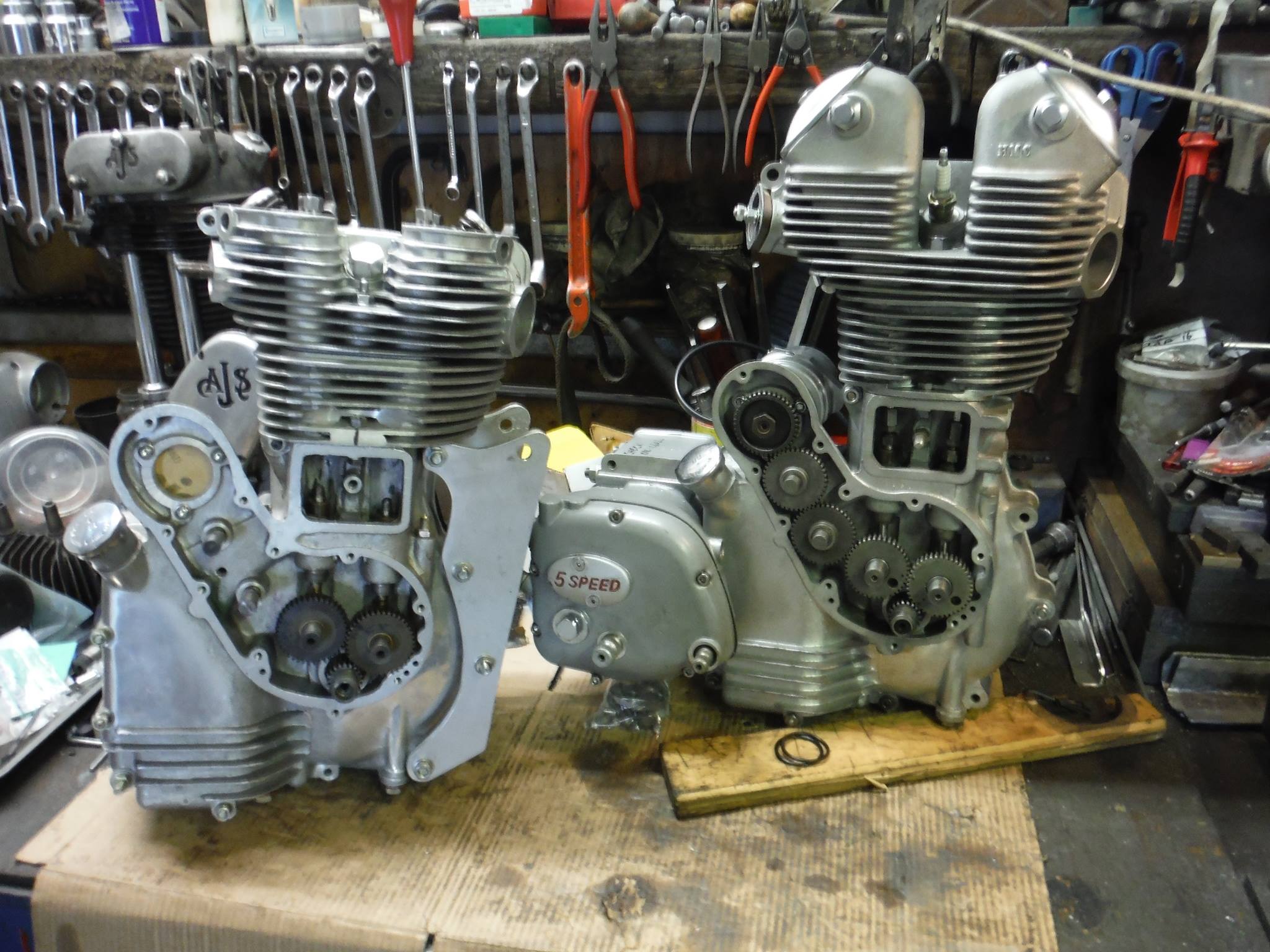

When Bullet Whisperer built the engine for mine he took a picture of it alongside another customer's 500 Bullet with the standard head, a good comparison shot. You'll have to imagine the rocker box covers fitted to the one on the left.

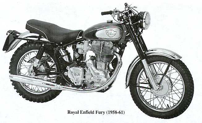

To be fair, the difference between those two engines in the picture above is exaggerated a bit by the barrel of the ordinary head type engine having been shortened by 1 fin. There are also benefits when tuning by using a big head, when in 'Fury' spec and our 350 racer - a 500 big head short stroked to 350 cc will rev to 9,500 rpm, wins races, won a championship in 2018 and broke and set set a new lap record three times during one race on Anglesey. It uses Fury sizes ports, valves and 1 1/2" GP carb, thanks again to the big head.

So, bigger ports and valves and more cooling fin area... thanks.
And it does look more attractive, too.
