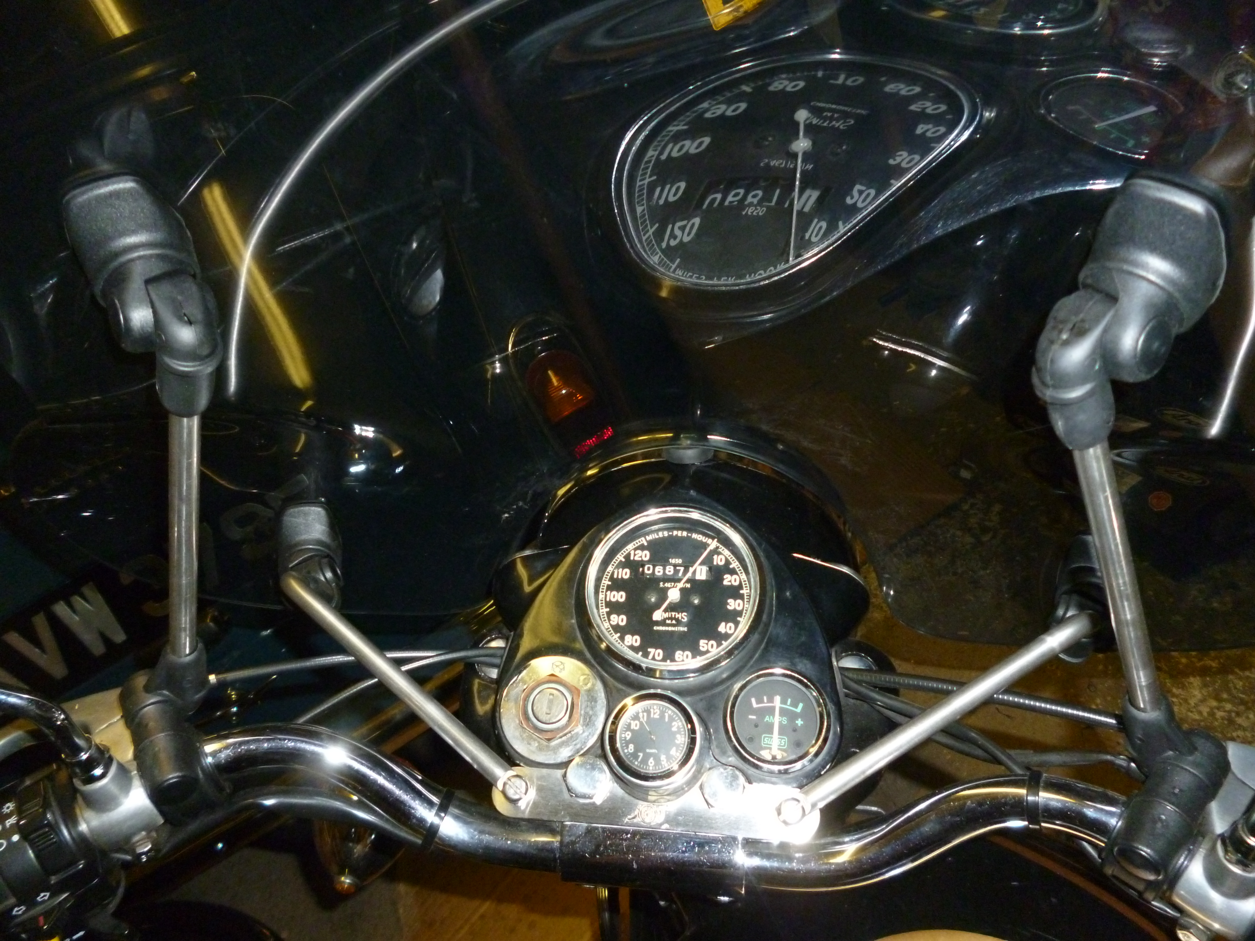

I don't, of course, know exactly what yours looks like.
However, I'll try to put a couple of photos on, so you might have a better idea.

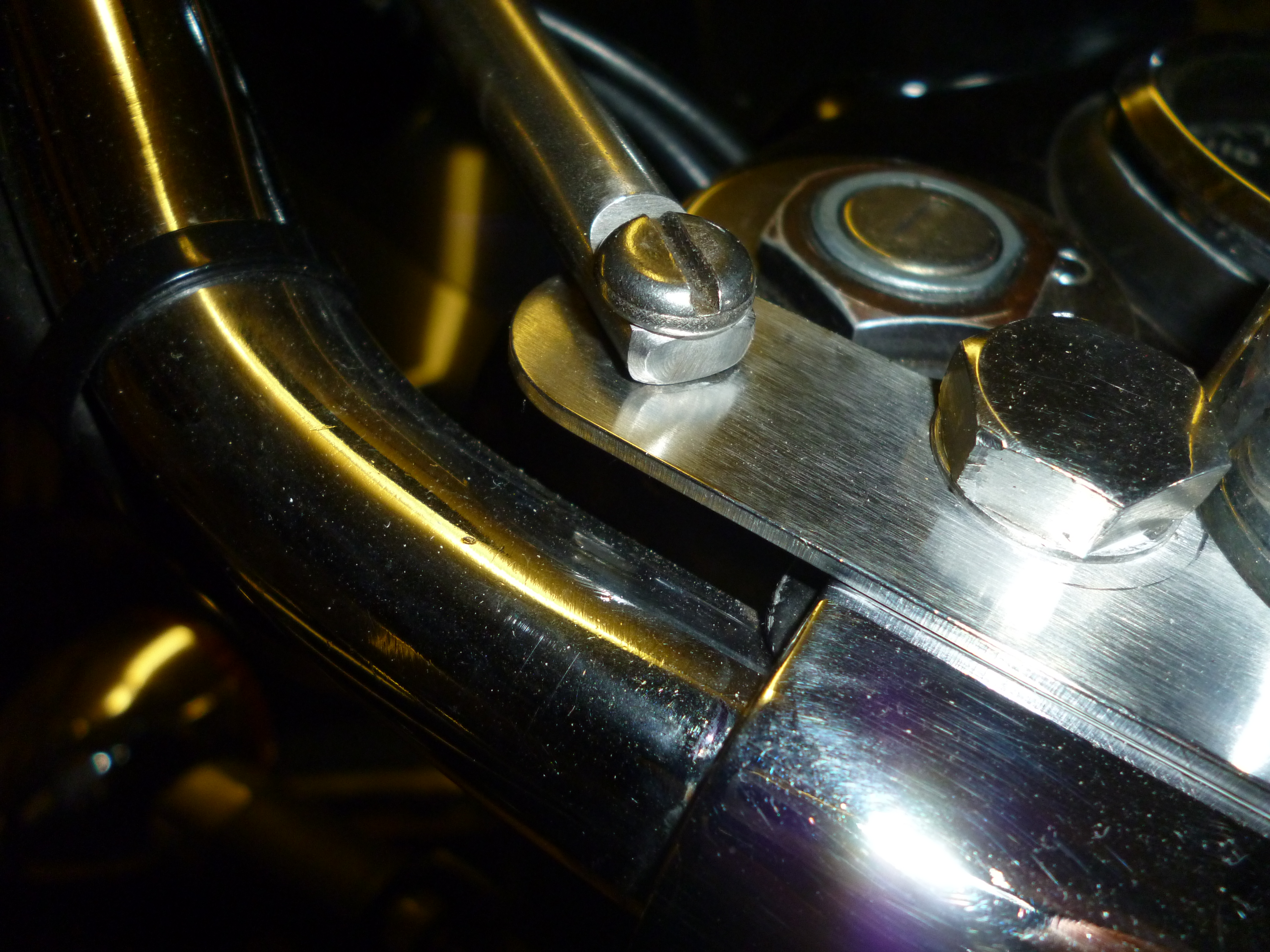

Mine uses the standard parts with one exception:
I didn't want quite as many plastic bits all over the bike. So, you'll see that I drilled through the ends of the two bars and ground them flat, using a non-standard bolt. (In the photo with the slot head.)
It may also be of interest to you that Hitchcocks supply the standard Givi fixing kit and also their own version for the RE.
Why not give them a ring and check?
Best wishes, Chris
#96703
Notes on the Photos:
1 The flat plate that Hitchcocks supply is very accurate, but you might want to very slightly reduce the sharpness of the edges. Easy.
2 I still need to find screws with just a bit smaller heads, when I get time.
3 The screen doesn't reflect the speedo as much as shown, in real life. A pity, really, as it looks like a Dali impression of the modern screen displays...

Haha, yes it does look a bit Dali. Your bars seem identical to mine cant see any serious differences so those pictures will certainly help. Thanks a lot. Dan
