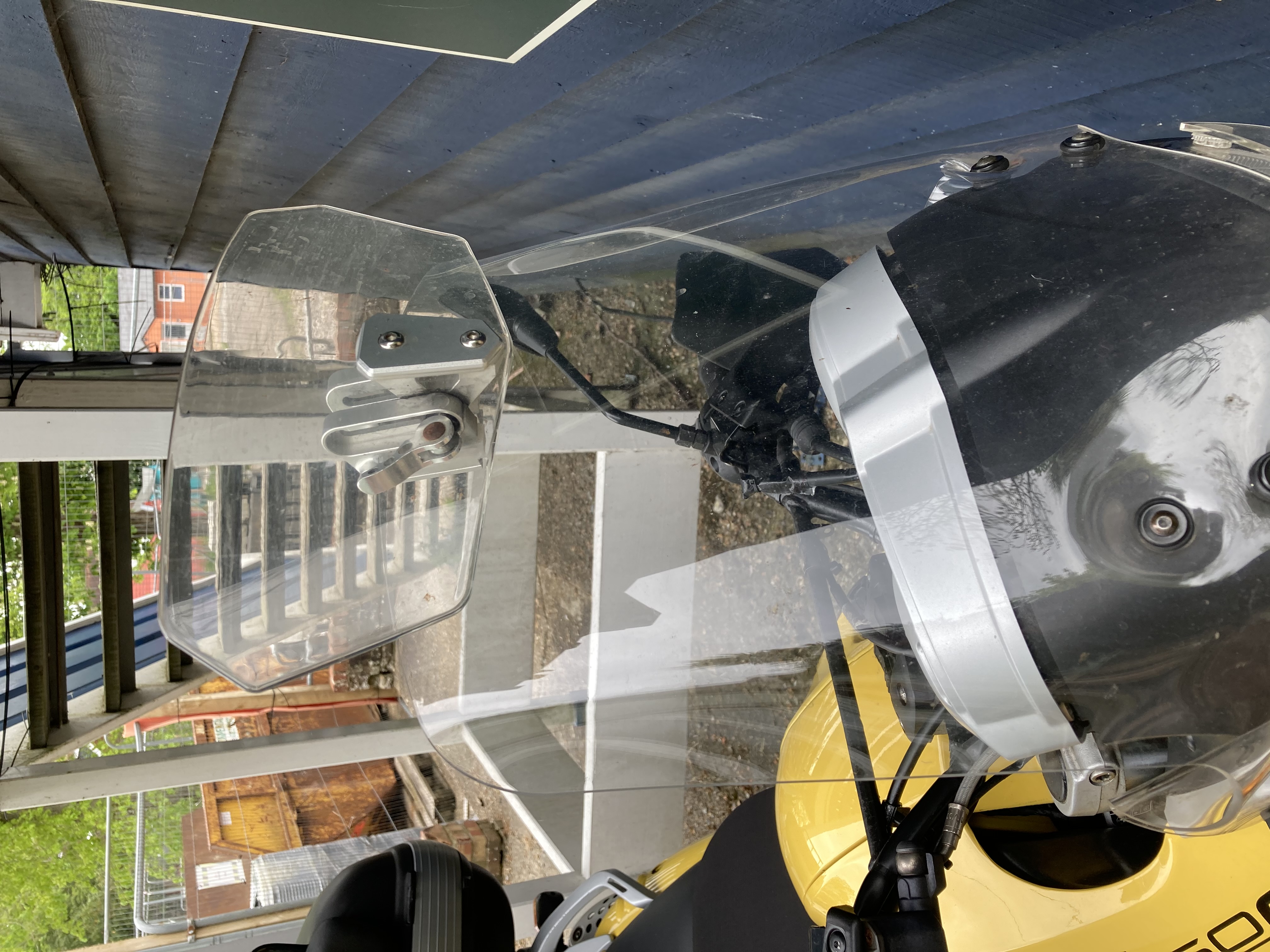

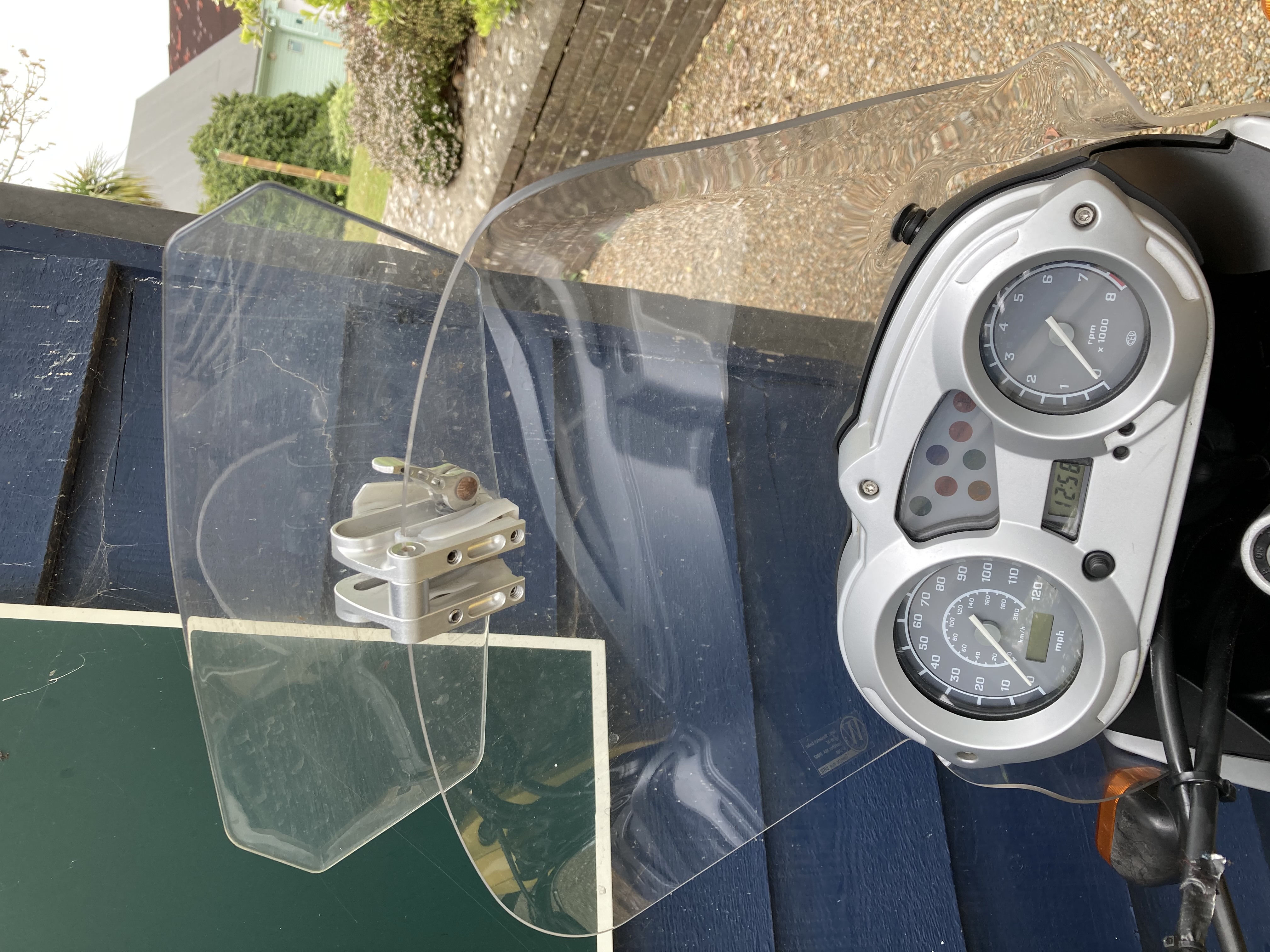

#96841
Ridden a lot of bikes and found screens to be a nightmare most of the time; except BMW R80RT, superb.
Buffeting isn't just screen. It can be exacerbated by type of helmet, jacket, height...
Anyway, up until two years ago, I would said it was very personal and down to the bike and rider to resolve. I now think the set up I have would work for you.
Taller screen with attached thingy; advanced technical English!
I had a slightly taller screen on my Translp which wasn't great and then under someone's recommendation, fitted what you see below. It worked beautifully. Strangely the deflector needs to be vertical to work perfectly!
My Transalp was written off in december and I transferred the deflector to my, new to me, F650GS. It works exactly the same as the Transalp; perfection.
I must stress that it works perfectly for me....
But, as the deflector was an eBay jobbie at £14, it was worth the gamble; a gamble that paid off.
By the way, deflectors....... I've had them all!
