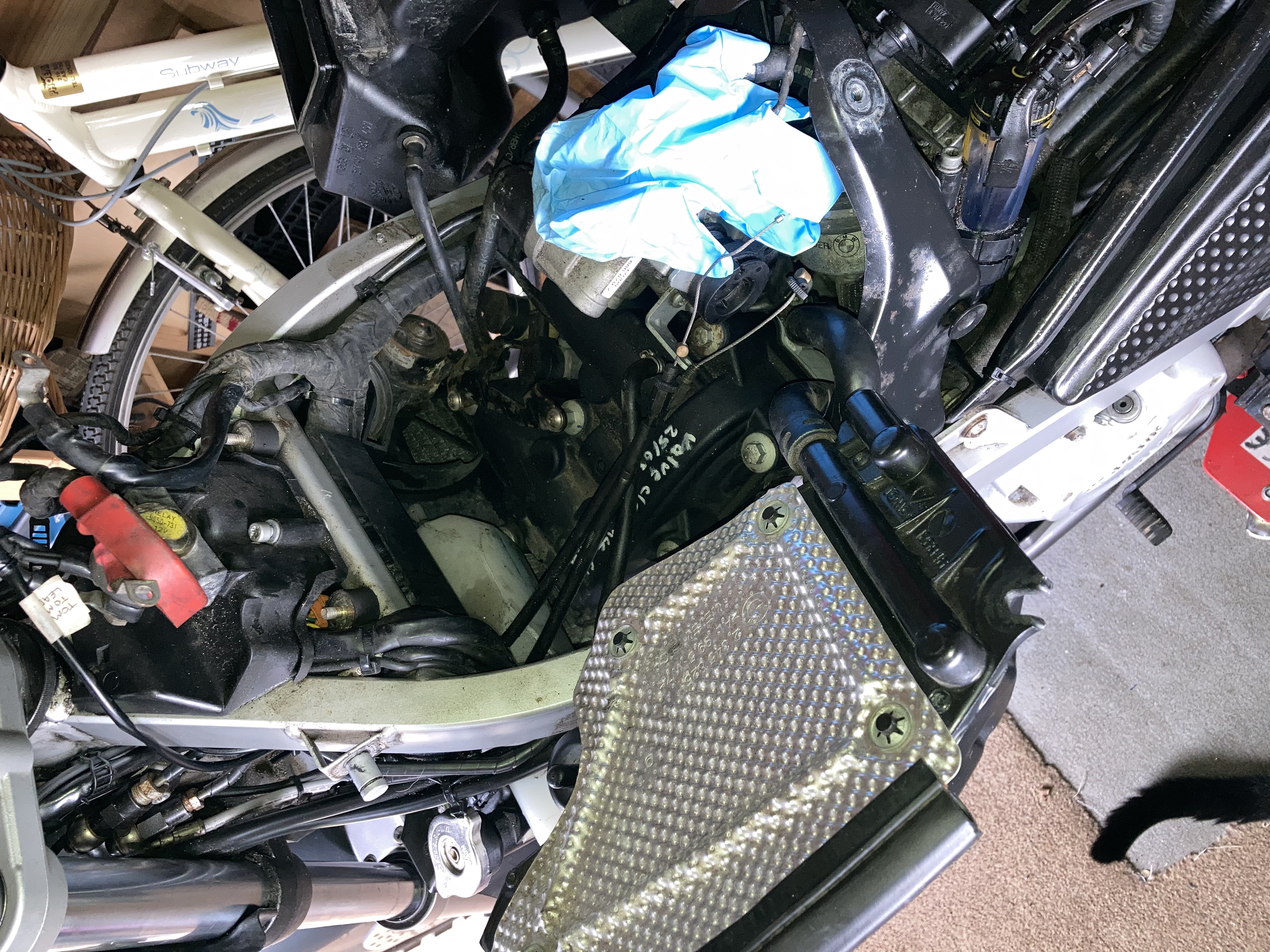

Going to check clearances on my new to me F650GS.
Note I haven’t taken the valve cover off yet...... but to get to this point...
Remove windscreen, six screws.
Remove four screws for left-hand indicator then disconnect it.
Remove four screws for right-hand indicator then disconnect it.
Unscrew left-hand fairing and remove.
Unscrew right-hand fairing and remove.
Unscrew centre fairing panel and remove.
Remove battery.
Unbolt oil tank and move out of the way.
Remove breather snorkel and then air filter.
Unbolt airbox and move out of the way.
Dislodge starter solenoid.
Disconnect throttle cable.
Unbolt and remove battery carriage.
Remove solenoid tray.
And then....... The valve cover is visible.
There might be more, but I needed a rest :roll:
