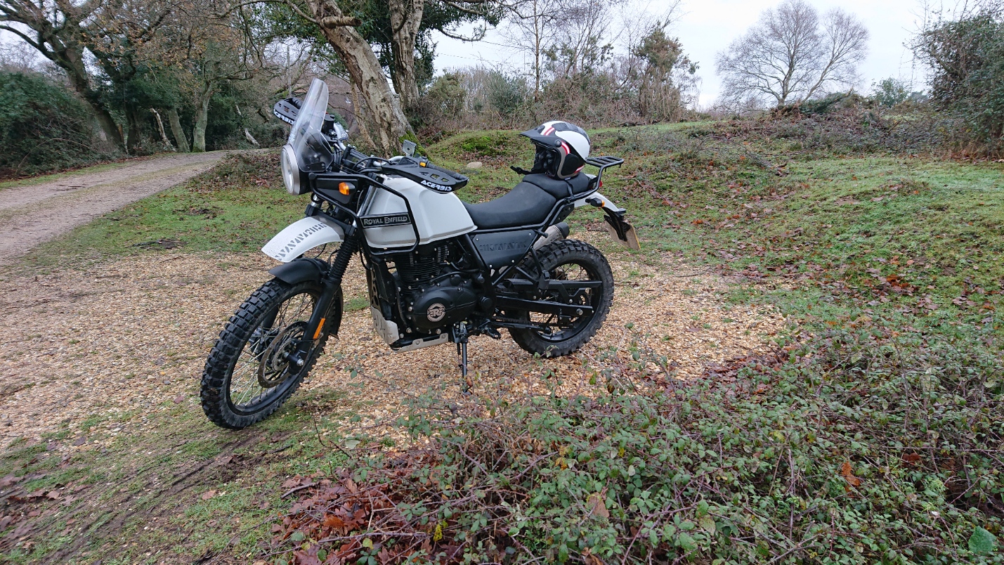

#94549
Only a few weeks into my Himmy ownership and Christmas prep, Covid and a week one drowning of the bike have limited mileages to just over 200. The bike was nearly new to me and still hasn't quite reached the 1,000 mile mark so still a way off being ran in but I've not experienced any cutting out, misfires or the like yet (apart from when I drowned the poor thing!). I do have a 2008 efi 500, the very first of the UCE motors, so am used to Enfield ownership and, so far, the Himmy, feels like a quantum leap forward, even if not quite as 'peppy' as the UCE.
The mods I have are:
Complete ACF50 of the bike - twice! along with silicon grease for terminals and electrical plugs
Greased rear linkages and headstock bearings
Conti Twinduro tyres
YSS 10mm longer shock
Shock tube
Flexible number plate
Lowered the forks 5mm in the stantions
Front mudguard risers
Acerbis bush guards
Hitchcocks shorty levers
Hitchcocks 'performance' air filter
Hitchcocks rubber clutch lever/cable guard
NGK spark plug
Pushbike mirror replaced the originals
Cable tied tops of fork gaiters to keep them in place
Phillips uprated headlight bulb
Gloop tyre sealant added
Keis heated jacket/battery tender lead fitted
Oxford heated grips
relocated temp sensor (still reads a bit high so have Hitchcocks extended cable to allow me to relocate near headstock)
I have the Hitchcocks air delete kit and a second hand (like new, done 200 miles only) Lextech silencer to try as well but want to get a feel for the bike as is before I fit them.
Further mods/additions I have in mind is to get the seat modified with a gel insert and slightly higher position, chop the screen down, pull strap (Kriega or similar) on the front yoke, waterproof roll bag for one front pannier (Lomo or similar) and a fit a tool tube somewhere. Again those can all wait (with the exception of the pull strap) until I've put some miles on the thing. I like it so far, it is was it is and seems the perfect bike for the cr*ppy weather we have at the moment.
