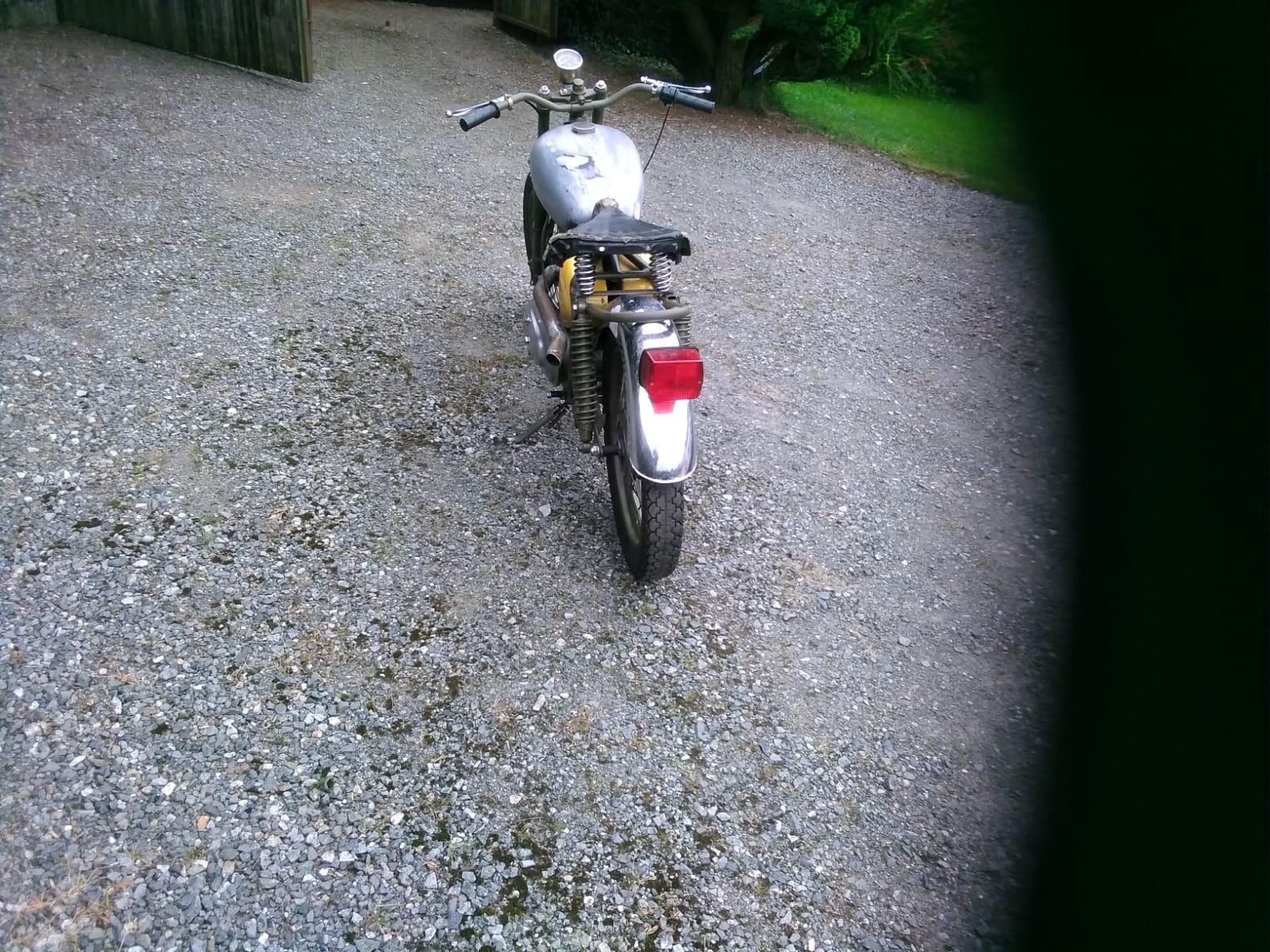

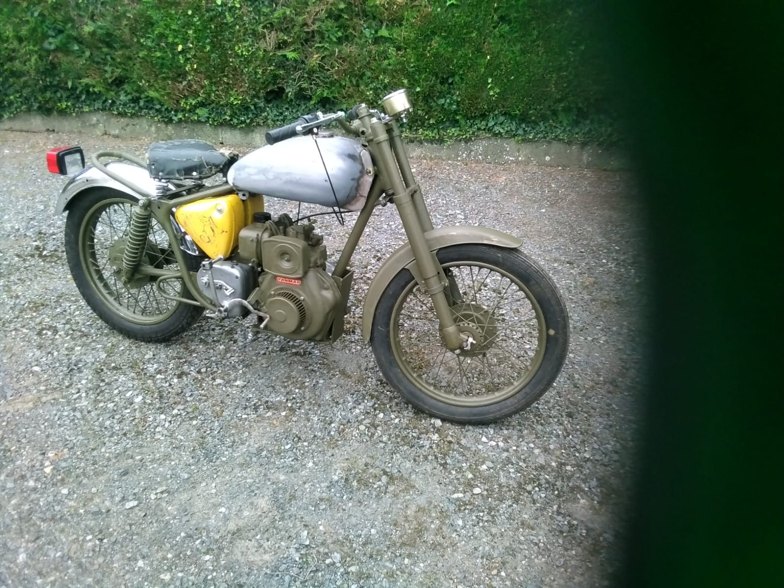

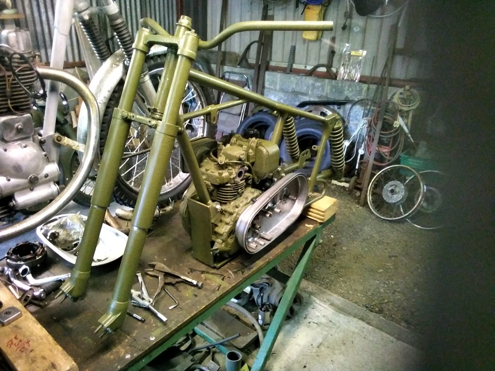

Me and friend decided to build Royal enfield Crusader Diesel with what ever parts lying in our sheds , Back garden in my case.. still need to do rest of bits. let us know yr thoughts on that ?
Bike Specification:
Frame. Royal Enfield Crusader 1960s
Engine: Yanmar diesel 4HP 211CC ( Raw )
Forks - 1947 RE Model G
Shock absorber. unknown. just flipped the swingarm to fit long shock.
Electrics/carb : No alternator/carb ,, just default injector. .
Start type : Pull and go :-)
Smoke type : Black.
Builder: Brian Hackett

You probably need to ask Yanmar's marketing department. Sounds like the usual management buzz-word salad.
Not a bad attempt at a diesel bitsa if it all lines up OK and the gearing is right.
I dig the Model G forks, but those yellow toolboxes from an Indian Bullet just look wrong there. Originally you'd be looking at this sort of thing with the appropriate lids.
https://accessories.hitchcocksmotorcycl ... lter/41393
But does it even need any tool boxes?

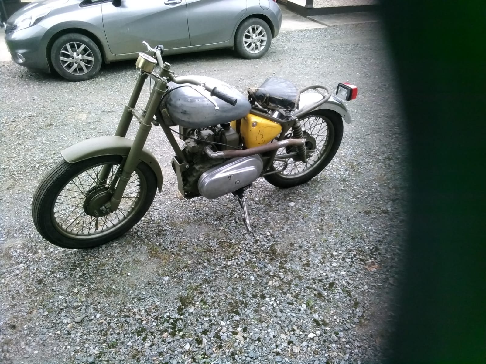

Thanks trophyvase/Adrian for your feedback.
The bike is build from parts thrown around. The work shop and when finished it will be all green. :)
