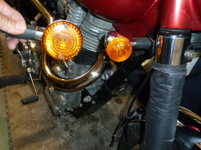

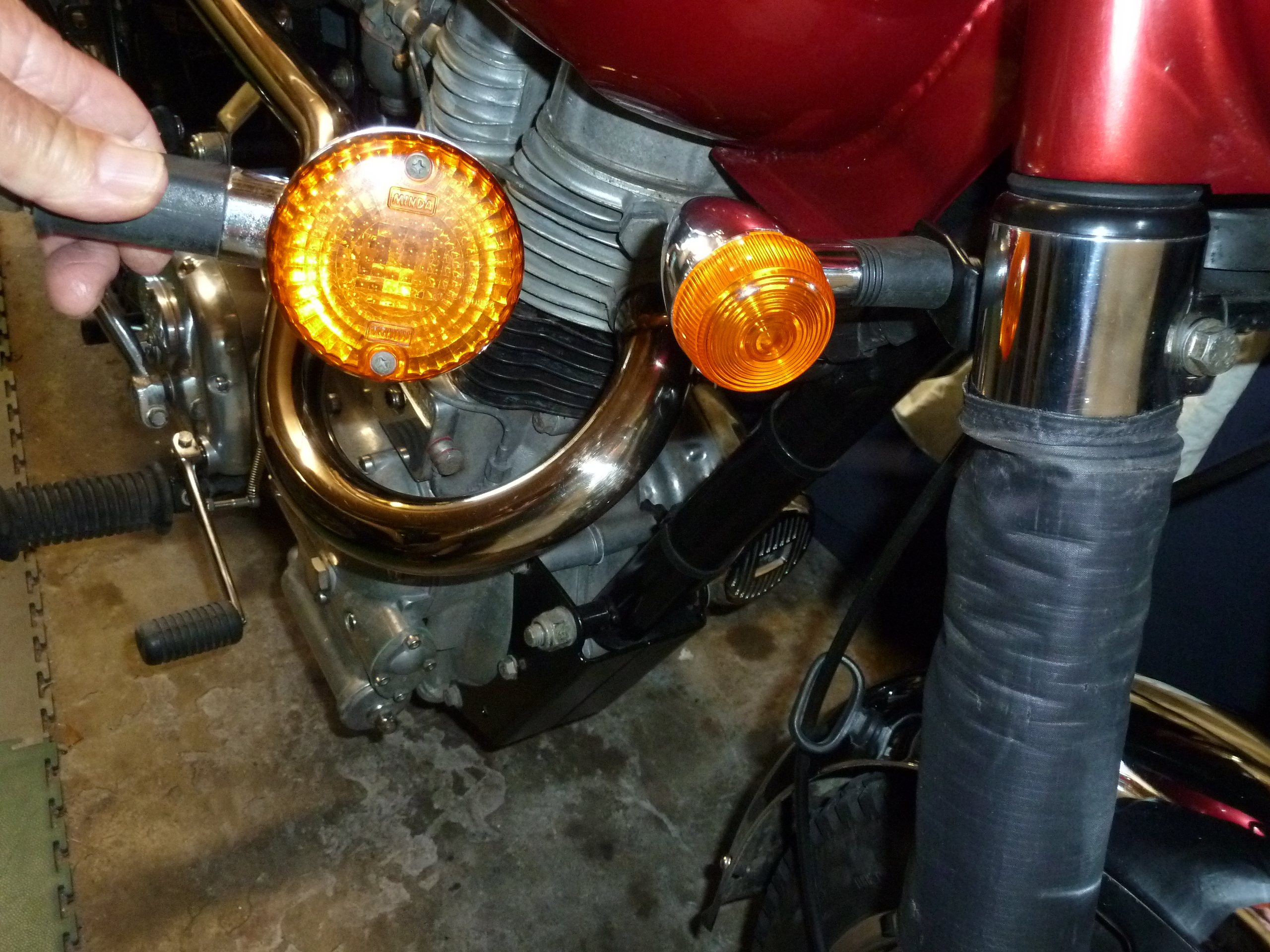

Only time I’ve had a problem was when I dropped the bike onto a grassy bank on the right side of the trials section and my leg was against the pipe ; it did melt my waterproofs a bit! Otherwise there’s about three inches of clearance. I might buy a metal heat shield from Mr H.
I’m not a fan of wrapping pipes after I had an issue with trapped road salt rotting through an expensive four into one manifold I’d had made for my trials car after only one winter. I had a replacement stainless exhaust made by an expert friend of mine and he told me off and said that trapping heat in the pipe with wrapping can also make the steel go brittle. He guarantees his own exhausts for life but won’t if they’re wrapped! He is very well known in the vintage and classic car circles (he also made the exhaust stubs for Rolls Royce’s own Spitfire). He has been making his living doing this sort of thing for fifty years so I take notice of what he advises.
