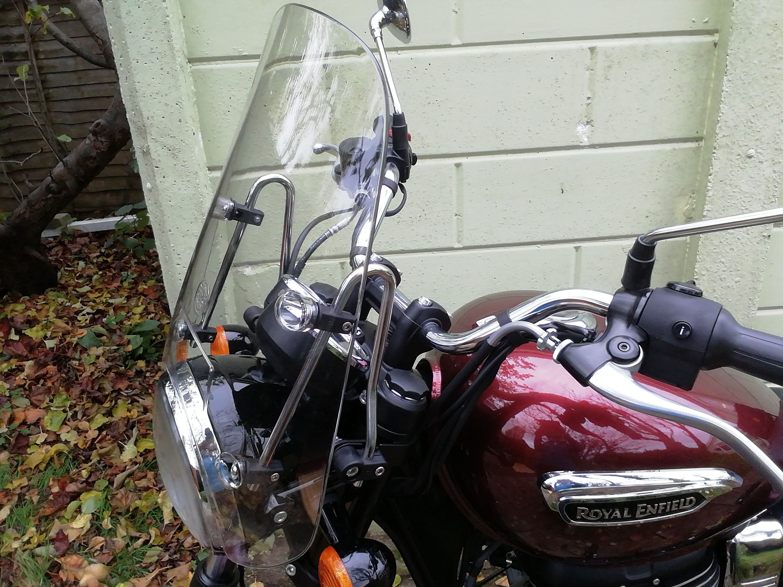

Just fitted the RE touring screen to my Stellar. I could have saved myself time and effort, not to mention a bit of cash, by getting the Supernova in the first place, of course 😂.
However... Thanks to Messrs Hitchcocks, putting the fitting instructions at A4 size on their website it all went smoothly - the instructions that come with the screen need a magnifying glass to read them. Ordered from Hitchcocks Thursday pm. Arrived Friday!
Gave it a trial run out under gusty conditions and very impressed.
You do need four different sized hexagon wrenches (we used to call them Allen keys) to fit it and I've popped them into the little toolkit - just in case...

Took the Stellar out for a much longer run this morning and any misgivings I may have harboured about having a screen were quickly dispelled. Bike handles exactly as before but I no longer have a gale blasting at me!
