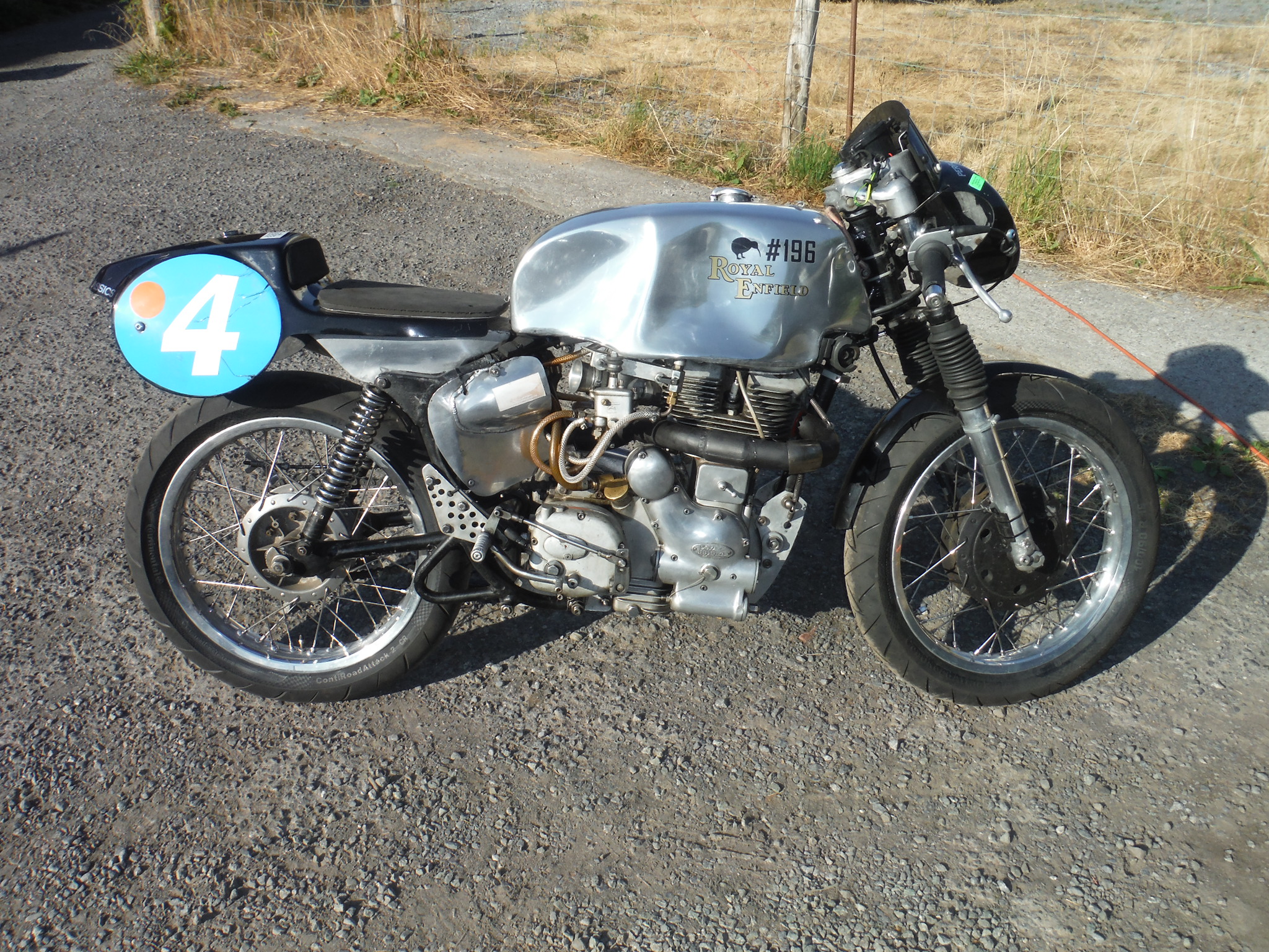

Just to redress the balance, then. This won the 2018 BHR Pre '62 350 cc Championship. It has won countless races, including a 500 cc race when it stood in for our larger RE racer and it set a new pre '62 350 lap record on Anglesey, breaking the previous lap record, set by a fast rider on an AJS 7R, three times in the one race. It is quite light, but could be lighter. There is a SMALL amount of Titanium on it [nothing much] and strength always takes preference over light weight where necessary. The rev limiter is set at 9,500 RPM. There are also other RE machines owned by the Linsdell familly, which have achieved much more than our machines. Not all RE's are slow and heavy!
