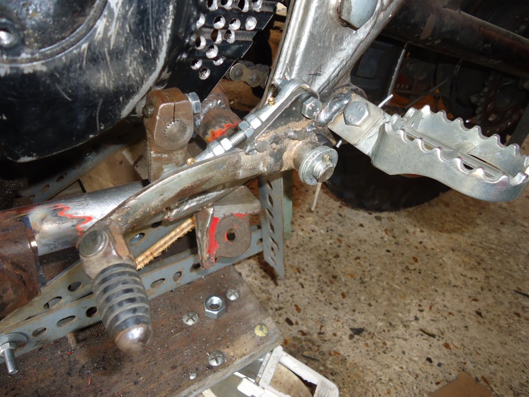

Leaving the gear lever that far from the footrest is not something I like; I prefer to keep my feet on the pegs when changing gear, especially if you’re stood up on the pegs. On the pre-unit engines with the right shift, there’s a lot of clutter in the way to move the gear lever closer to the footrest so I can see why they didn’t bother.
I’ve moved the gear lever closer to the footrest on another project involving a GS500 engine. The linkage in the photo is ‘upside-down’ because the gear shaft on the GS500 rotates clockwise for first gear and so on. Anyway, you get the general idea, which is what I’m doing on the Electra and fabricating a folding gear lever.
