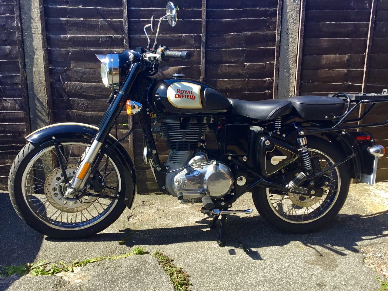

Six hours old, well, six hours since the PO dropped him off to me.... Meet Gordon.
One missing screw from silencer cowl, plus another half out. Removed the three that were left , lubed, replaced plus the missing One. Passenger foot peg obviously drops down when riding , so removed both, fitted a washer to take up the slack, perfect.
Adjusted clutch cable, lubed chain, checked over, going out for my first ride in half an hour :mrgreen:

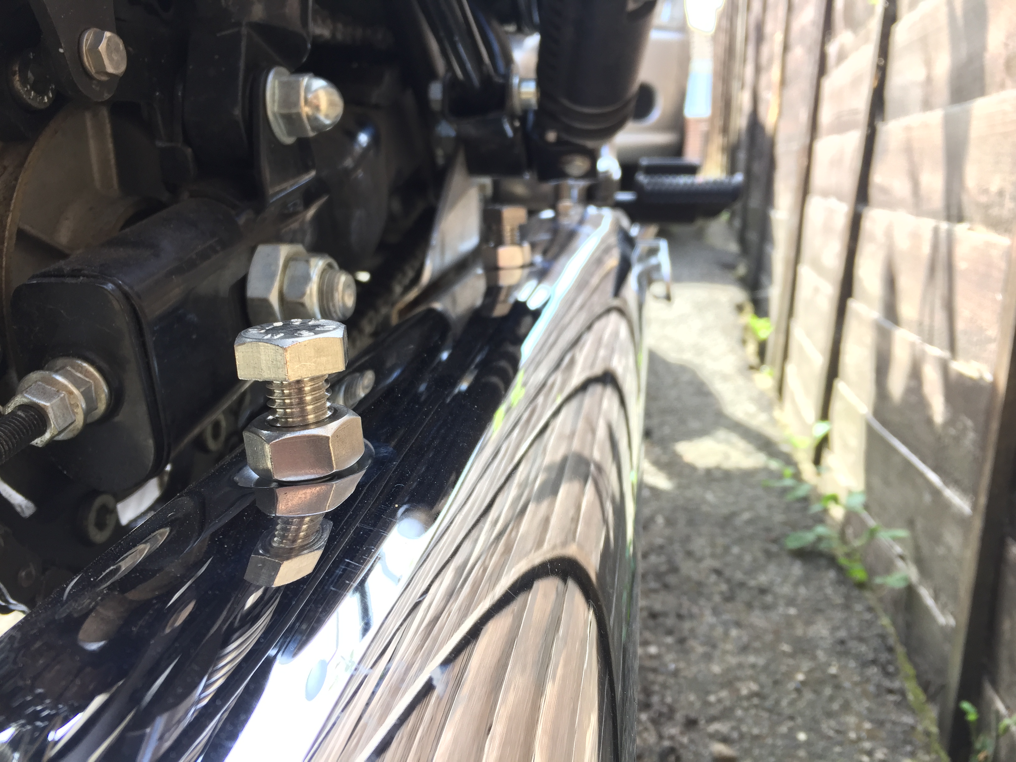

Well, just got back from a reasonable ride. Half way along, the telltale sound of loose tin ware.
Stopped, all four bolts loose!. Nipped them up.
Got home.... two had gone and two loose... another few miles and any cars behind wouldn’t have been happy with a four foot cowl hitting them :shock: :D
Just fitted four slightly longer bolts with spring washers.

I hope these M12 bolts are not overkill....... :mrgreen: :mrgreen:

#91520
Nah, can you weld? :D Mine had a thin wire foot guard thingy pop riveted to it. You can guess what happened. I took it off when the first rivet failed. It got in the way anyway. If I were you I’d leave the original silencer on; I don’t think it’s worth messing with a Euro IV other than panniers, screens and what the Yanks call farkels. It’ll probably run fine as it is.
