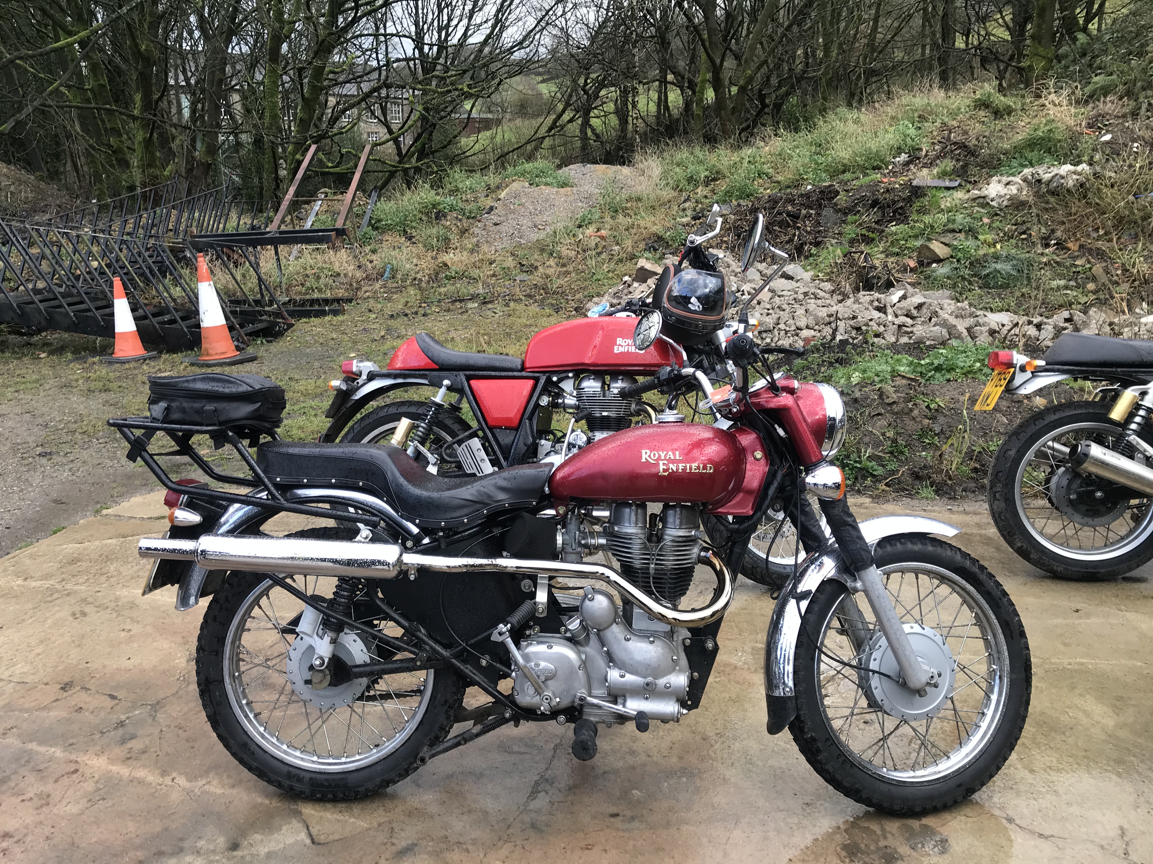

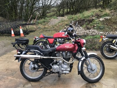

The bike is now just about as I intend it to remain ( = I can't afford to spend more time and money on it).
(That's Andy A's bike behind it).

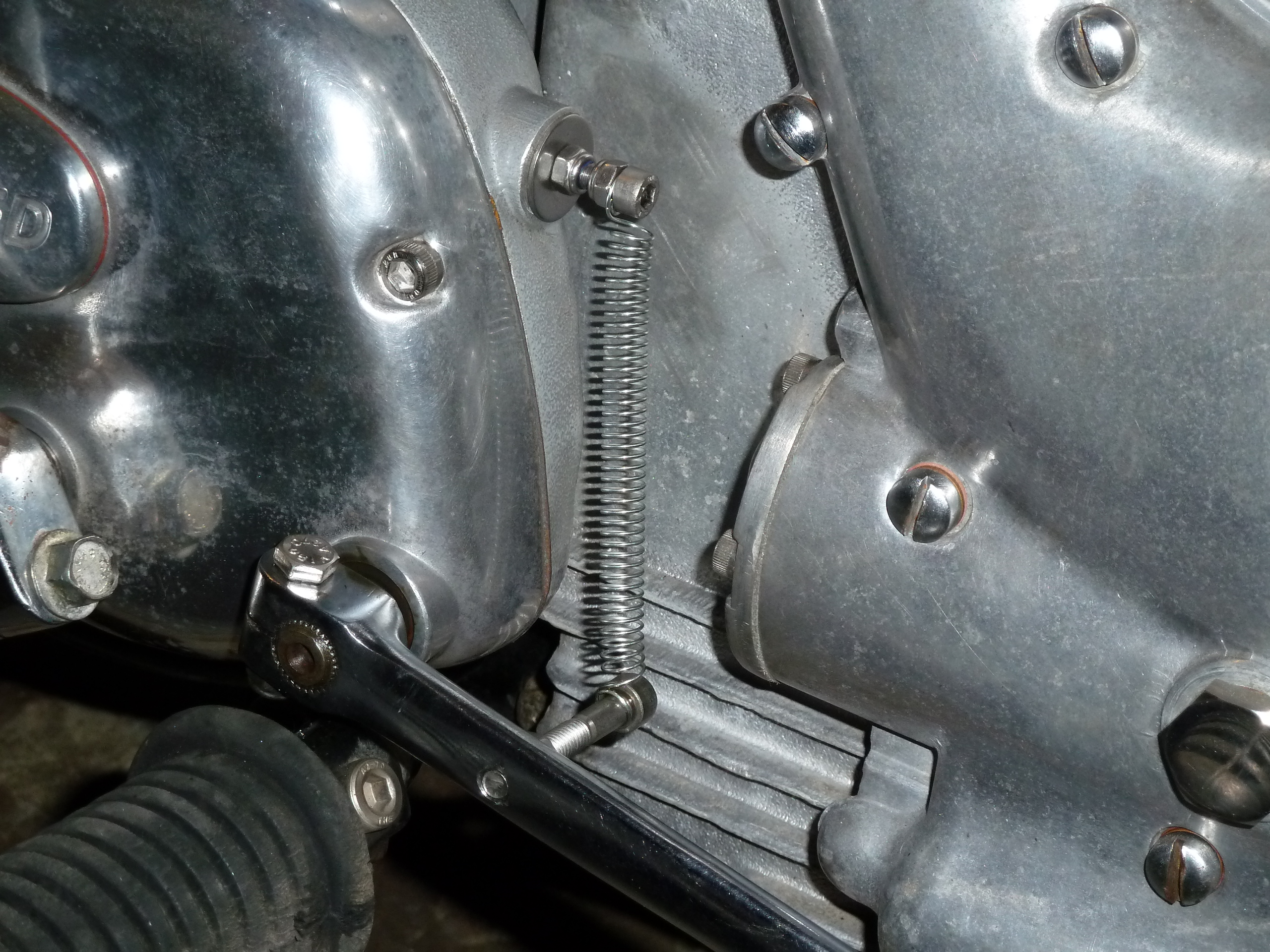

The new return spring in the 5 speed gearbox didn't cure the fault of the selector lever not readily resetting to allow the next down change. I got annoyed at a few too many embarrassing moments after having to stop at junctions and trying to pull away in third, which doesn't work very well on a 350!
It was almost as if the weight of the gear lever itself was just slightly too much for the return spring to reset but the slightest touch upwards by hand would reset it so the next lower gear could be found by pressing down. But doing this on the bike sometimes resulted in an upwards gear change, the opposite of what I was trying to achieve! I decided to think around the problem. I couldn't see how a stronger return spring could be fitted inside the box, so I decided to design and fit one on the outside!
I've since fitted two identical springs, one inside the other. The only "permanent" thing needed was to drill and tap a hole in the selector lever. Everything else can be removed in a couple of minutes. Job done, the springs reset the lever so the gearbox now works perfectly. I've since protected the springs by fitting a piece of soft plastic tubing over them. My boot doesn't touch them as they are tucked back inside the gap between the two casings.
An added bonus is that the thread in the exposed gear shaft in the casing is protected from road dirt; I fitted a matching screw and washer on the other end at the rear of the gearbox for that reason.
