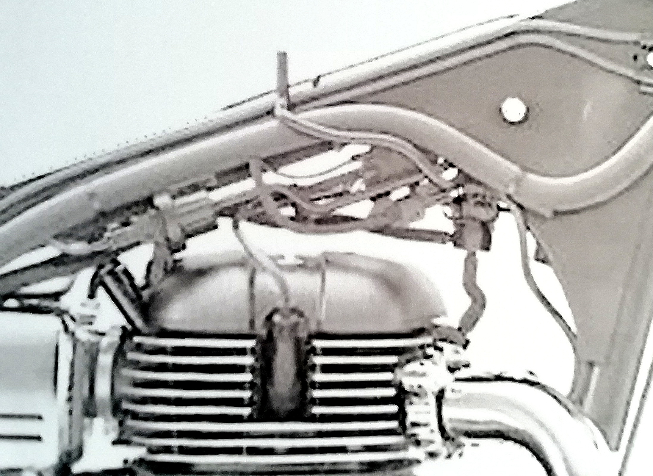

I also noticed that the cylinder block is not magnetic so must also be alloy like the head ,no doubt with a steel liner.
Trying to determine how the oil supply gets to the rocker arms no outside line so it must have internal passages and returns to the crank case by the timing chain chamber.
The engine is referred to as air /oil cooled assuming that’s because it looks like there’s a couple oil jets that spray the piston and some other parts.
Can’t determine what method this engine uses to relieve
crank case pressure does it have a timed breather like so many engines of this type use? Perhaps it gets by without that by venting to the airbox and some type of one way diaphragm valve.

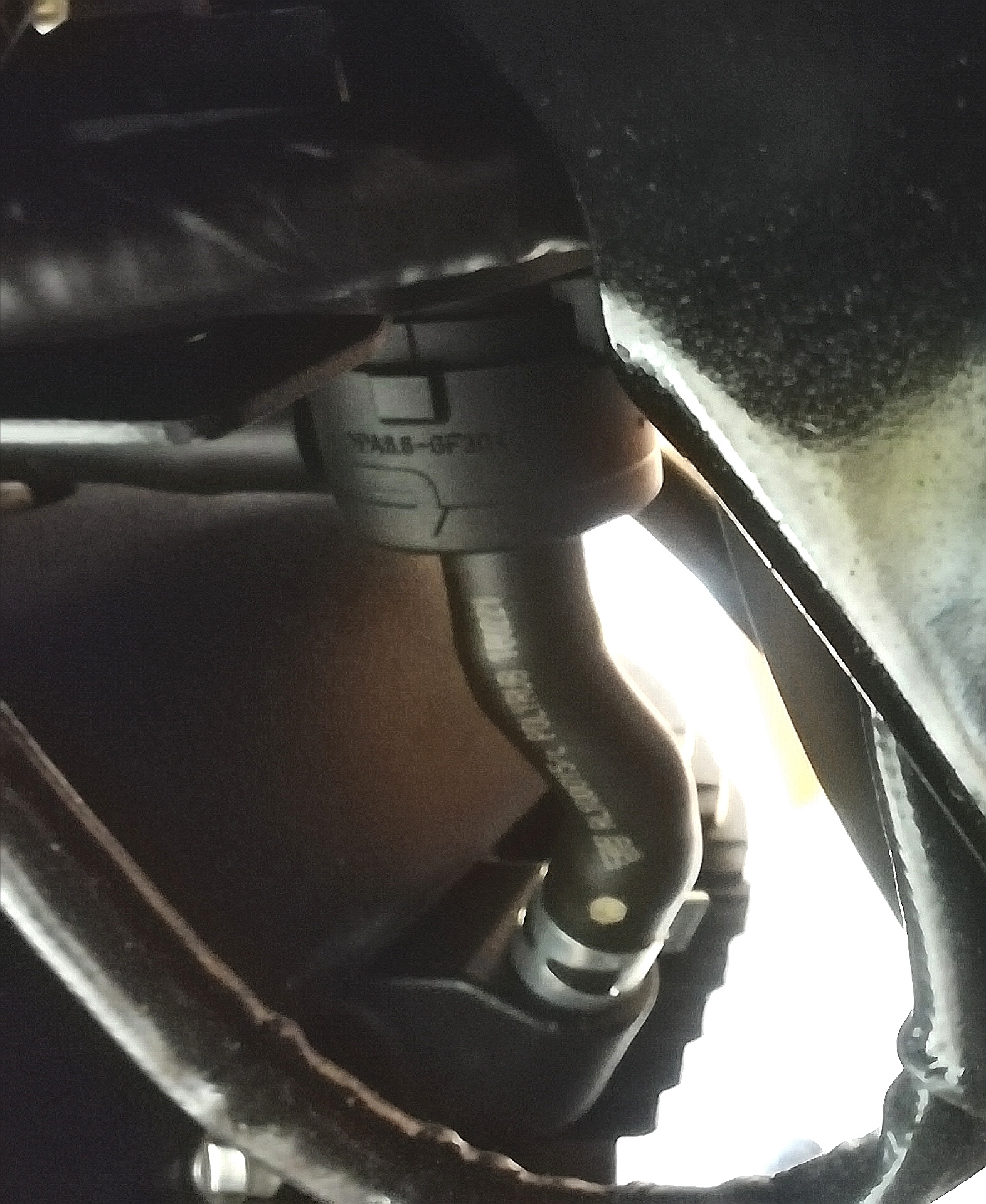

See the method of crankcase breathing now on the cylinder head diagram . Uses a reed valve.
Curious about the indexable camshaft sprocket that has 3 bolt slots to vary the valve timing?

Ah yes, Sam. The reed valve assembly is Item 11 on the drawing of the cylinder head. Appears to be venting into the evaporative system part of the fuel tank at the front.
Like you I was interested to see the valve timing adjustment - simple yet effective.
