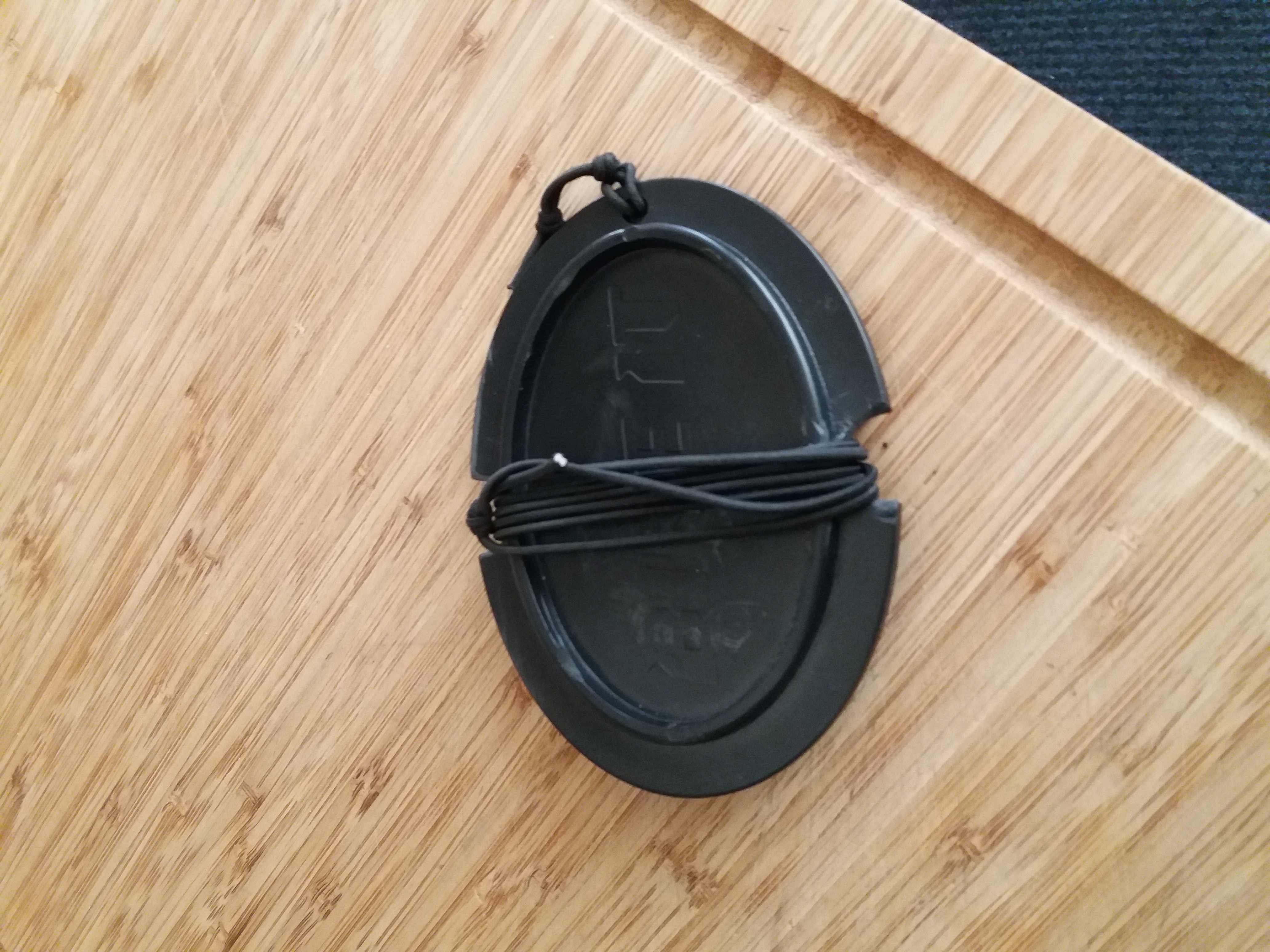

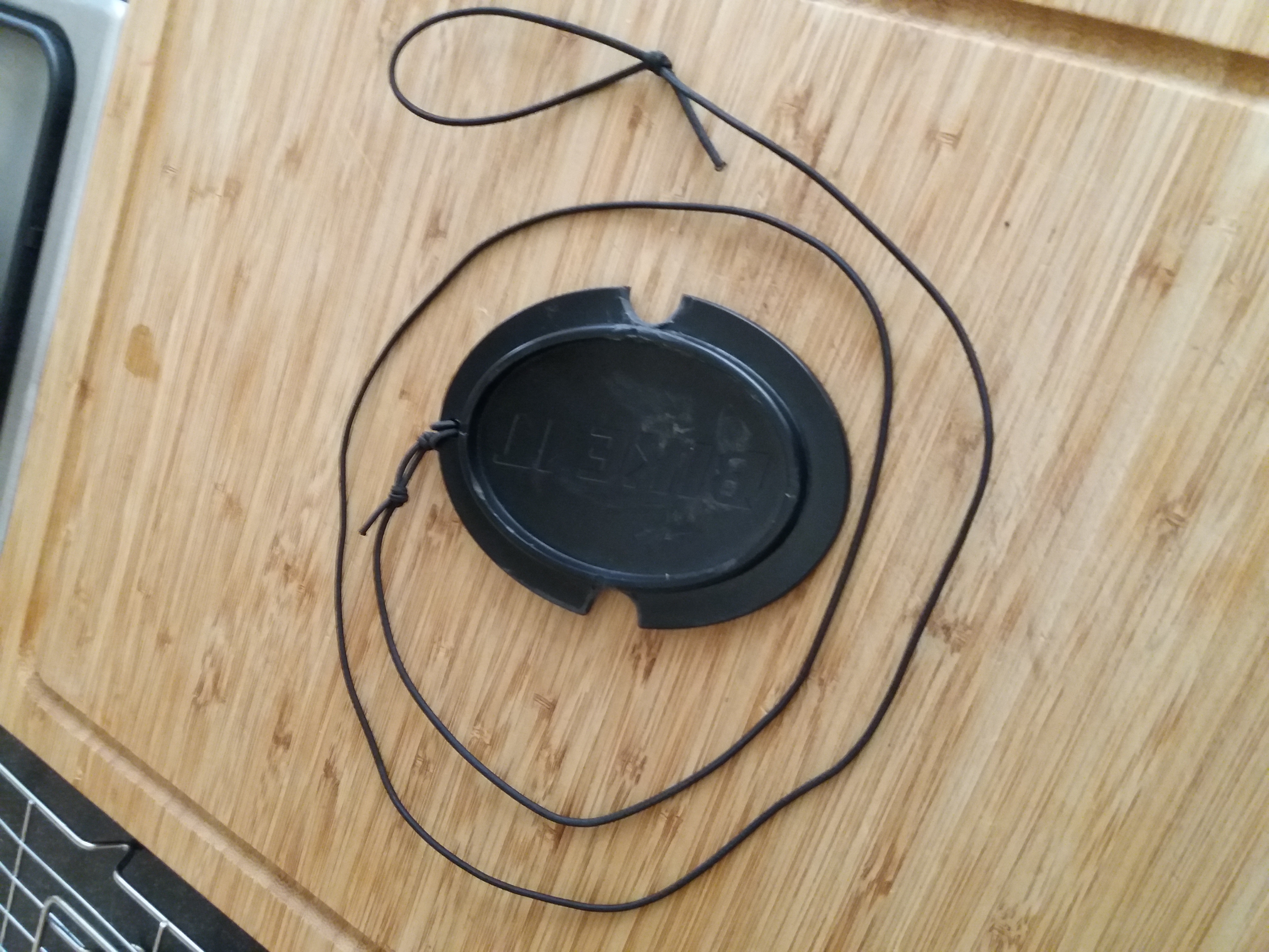

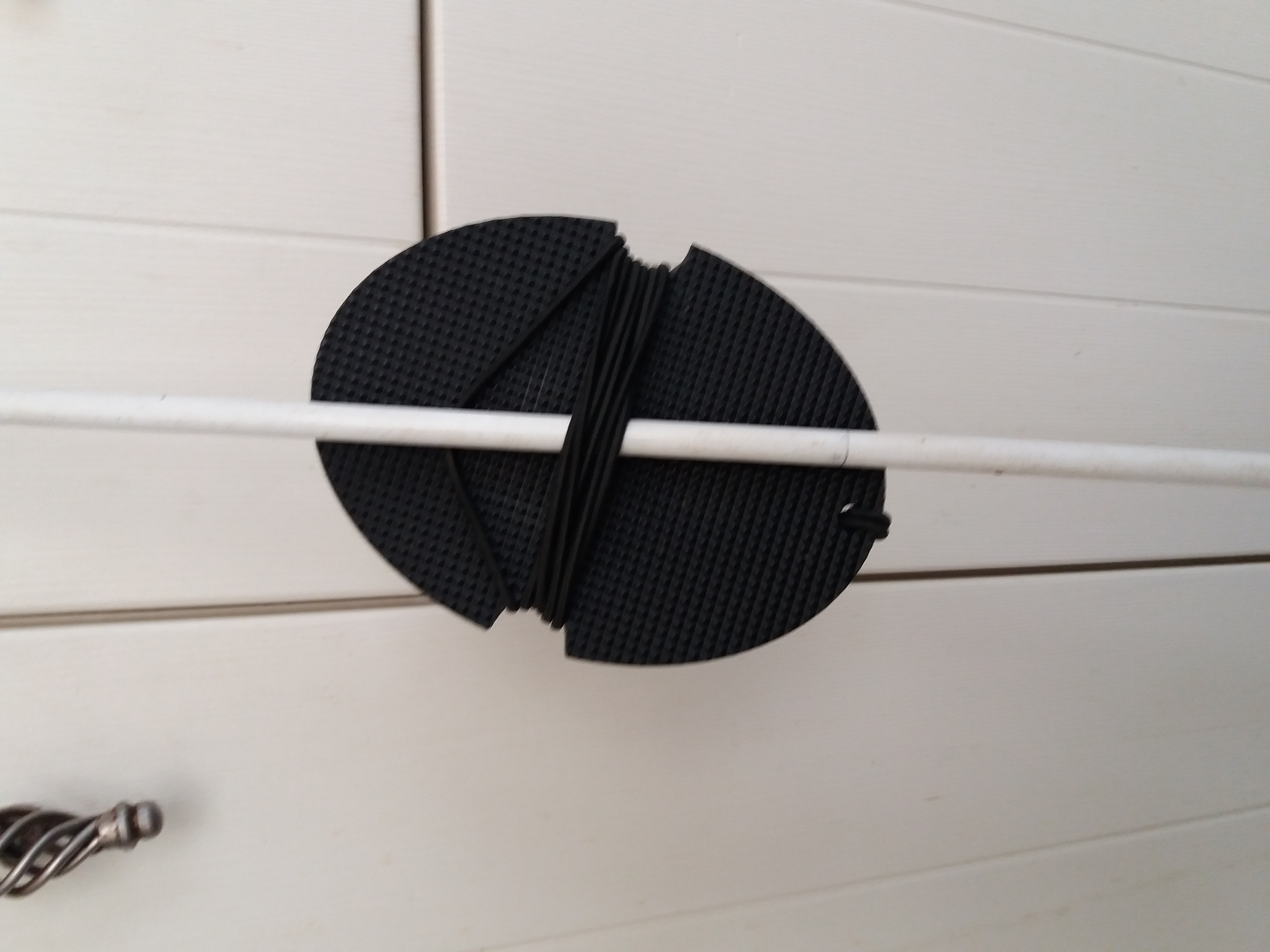

Here's my answer to the problem
Drill a small hole at one end of the pad and make a recess on both sides of the pad I used 15mm copper pipe heated with blow torch,
Next I used about one and a half meter of three mm bungee cord tie a loop at each end one small just to attatch the cord to the pad the other loop just tie to fit the recesses you have made in the pad
When finished you can wrap the cord round the pad slip the loop over one end to keep it all tidy
You can keep it in your pocket and not get tangled up or you can attach it to your bike
Use it just like you would use a beer can under your side stand but slip the bigger loop over one of your hand grips
If this helps stop one bike from hitting the deck it was worth putting up
Cheers Dai

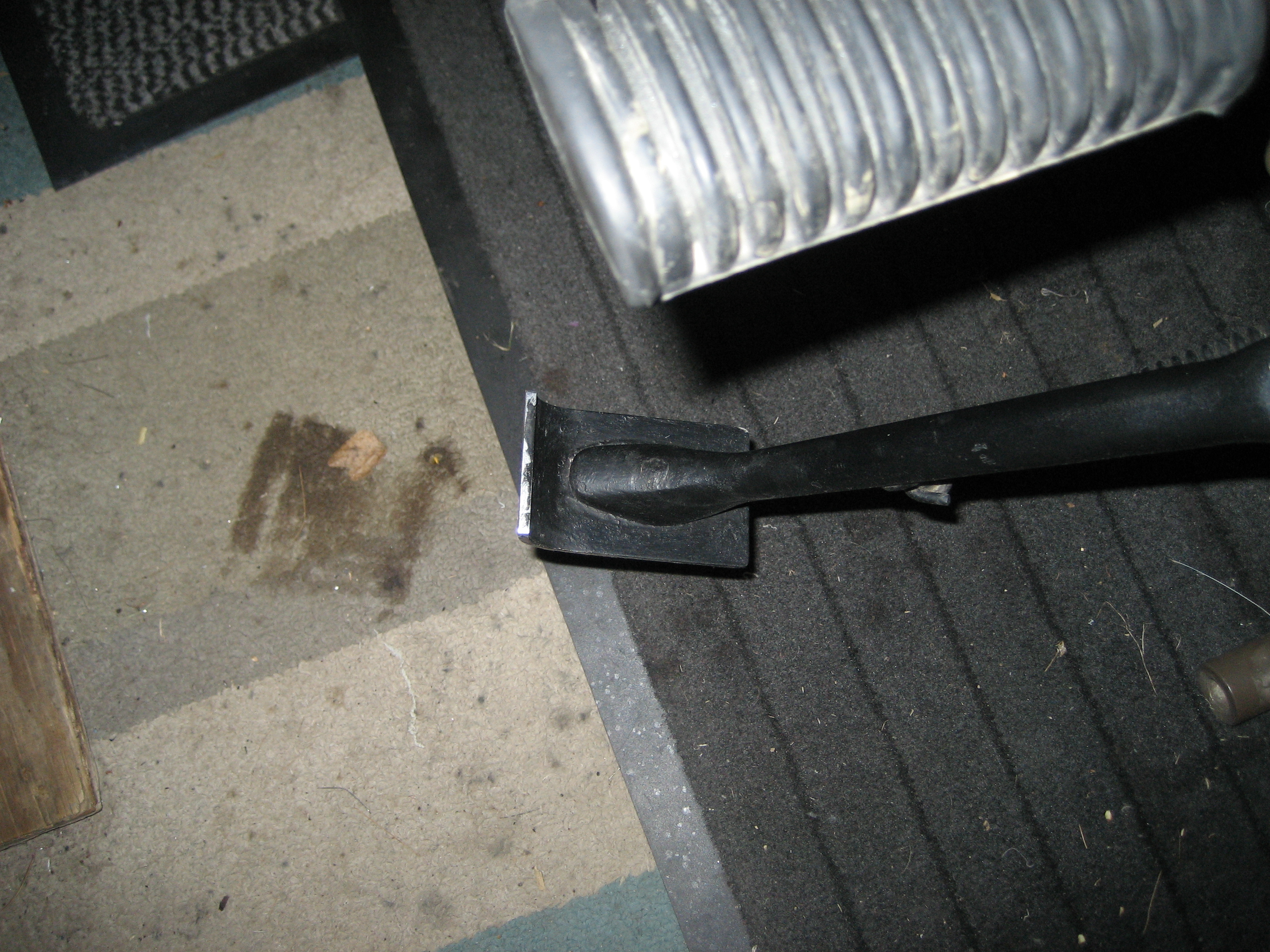

You could also just bolt a "foot" made of alloy plate to the bottom of the stand more permanantly.

I made somewhat similar 10/11 years ago soon after I fitted the sidestand.
Drill hole, tie on length of string, loop to put over bar end. It comes out of my tank bag lowered to near the stand , kiccked into place and lower bike on to the puck.

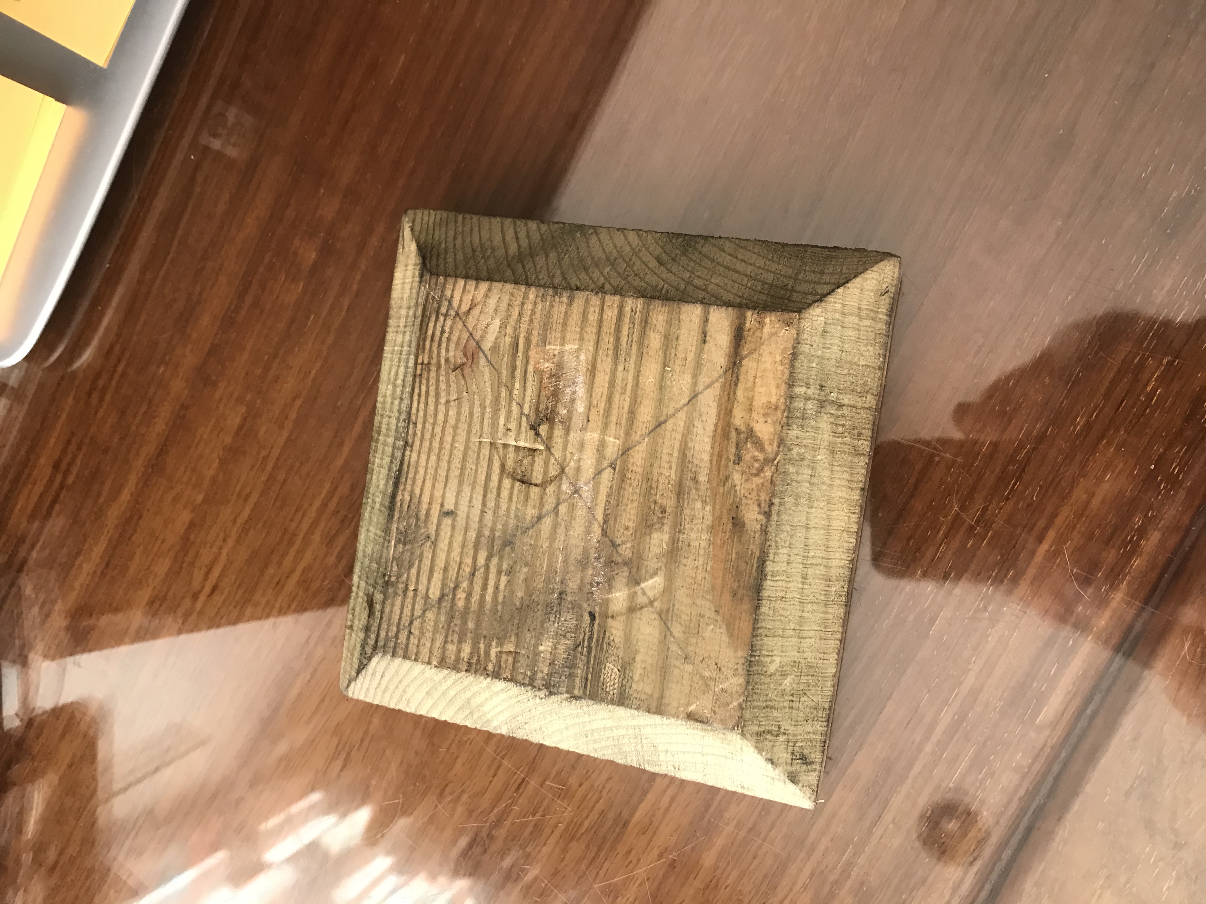

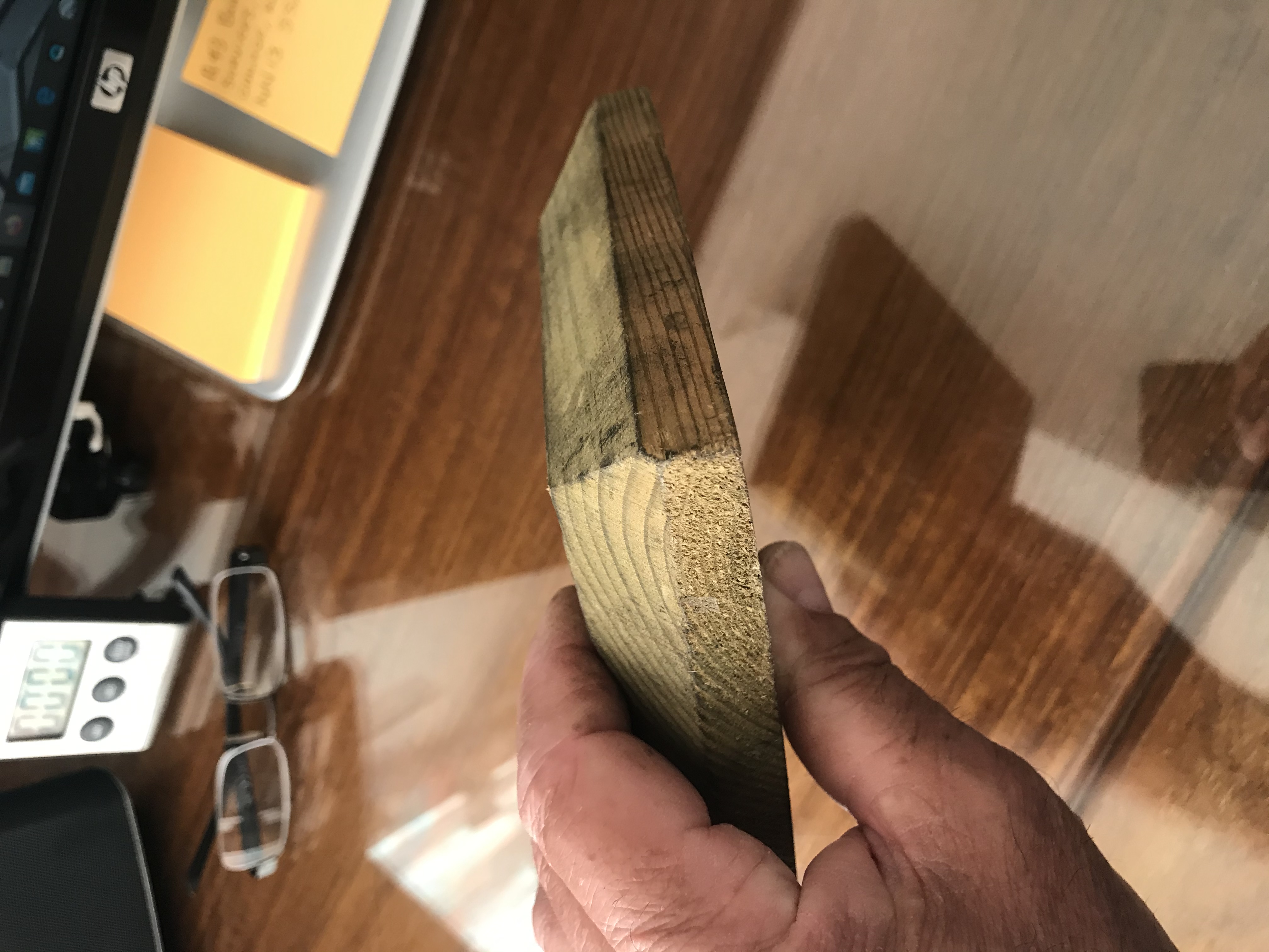

I use a 4” x 4” fence post cap under the sidestand. If you put one under each foot of the centre stand the back wheel can be removed from under the mudguard.

Why not just make a foot plate like this one from a scrap piece of alloy, drill and tap from underneath screw in a couple of M8 bolts and leave the heads proud.
