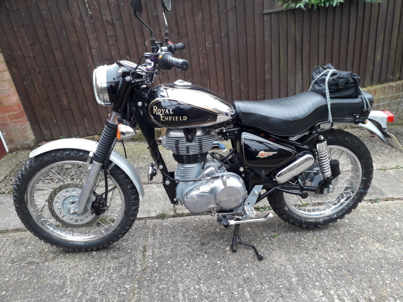

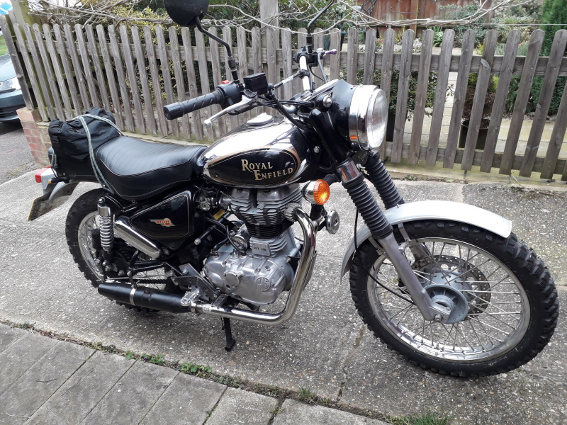

Took the Electra out for a shake-down to see what the fit of fabricated parts was like and what might fall off :(
The new footrest position is more amenable to me than the OEM. Gearchange linkage works ok as does the brake pedal with a reduced length. Clutch lever now replaced with a GPZ500 lever assembly and more comfortable to operate. Rear wiring harness fabricated for the replacement rear lights and the LED indicators; was fortunate to have an old Suzuki loom with a six-way connector. Front LEDs still to be fitted; just waiting on delivery of some two-way connectors from our hosts. Off-road tyres handle great in the dry, predictable when leant over. Mirrors are Honda, which have a rubber mount; I had to fit a left to right hand adapter on one side.
Going back in the garage to cut the surplus metal off various plates and brackets, paint, then refit.

rattonshaw wrote:
Fri Mar 11, 2022 10:53 am
If they're anything like the ones on the bullet, the two triangular engine plates at the top rear of the engine act as a terrible water trap. if you have them off, it's worth grinding/filing a concave on the straight edge that sits up against the engine, then the water can run off.

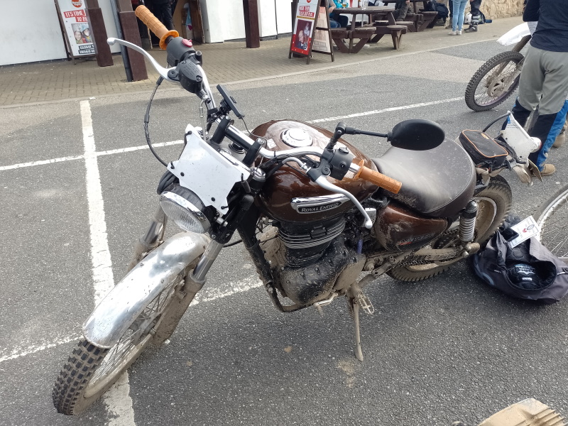

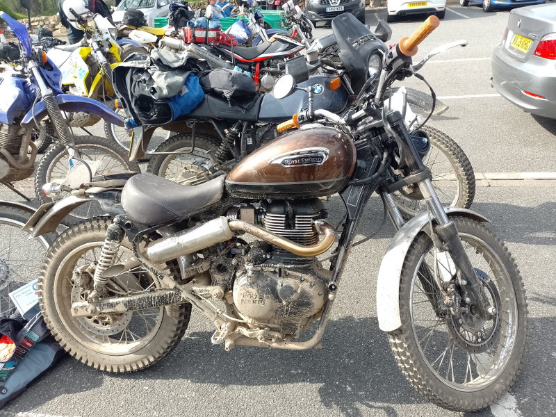

I spent the weekend competing in the Land's End Trial 2022, which is organised by The Motor Cycling Club, though, not on my Royal Enfield. Wandering about at the finish, I spotted this Meteor 350 that had been modified for the event; very impressive. Some obvious modifications such as the exhaust and the 21 inch front wheel.

That was Chris Northover, from Swansea. I had a short conversation with him at the start at Hackmarsh (I was the section chief Marshall). He told me he’d only had the bike for a few weeks, so he’d done well to get it prepared for the trial.
I commented on the exhaust and he told me it was a one-off, made for him by a company in Oxford. A purposeful machine (with the advantage of a lower seat height than the Himalayan) and I think he successfully cleared the hill.
There were three “Northovers”, all travelling together. The other two on Hondas.
If you came through Hackmarsh we might have chatted briefly; I tried to have a few words with everyone where there was time.

Chris certainly did well to complete the bike in a few weeks. It'd be interesting to know what mods, if any, were done to the fuel system as a result of the new silencer. The meteor is presumably a fuel injected, Euro 5 specification.
