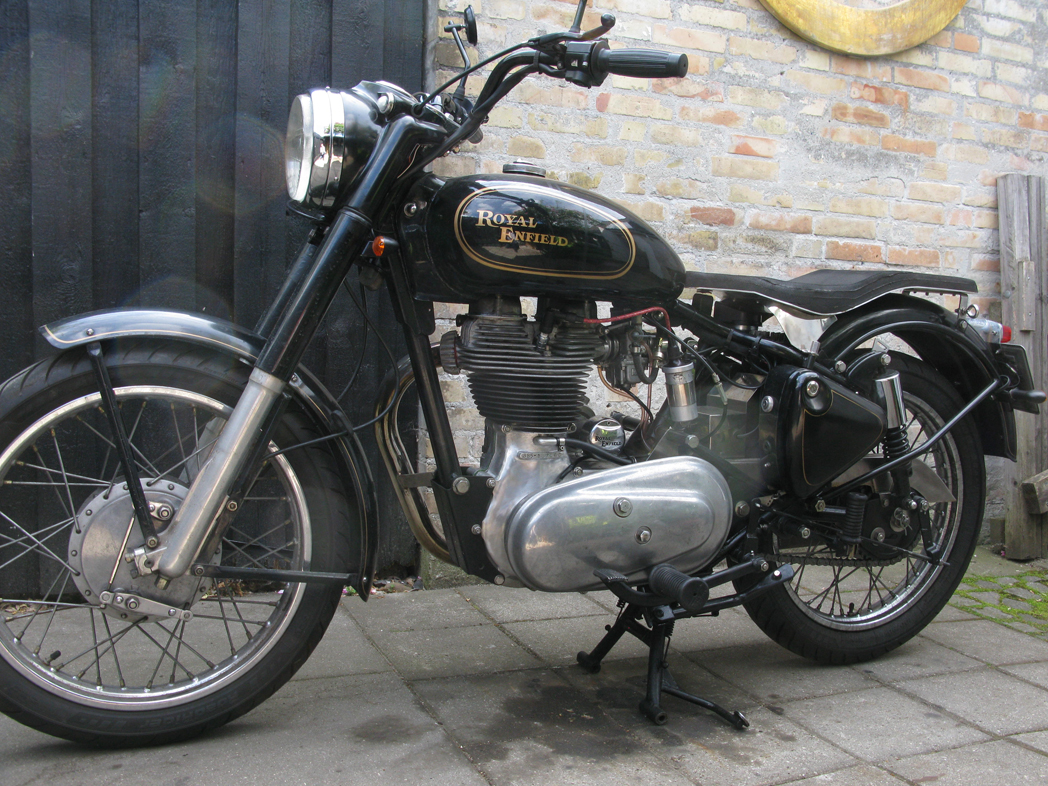

I’m not saying I advocate it, but have a go at building your own.
Assuming your existing wheels are complete for you to photograph, photograph both sides a few times, make any notes you feel you should.
Haven’t done a bullet wheel, so check if some of the spokes are different lengths, different shapes. As you remove the old spokes, lay them in sequence, make a note of how they cross etc.
Once you have all the new spokes laid in place and you try to fit the nipples, this is where it gets Interesting as you knock the rim whilst moving it carefully

Going back to the question. Personally due to riding all year round, stainless spokes and either stainless or alloy rim.
