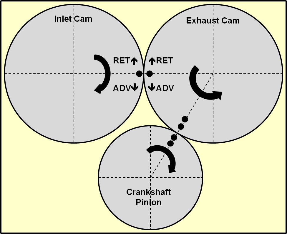

Slappy – congratulations on having the courage to attack a 90’s Indian bullet. I also have one, a 1996 and it has given me endless garage time – always out of the wet, so that can’t be bad. Mind you, when it runs, it is a joy.
The manufacturers practice is to set the cams/pinion “on the dots” (image). A more recent common practice is to retard the inlet by one tooth but beware to ensure good clearance between valve and piston – you really should measure this, as follows. Remove head, cover valve area of piston crown with plasticene, replace head, turn over SLOWLY, remove head, measure depression in plasticene and you need 60thou clearance after retarding.
Replace head, etc, seek ~0.8MM BTDC (on pwer stroke) or ~8mm at full advance for points opening. If you can’t get the points to open there, place a bulb/buzzer across the points and with ignition on it, the light should come on or the buzzer buzz.
