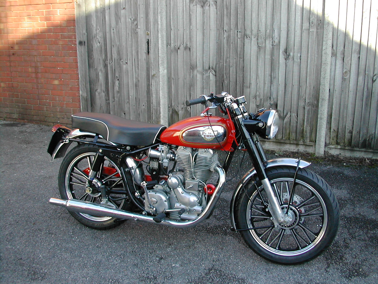

Er, yes! Not A Fury runs Avon AM26s tubeless with these wheels. Indian forks and swinging arm on this bike, so the Indian Bullet alloy wheels slot straight in.
